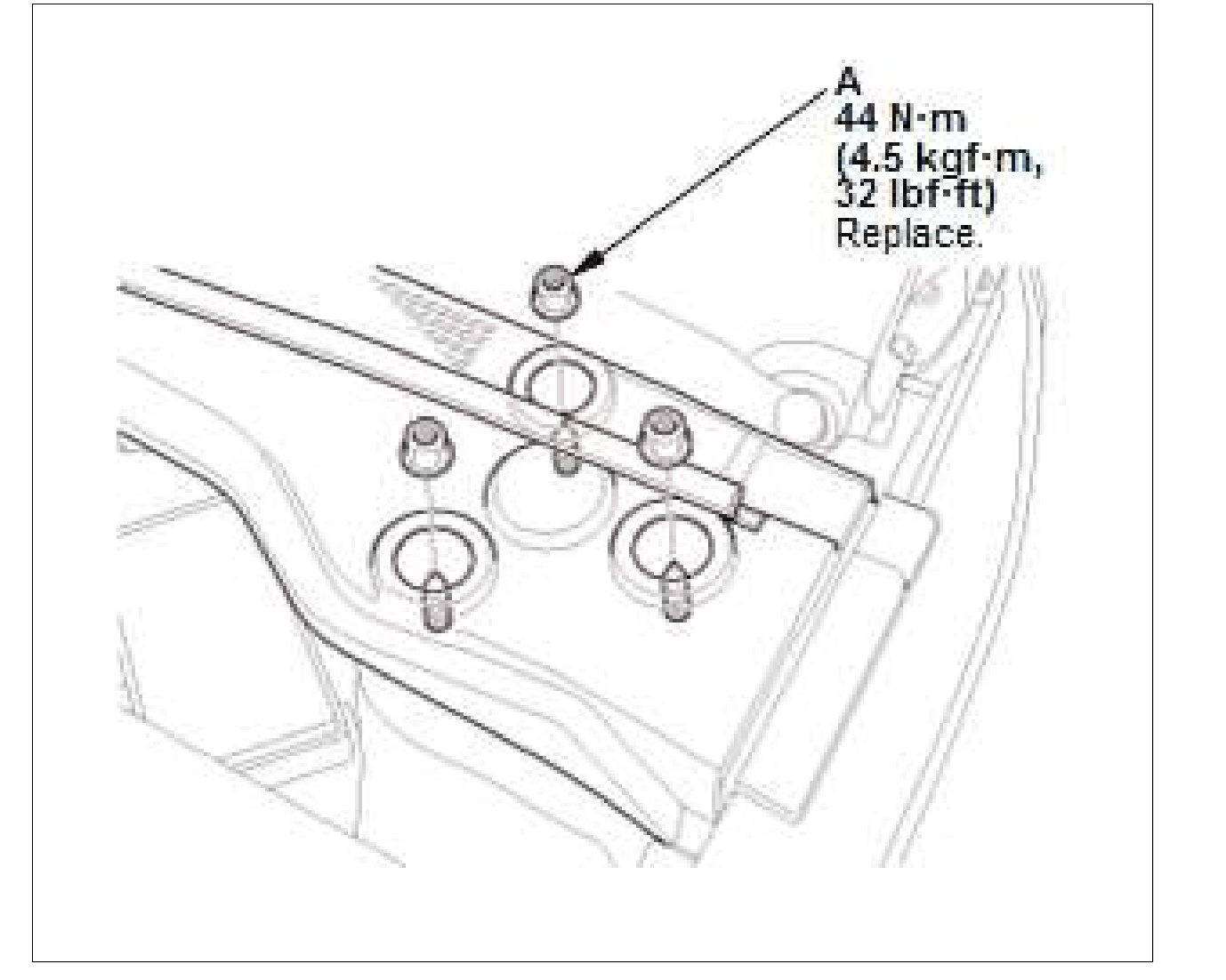

hey all i did my struts on a 2014 acura rdx but wasn't sure of the torque spec, i just tightened them for now but will torque once i can find the correct info
i am mostly looking for the torques for the nuts at the top. the ones that are under the hood under the plastic grommit things. theres 3 small ones that connect to the strut mount i believe they are called flange nuts and then theres a bigger nut in the middle which i believe is the main nut that connects the strut to the hood area etc

I think what you're looking for is in the attached, p.5, Fig. 1.

thank you so very much. sadly it doesnt seem to show the top strut nut that is in the middle. i assume since acura never removes that maybe they don't show a torque for that on this page?

It looks from the drawing as though the center nut is a pre-assembled part of the strut assembly, holding the strut together and the high tension spring under tension. Messing with springs without knowledge and the right tools can maim or kill somebody.

found it!! thanks yall
according to the service manual the main strut nut is torqued at 44 lb foot according to the below attached pic. However KYB says its supposed to be 22 lb foot. not sure who to trust
lastly the 3 nuts to secure the strut mount to the chassis is 32 lb foot
