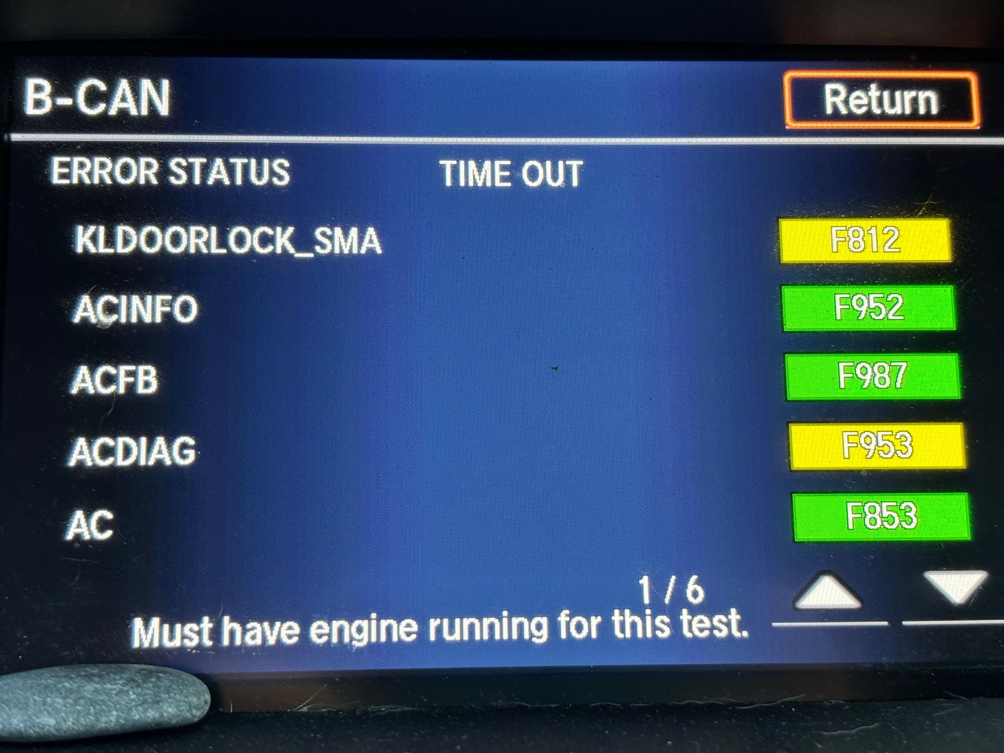

Acdiag f953
Found this with car running: ACDIAG F953.

I found these in another thread -
File Type: pdf
How to Troubleshoot the Climate Control System with ODMD.pdf (389.5 KB, 1303 views)
File Type: pdf
How to Troubleshoot the Climate Control System without ODMD.pdf (
Thanks! I'll run that diagnostic tomorrow and see what I learn.
