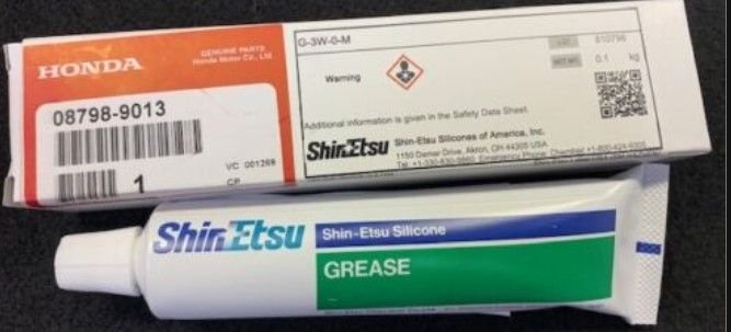

I used to use the spray silicone, until I was told this stuff is better:
It's a little more difficult to apply to the door tracks, being a paste; however, you only do it 'once' and you are done.
My friend was telling me about this stuff, and let me borrow his tube. Used it to grease the shifter where the rod sticks in. Stuff worked great for that. He told me to try it on my door seals as well, but I forgot.
Definitely recommend this stuff. Got get myself some.
