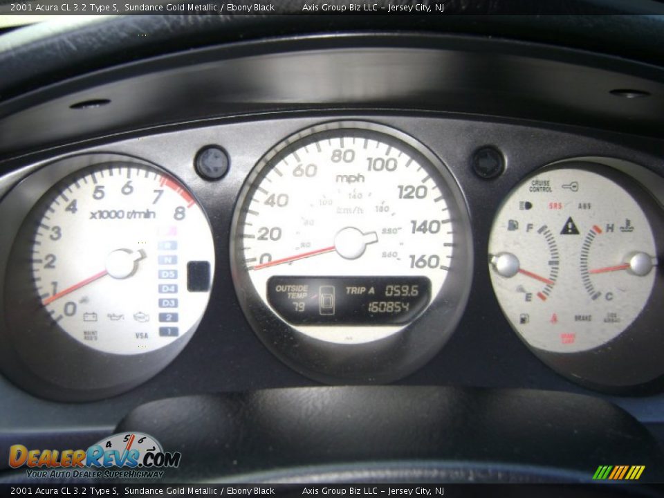

Is this a 1G CL? Gauge cluster is not from a 2G CL
Gen 2, 2002

Originally Posted by alexcls02
Gen 2, 2002
So it doesn't look like this?
Morgan, help?
Morgan, help?
It looks exactly like that, I posted a video example of a guy with a civic with the same problem

Oh, I thought something didn't add up lol reading fail

I was about to post the same thing when I first saw the thread, but I reread the post again.
