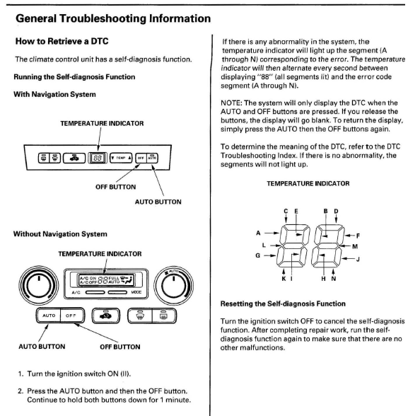

Run the self-diag. function as shown below, maybe it will pinpoint the issue starting at I through M below?

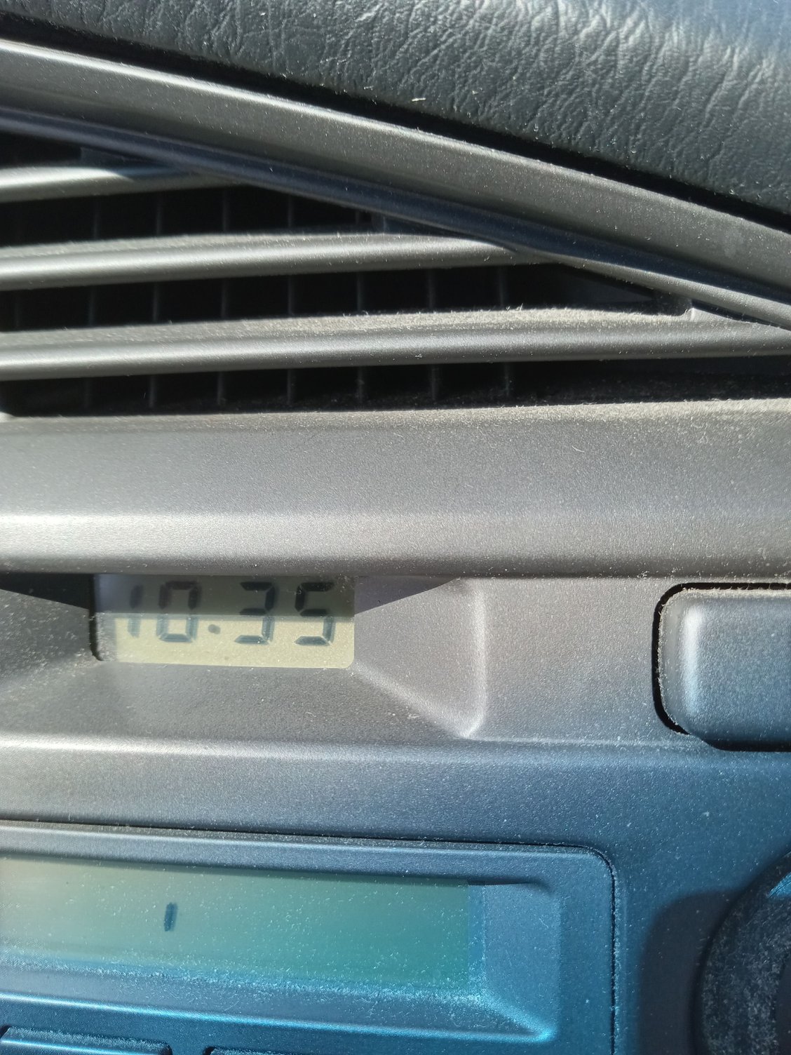

Looks like an “I”. I found what I believe is the proper service manual section. Now I just need to figure out how to perform the testing described.

Good to see that the self diagnosis functionality worked and points you in a direction.
