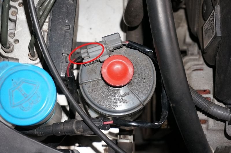

I had the same problem. To diagnose this, find the wire connector (shown in the picture), turn on the headlight wiggle the wire (circled in red). If the headlight turns on and off, this is where the trouble is. Sometimes the wire to the metal sleeve gets loose and you would have intermittent contact. The Acura dealer fixed it free of charge by crimping the wire to the sleeve terminal.

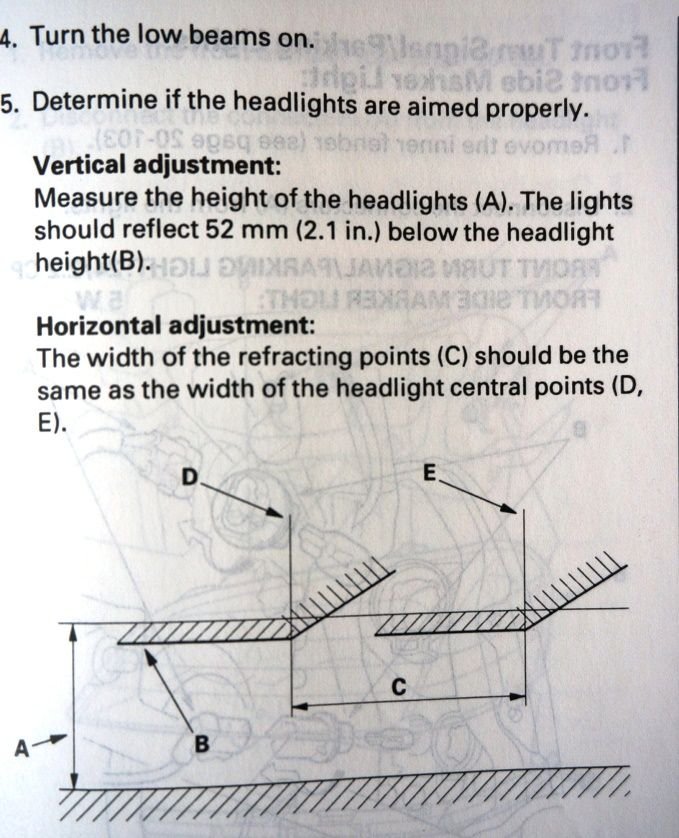

You have to adjust the aiming of your headlight using a Philips screw driver.

Thank you. But what the service manual does not point out is that you obviously have to take the upper black trim piece off. The horizontal adj is right in front of the steel crossmember basically behind the low beam.
