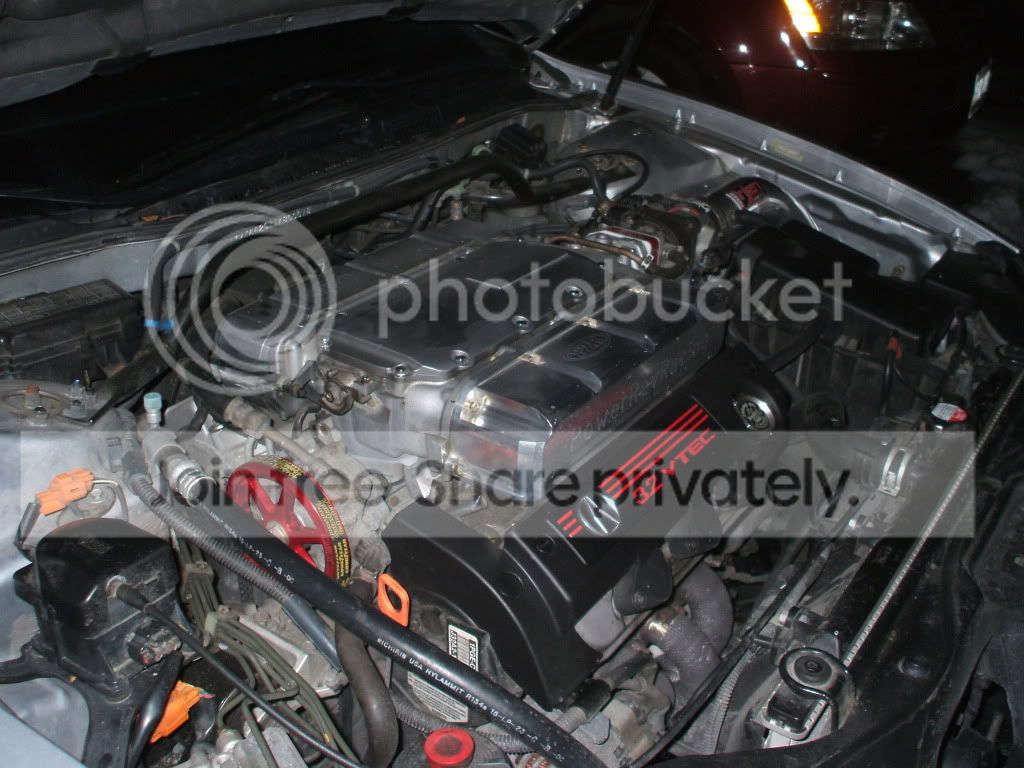

ok so i just put on the OBX pulley for the power steering and drove around.. all was good.
2 hrs later i start the car and i hear a weird noise... pop the hood and it's coming from the power steering pump.
So i think i FUCKED the bearing up??
um wtf can i do to fix that...
please help, the noise is wreched OMFG i cannot stand the noise.
it's somewhat intermittent. if u turn the wheel when car is stopped u can hear it get worse also.
is there a bearing kit I can put on or what?

but u over tightened the belt and just wore the bearings out. i have the same noise for about 6months now. i have a a good ps pump laying in my garage but im lazy and its too cold the work on the car.

ok so i just took the belt off and moved the pulley back and forth to see if i could hear anything.
and i heard little ticking/clicking w/e u wanna call it when i did that.. just moving it 100degrees back and forth.
so I'm gonna get a new power steering pump... well another one i should say.

YEA that's what mine sound like.. a supercharger LOL.
I played with the bearing and there is NO PLAY at all, so i doubt it's the bearing.
and the used one has 220K on it..
I can get a new one for 375 so I am gonna wait it out and then get that new power steering pump when I got some coin to blow.
right now i'll just have to bear with that obnoxious sound.. damnit

first of all progression, what did you use to keep the pulley from turning when you loosened it and then retightened, you may have screwed up the bearing or something there

just saw it , but yeah you proably screwed it up somehow,
it puts a strange sideload that the p/s pump was never designed to handle (one application where an impacts excells, no sideloading)(could have actually also bent the shaft too, and it's letting air into the p/s system, ethier way the p/s pump needs to be repaired/replaced

that might be the vanes themselves inside the pump, hard to tell with out actually being the one to hear and feel it

yea man new pump is getting bought on friday. no waiting around.
And yes I believe I did bent the internal shaft ever so slightly... but that's all it takes unfortunately.

ok so now I drove my car for a 30 mins and it just went away... like the car sounds MINT once again I could NOT believe it!!! wtf??
I have a feeling it's gonna come back when the car is cold. what u think

might have been air in the system but that should have gone away after a few turn of the wheel.

x2, but air should have never even gotten into the system in the first place (cause the system should have never been opened in the first place), but as progression said, probably a good chance once everything gets cold again (as the clearences change again or the seal becomes too hard to seal correctly when cold)
only way to tell is time though, and putting it through normal daily driving routine

it was like that for a week after i loosened the belt then it just stopped and hasn't come back for a couple days hopefully it stays quiet

It was probably just the belt.

So i finally got my camera to work.. snapped a quick shot at night. motor is not clean by any means... but u get the pic.

the rust :shiver: (like on the shock's rod)

the rod that goes up and down inside the body of the shock (aka at the center of the shock towers)

even the bolt that holds the fusebox to the stock strutbrace also looks extremely rusty too

oh no... a corroded 10 year old bolt. I'm doomed lol
I throw a picture up of the entire engine bay and u focus on what appears to be a rusty bolt.
you got ur priorities straight lol
and FYI it's not even rust, it's surface discoloration. not actual corrosion.

When you claim to have the nicest CL engine bay, thats kinda what happens.

nicest is an opinion either way..
i'm sure plenty of you don't agree with me.

ummmmm...... we don't get that here just fyi, bolts still maintian there coating the entire life of the car, so no rusty bolt here (including on a car with 295K miles, still has the origional coating on it's bolts)
