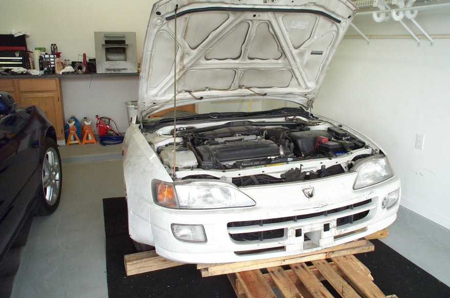

I purchased the front clip from Jarco in Atlanta. (Ever need to have anything imported from Japan and in the SE? Use them, they rock.) The engine has 30,000 miles on it and runs like a champ. Here's what I started with:

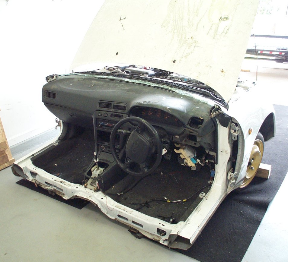

And here's a comparo of the new MR2 engine bay to the old. A lot less complicated huh?

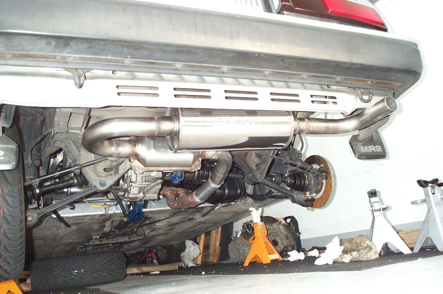

The custom SS exhaust: Bullet muffler, Catco cat. Need to find a tip still, but that can be easily added later.
