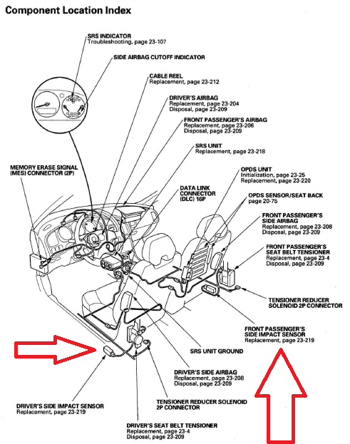

I got a dashboard light warning and was able to get the code 13-2 "internal failure of drivers side impact sensor". Acura dealer says pt.#77970S3MA81
Now I have to find one (cheap, not $175 + shpg quoted by the dealer)
I want to pull the current one to before shopping for a replacement but I don't know where it lives?

Looks like one on each side as shown below.
The link below also shows it as 'discontinued' through that OEM parts website; however, it appears you can pick one up on ebay for cheap.
77970-S3M-A81 Genuine Acura Sensor, Side SRS (acurapartswarehouse.com)
2001 - 2003 Acura CL Side Impact Crash SRS Control Sensor Unit Factory 01 02 OEM for sale online | eBay

Here are the removal instructions. Make sure to disconnect the battery as it states.
Good Luck.

Yikes - "REMOVE THE SEAT ASSEMBLY" - Much more work than I'd hoped for....
I wonder what would happen if I took it out for a few weeks - to make sure I'm ordering the right one - while waiting for a replacement - just the same SRS dashboard warning light?
