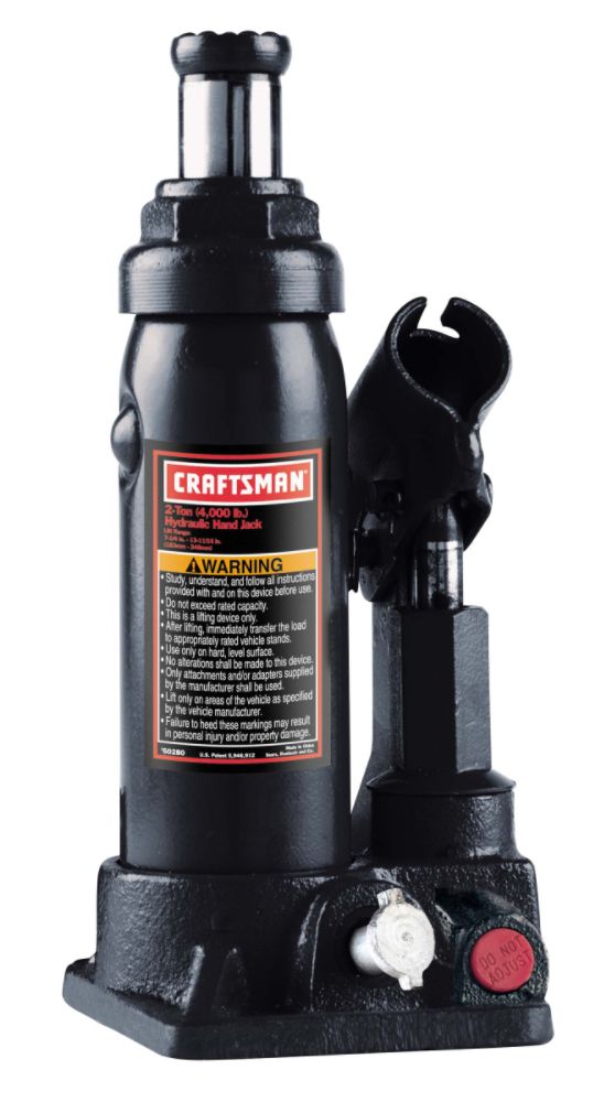

To change engine oil myself, I ordered ramps from Sears. The reasons I wanted to get ramps instead of hydraulic floor jack are: 1.) I don't have a lot of space to store floor jack; 2.) I am not sure if I can raise the frontal side of the car high enough from the jack point stated in the manual (rear center, under the trunk) for oil change.
Then I saw this post, describing one can jack up TSX directly from the frontal section of the car. And I found this hydraulic jack from Sears website (link below). I am wondering can anyone provide some more descriptions on where are the jack points at the frontal section of the car. I know the L-shaped plates where the jack stands should go, but I am not certain where are the locations that I can jack up the car using the jack. Any comments and suggestion on the jack points or the hydraulic jack will be appreciated.

Now, any comment on the hydraulic jack?

Not familiar with the hydraulic jack in the picture in your link. The jack I used when installing my mods was my dad's jack and it was the same style as the blue one in the pics above. I remember that my dad's jack didn't raise the car high enough to slip the jack stands under the sides. I needed to add a 5" piece of wood as a spacer (which is bad practice and I shouldn't have done it). The jack needed should be minimum 2-1/2 ton and which should raise the car at least 17" (this was the minimum for my dad's jack stands and gets the tires off the ground by about 2"-3"). Also need two jack stands. Don't get under the car with only the jack supporting it. Always use jackstands.
Darn, the hydraulic jack (without 'floor' in its name) only goes to 15-3/8 inches (see link). Can you explain why it should be more than 17"? Thanks, mod!!
http://www.sears.com/sr/javasr/produ...id=00950281000
My dad's jack only went up to I think 14-1/2" and I had to add another 5" spacer to get my dad's jack stands to fit. They had about 2" clearance when the jack reached its maximum height. That's why I said 17".
The stands you buy/have might be different. I don't have the jack here anymore, I returned it. My advice is to wait a day or two and see if someone posts about a jack they have that works for them.

Shor review on the jack
I went ahead and bought the hydraulic bottle jack, along with the 2-1/4 ton jack stands (Craftsman) from Sears. I did not want to wait any longer to change the engine oil; I had done so using these new toys. I took a few pictures. I guess I could send them via P.M. for those who want to see.
First, the minimum height of the bottle jack is more than the ground clearance of TSX. So in order to place the bottle jack under the car, I had to raise the car with the "spare tire jack" first. Using the bottle jack, I was able to lift the car high enough so the front wheels were about a inch in the air, which gave me enough space to work and apply jack stands to support the car. I was able to raise the car higher, but there was no point. However, I wonder if I could lift the rear wheels above the ground using my bottle jack.
Bottom line: A hydraulic floor jack should be more practical than the bottle jack that I bought, but the bottle jack gets the job done, and is easy to store, which is what I need.
One other point should be mentioned, bottle jacks don't typically have a large jacking point, making the car less stable once you get the wheels off the ground. Jack stands are always necessary if you are going to be under the car for safety. Bottle jacks are great for lifting via the side jack points and storage, but I wouldn't get one for lifting the front. Go with the floor jack and get everything you need.
I agree -- 1.)The contacting area between the bottle jack and the jack point is small and under a lot higher pressure. It is less stable. This is something to think about. 2.) Floor jack is more practical, not more expensive, and gets to do everything one needs.
But I am going to keep my bottle jack, mainly for lifting the car, so I can apply jack stands. I would no way go under the car with the support only from the bottle jack, using no jack stands.

Be very careful with the placement of the bottle jack. The small contact surface puts all the pressure at the center point can potentially punch a hole or put a dent in the sheet metal.
Yes, it for sure is something I would be cautious of. Thanks for all the inputs.
