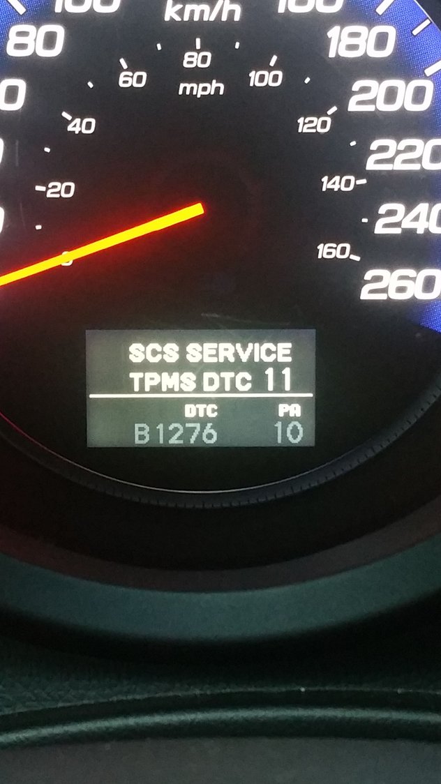

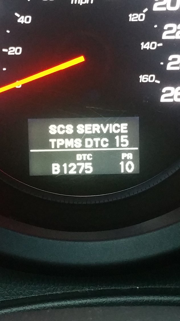

I did the old paper clip in the OBD 9 and 4 to pull the codes.
As for symptoms it was only the check engine and check awd light
I am 100% that it was a B not a P
I'll take some pics just to show
Just for clarity it was
B1275
B1276
scs service
TPMS DTC 11 13 15 17
PA10

Maybe I'm not reading this right?

Here is what I found
B1256
Air Temperature External Sensor Circuit Short To Battery
B1257
Old May 25, 2016 | 09:04 PM
greg1c's Avatar
Joined: May 2016
Posts: 10
B1275
Servo Motor Potentiometer Vent Circuit Short To Ground
B1276
Servo Motor Potentiometer Foot Circuit Failure
