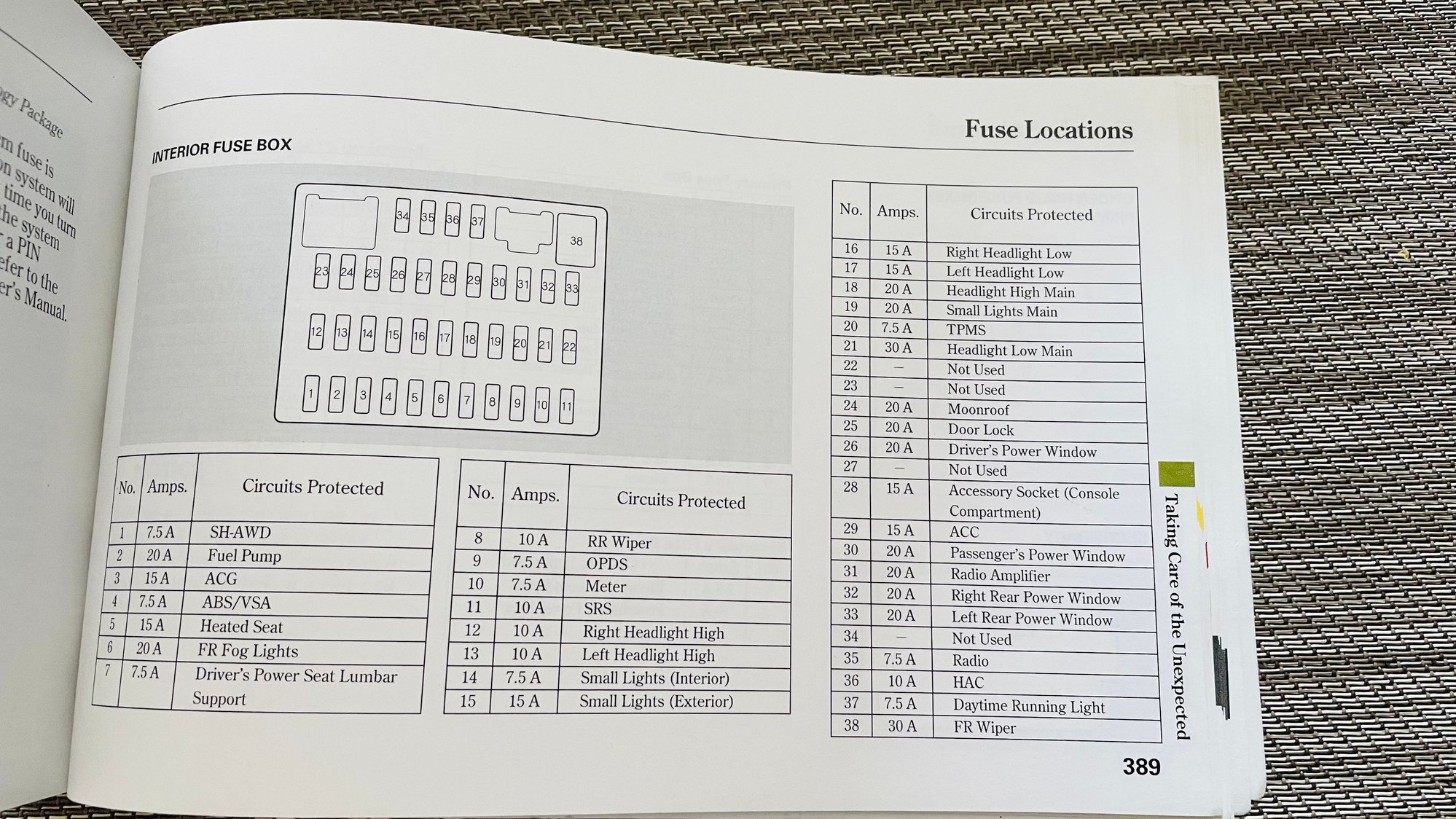

I pulled some of the fuses, primarily some that I did not know what they were for until I got to one that I am going to destroy getting it out. So I stopped there and started googling fuse abbrivations and that particular one HAC which is the blower motor according to google and luckily it still works. Im going to have to get a serious tool for fuse removal of some sort. Im guessing that HAC fuse I am going to have to leave until I get a chance to disconnect the battery and dig it out in pieces.
I keep trying to apply some sort of logic to this issue with the MID ERROR. I get that a fuse could be blown. I am just at a loss for what one it might be. Like if my door locks didn't work at all that would be logical. Door lock fuse blown.

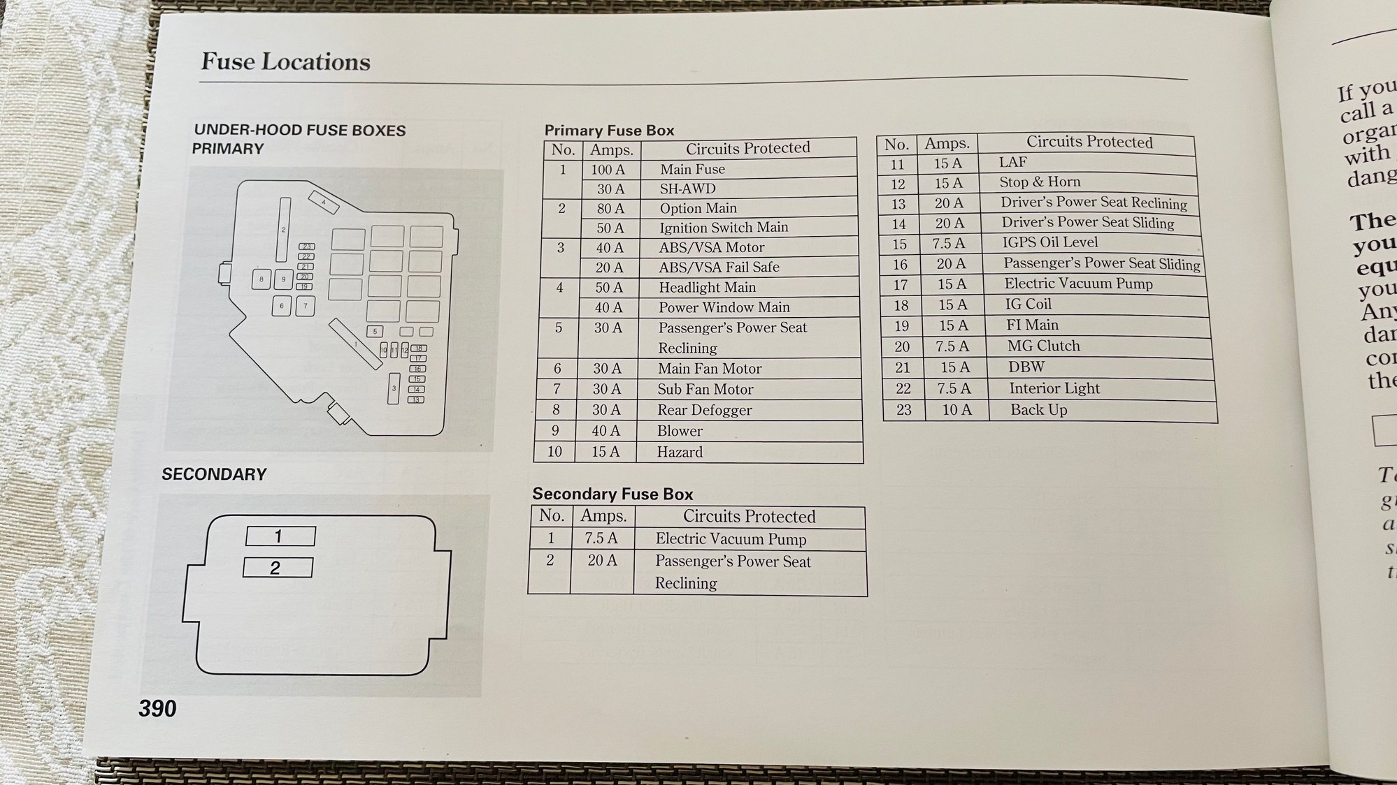

I went out and just replaced the backup fuse. One time I had a fuse not look blown that was no good. So why not. Still didn't work after several tries. I tested all the door locks to see if anything was wonky and nothing. Everything worked fine manually, by the door buttons and also by the key fob. After a lot of screwing around with using both keys I have, I pulled the switchblade keyfob out of the ignition, almost screamed and pressed the lock and unlock button at the same time and just held them down in frustration.
