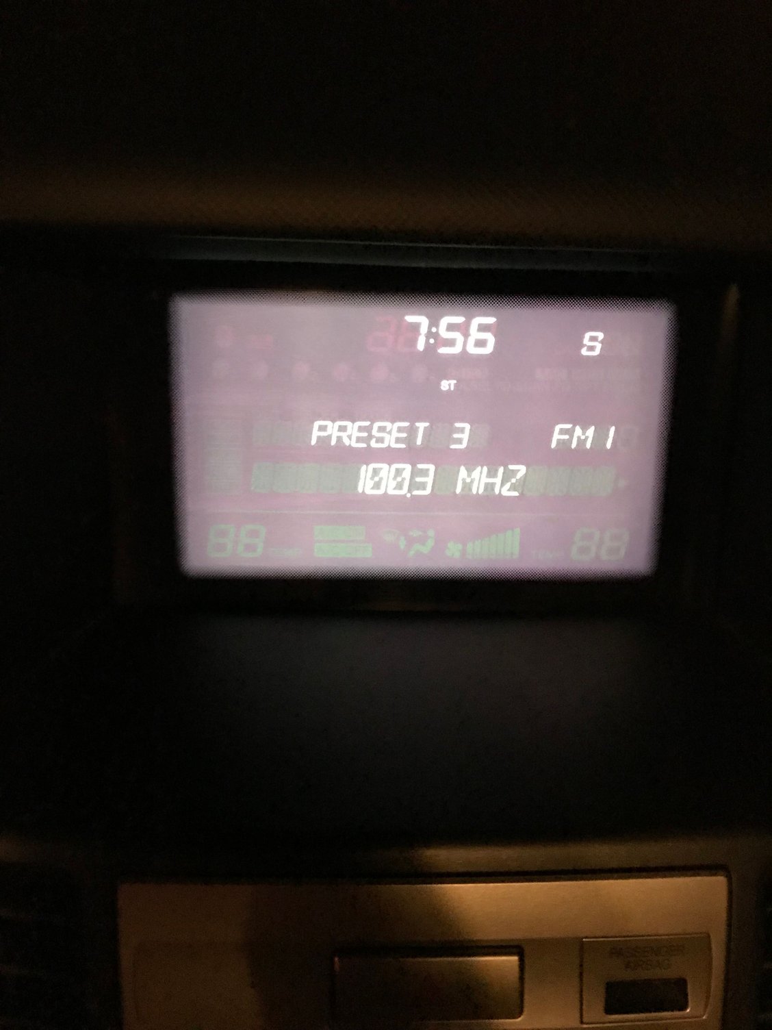

Hello, I know this isn’t pertaining to this post however, this is the most recently active one I could find that was somewhat similar(but not really). I just got a 2010 Acura RDX(Not tech package) and when I lock my doors the beep sound is so low I was wondering if anyone knew how to make it a little louder. Also, currently the car has a rear view mirror back up camera which is a bit small for my comfort and I wanted to know if the Acura dealership would be able to rewire the camera to be projected to my screen where the radio and time appear (see photo) or would I have to get a whole new screen or a whole new camera and screen. Thank you in advance!
