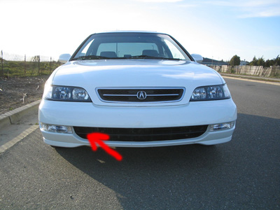

Estimated time: ~20 min
Tools:
Philips head screwdriver
Instructions:
1. Look inside where the arrow is pointing and you should see a phillips screw that holds the signal in. Remove it and then slowly take the signal out. There will be two plugs (turn signal and corner) remove them.
There should be a spring that is attached to the back of the stock housing, transfer it over onto the clears along with the plastic piece that held the screw in. Plug in the turn signal and corner light and reverse the steps and you're done.
