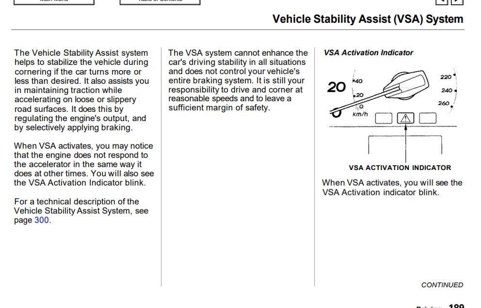

VSA flashing means that the car is momentarily losing traction.
which corroborates with what you've stated; "upon acceleration"
might want to rotate tires, or get new tires all together. as tires will play apart in traction, as an old bald tire will lose traction. no grip.

the flashing of VSA means loss of traction.

Just backing up previous replies. Not all tires screech/squeal when losing traction so maybe you don't hear it but if the light is momentarily flashing upon acceleration from a stop it is in fact losing traction, then the VSA modulator sends a command to the PCM to momentarily reduce engine output until traction is regained.
Sounds like you drive like I do lol. If it's an ongoing annoyance you can make habit of turning the VSA off or if you're good with electrical and really ambitious you can permanently disable it without throwing codes or a malfunction light by depinning a couple of things. Something I've done on my old MDX.
