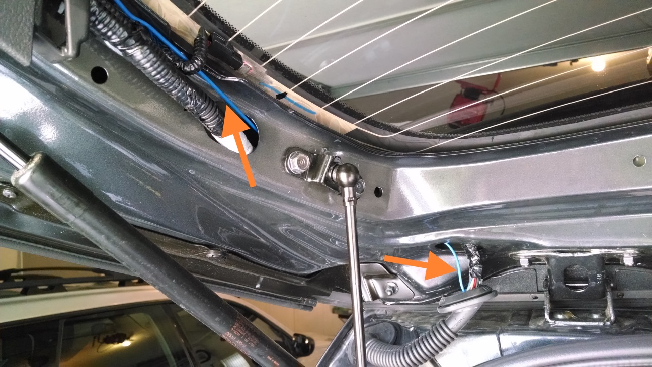

I finally gave up on replacing the backup bulbs and wired a regular driving lamp to come on when my I hit reverse. Significantly more light than the stock backup bulbs, and targeted at the ground like I need it to be...

I have the trailer hitch with harness. I've been looking for light that plugs into the harness and turns on in reverse. Is your system plug/play or required some splicing?

I spliced mine and used a simple relay. 12v power was easy to get from the rear fusebox, but I couldn't locate a reverse wire in the bundle, so I ran a wire up the left side C-pillar and tapped into the driver reverse light.
Here's a shot of the wiring:
