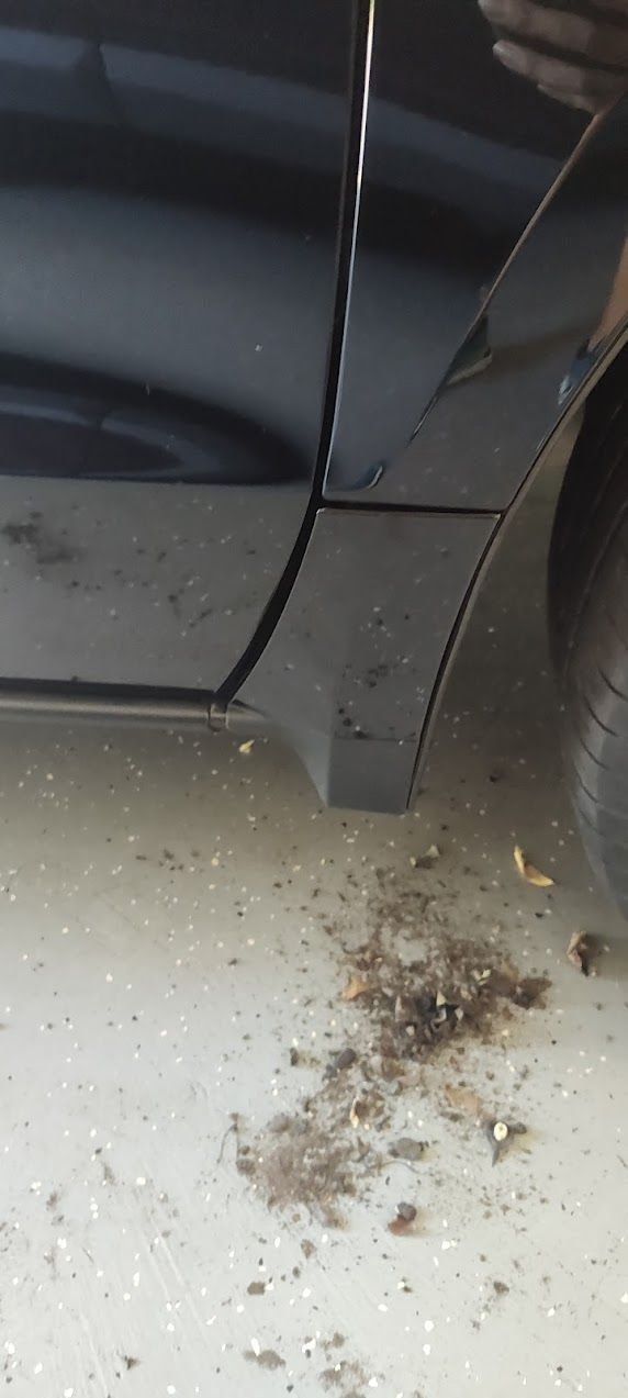

Hello again, thank you zdxsr and thoiboi for your reponses. I added pictures of the damage. I assumed this was the mudguard. Maybe it's called something else?

Ahh, pictures were of MUCH help!
https://www.oemacuraparts.com/v-2012...e-sill-garnish
Should be #1 on this chart I believe.

Hello, I addressed my issue. I used part number 71800-SZN-A00ZC Garnish Assembly, R Front Side Sill *NH731P* (Crystal Black Pearl). Not sure what I hit driving, but on the old part, the plastic broke/split. I provided a photo of the old and new piece. On the old piece, there's a screwdriver pointing to the broken area.
screw driver pointing to broken area
comparison between new part (left) and old (right). Screwdriver pointing to damage.
Old part off. All the dirt and rocks were collected over the years apparently and stuck on the old part.
New part on before cleaning up.
New part on. Cleaned up dirt etc.
