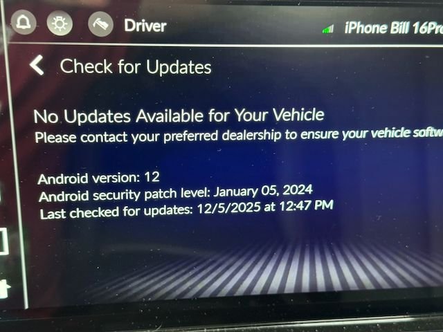

Going to push for updates to my car
Just learned my car is on Android 12, from Jan 5, 2024. This can't be latest.
This is launch spec.
There are three releases so far:
  • Launch spec, SQBR5-180.
  • Second build of Android 12, SQBR5-250/April 2024 security update.
  • The latest is Android 14, UQBM-286/May 2025 security update.

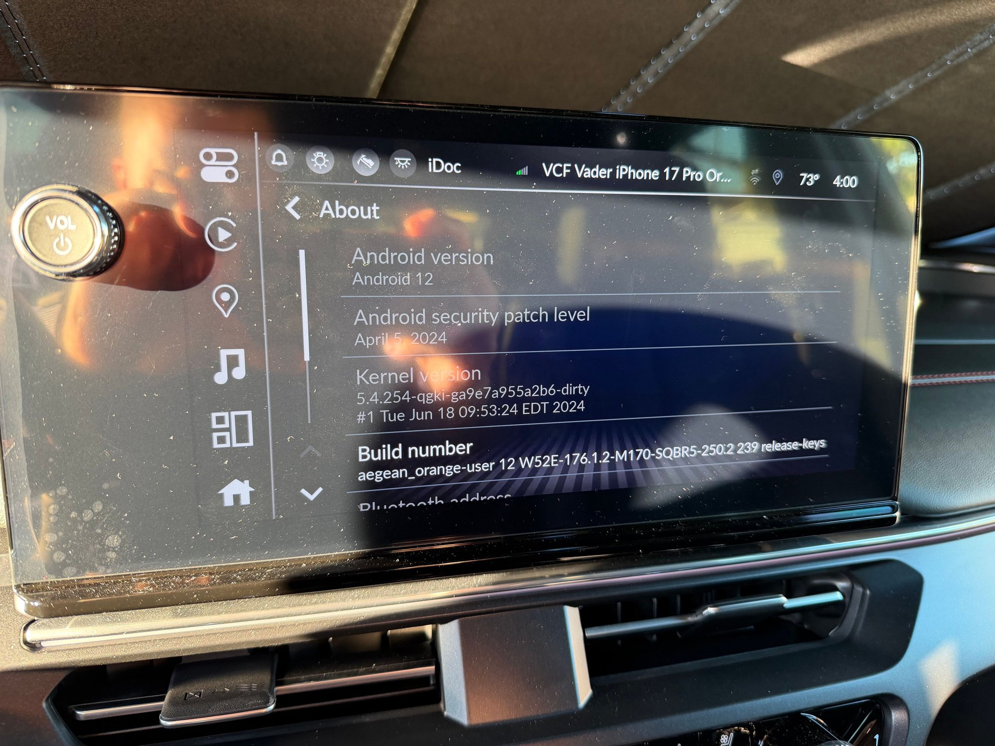

That is considered normal unfortunately, because all these infotainment updates are dealership-applied, not OTA.
I got the second Android 12 release from doing TSB 25-033 at the dealership, then got Android 14 from doing another update myself. You can read more about it here:
https://acurazine.com/forums/zdx-326.../#post17005663
I suspect there is a dependency between releases. In other words, to get Android 14, the infotainment needs to be updated from SQBR5-250.

Guys just FYI, this weekend I witnessed one person bricking the infotianment when he tried DIY update. He has SQBR5-180, the launch infotainment software. It looks like the update path from launch software isn't fully resolved yet. If dealerships refuse to update the infotainment, this is probably the reason.
The symptom he reported sounds familiar. On the first try, the infotainment screen blacked out after the USB update progress bar reached 50-something %, and stuck there for a long time. Subsequent attempts to run USB update only lasted until 57%, then the infotainment said "Update failed, visit dealership".
Old Dec 15, 2025 | 09:04 PM
sonyfever's Avatar
Joined: Oct 2007
Posts: 1,578
Likes: 554
I think the bricking mystery has been solved. It looks like SPS2 downloads Android 14 USB update files, regardless of the infotainment software version. There must be something about SQBR5-180 that clashes with Android 14, so updating from SQBR5-180 is no-go, but updating from SQBR5-250 is fine.
The million-dollar question is then, is it possible to pull SQBR5-250 USB update files from SPS2 server? Probably not, otherwise Honda would not be replacing infotainment modules, but if I learn anything new I would post here.

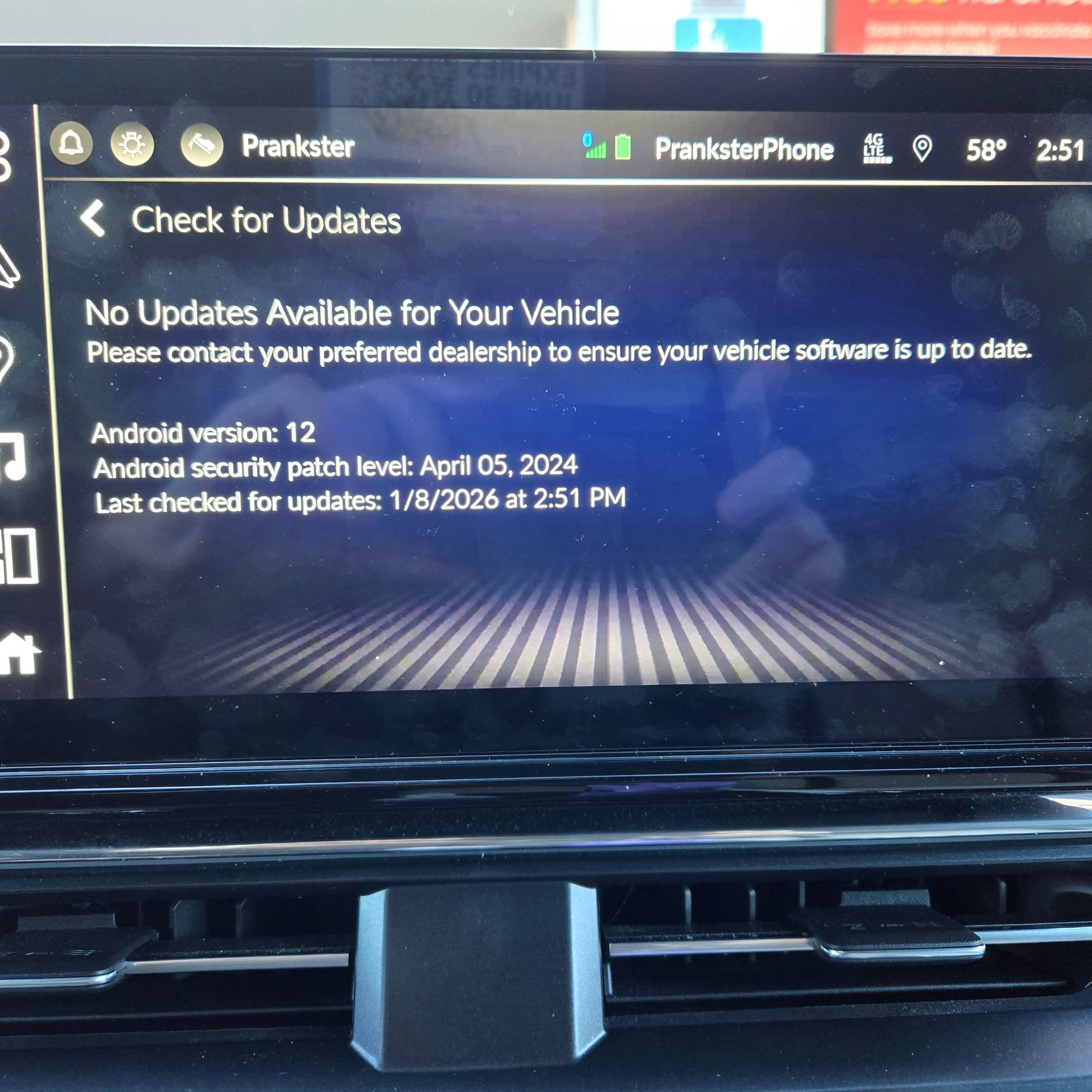

You have to go into the dealership with as much info as possible. Most have been instructed to avoid working on the ZDX altogether. If you find one willing to look into the issues, feel extremely lucky. I've spoken to well over 20+ Acura service managers all across the US and very few are helpful and play the "It's new technology" card to avoid making an attempt at repairs. To me, after releasing the ZDX in 2024, Acura/American Honda had to have the technology in early 2023 at the latest. This standard response is as pathetic as it gets.
For now, I'm working with the Acura of Pleasanton service manager, Mike Sullivan on the bugs/glitches. At least Mike make a concerted effort into situation and dose some research into situation. I'm scheduled for my next visit on Wednesday next week.
So GOOD LUCK on your next adventure with your local Acura dealer!!!!! If you are a Star Wars fan, MAY THE FORCE BE WITH YOU!!!

Try this in the presence of a service advisor or service manager.
Go into Setting>>Vehicle>>Update>>Search for Updates. The responding screen. The screen that appears states to contact your local dealership to ensure your vehicle is up to date.
