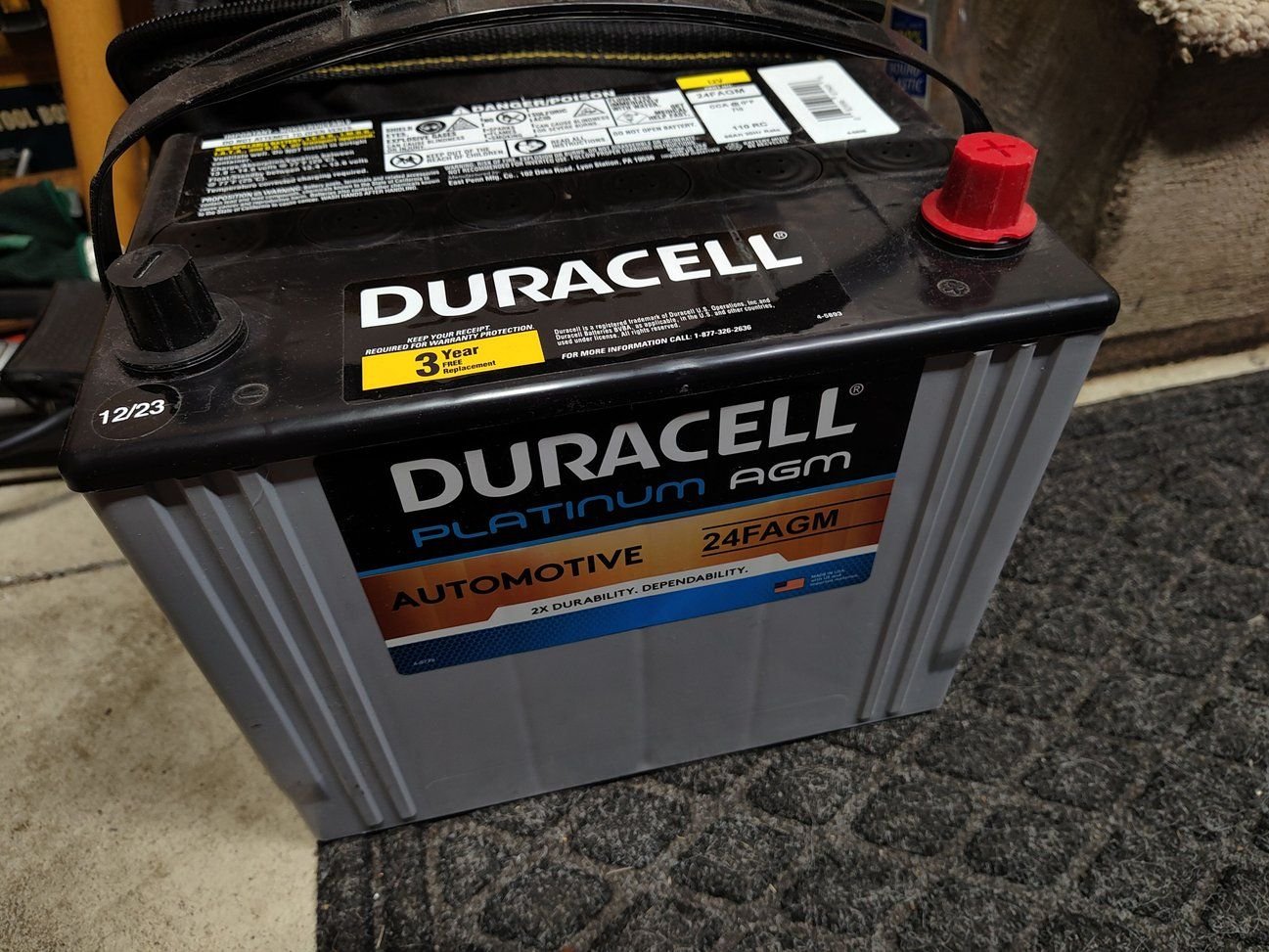

I replaced all of my vehicles' batteries with Duracell AGM in the past 2-5 months.

Was the Duracell a good fit in the ZDX battery box/hold-down, and the power rating recommended by Duracell for that model? I know OPTIMA makes a more powerful battery for its measurement size (the one recommended for the ZDX is undersized), but the next up in power would likely fit ok.

The battery pictured above fit in both the TL and the ZDX exactly the same as the batteries before them. I would've went with an Optima, as well, however Sam's Club had these Duracell ones for $200. Both vehicles start up instantly and voltages are in the 13.8-14.0 range.
