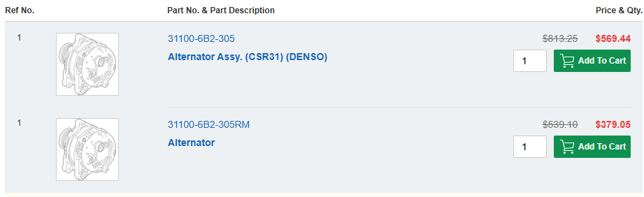

Just an FYI, the below 'red' price, $569.44, is the amount you can purchase a new Denso OEM Alternator online from an Acura parts vendor before shipping/handling/taxes.
The crossed through price, $813.25, displayed would be closer to the stealerships walk-in 'retail' parts department price & most likely what they would charge plus labor of $686.75.
As you can see there is a $243.81 difference just between the retail & online price..

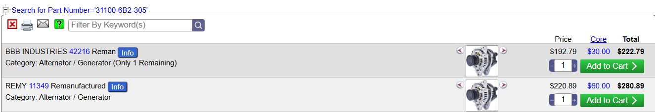

You can also google search the part number and perhaps find a good used alternator instead of buying new or remanufactured?
You can always get an aftermarket replacement from rockauto below & hand it to them to replace while finishing up your rebuild?
Though, I'd get the old alternator, in hand, so that you can get the core charge back.
