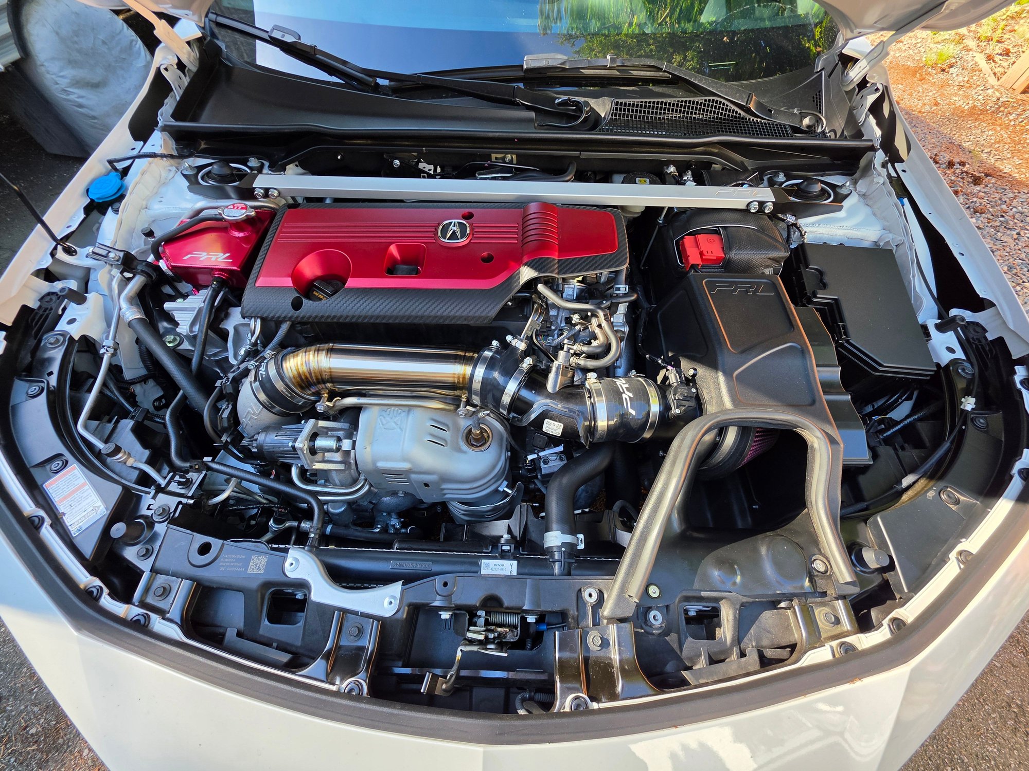

Although I am getting hit by poor exchange rates, I wanted to make some changes before any Tariff changes would hike up prices.
Stock...
Stock...
PRL High Volume Intake
PRL Titanium Turbo Inlet Pipe
I did not want the carbon fibre one, the Titanium looks good - Much better than the stock fake carbon flat looking one!
PRL Throwback Sturt Tower bar
I know there are other strut tower bars, but this one totally looks like the original Teg Type R one = Much better nostalgia and bonus points!
PRL Engine Bay - Shifter Bushings
I will actually say these do make a slight difference, but it is not significant. It only cost me $50 USD = You be the judge to say if it is worth it to you.
What I will say regarding the actual performance gains from these recent mods are nominal, but there is a BIG change in the induction noise from the High Flow intake which you can easily hear a winding up/whizzing sound with the windows down or up. Also, you definitely can hear a blow-off sound from the turbo which was NOT there before! So if you like to hear these sounds, or want to pretend you have a vehicle from the Fast and the Furious, then go for it!
Will I do more, who knows? I think the Teg Type S has a decent amount of power coming out of a fwd vehicle, and doesn't really need more for regular daily driving. But sometimes you just want to add more, because YOU CAN! So who knows if I tune the ECU or add a larger intercooler???

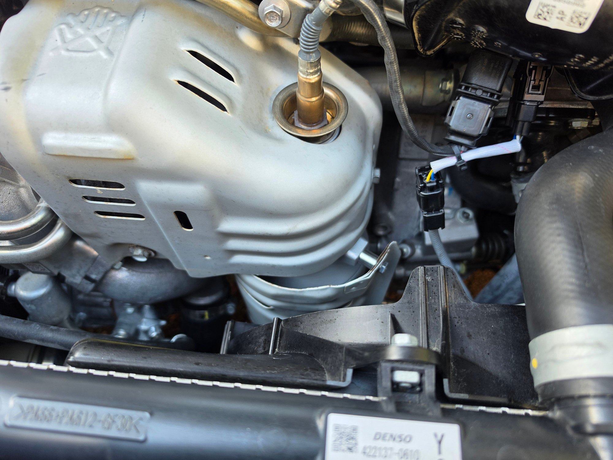

Original stock downpipe installed to turbo

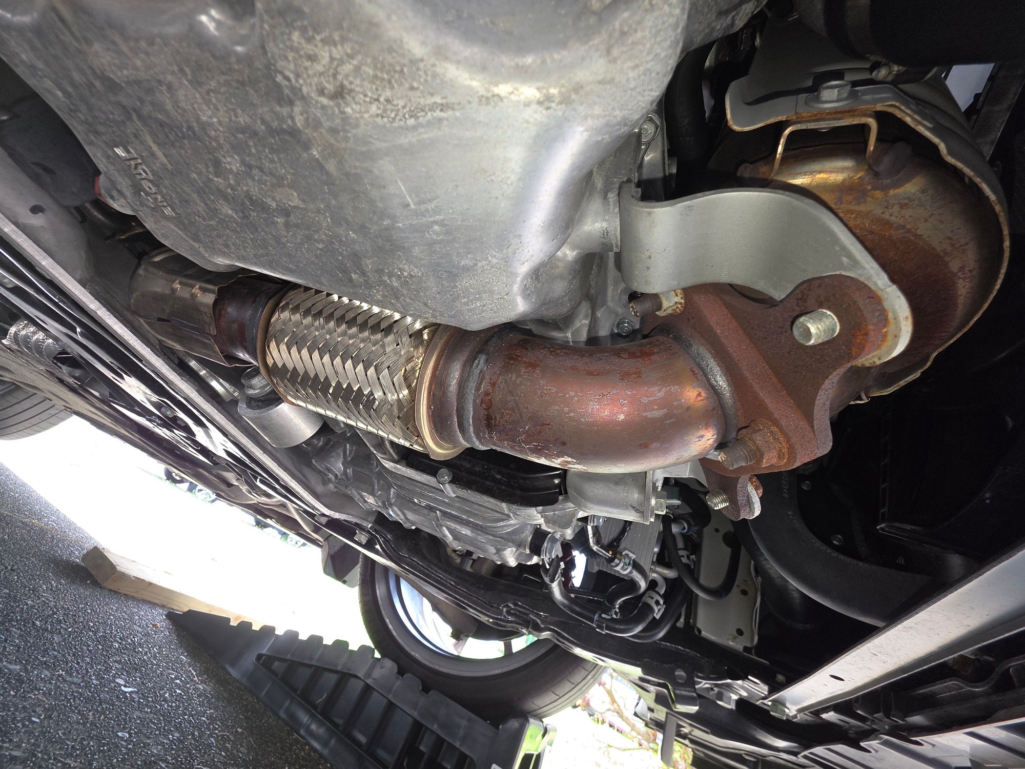

Original front pipe
Original front pipe

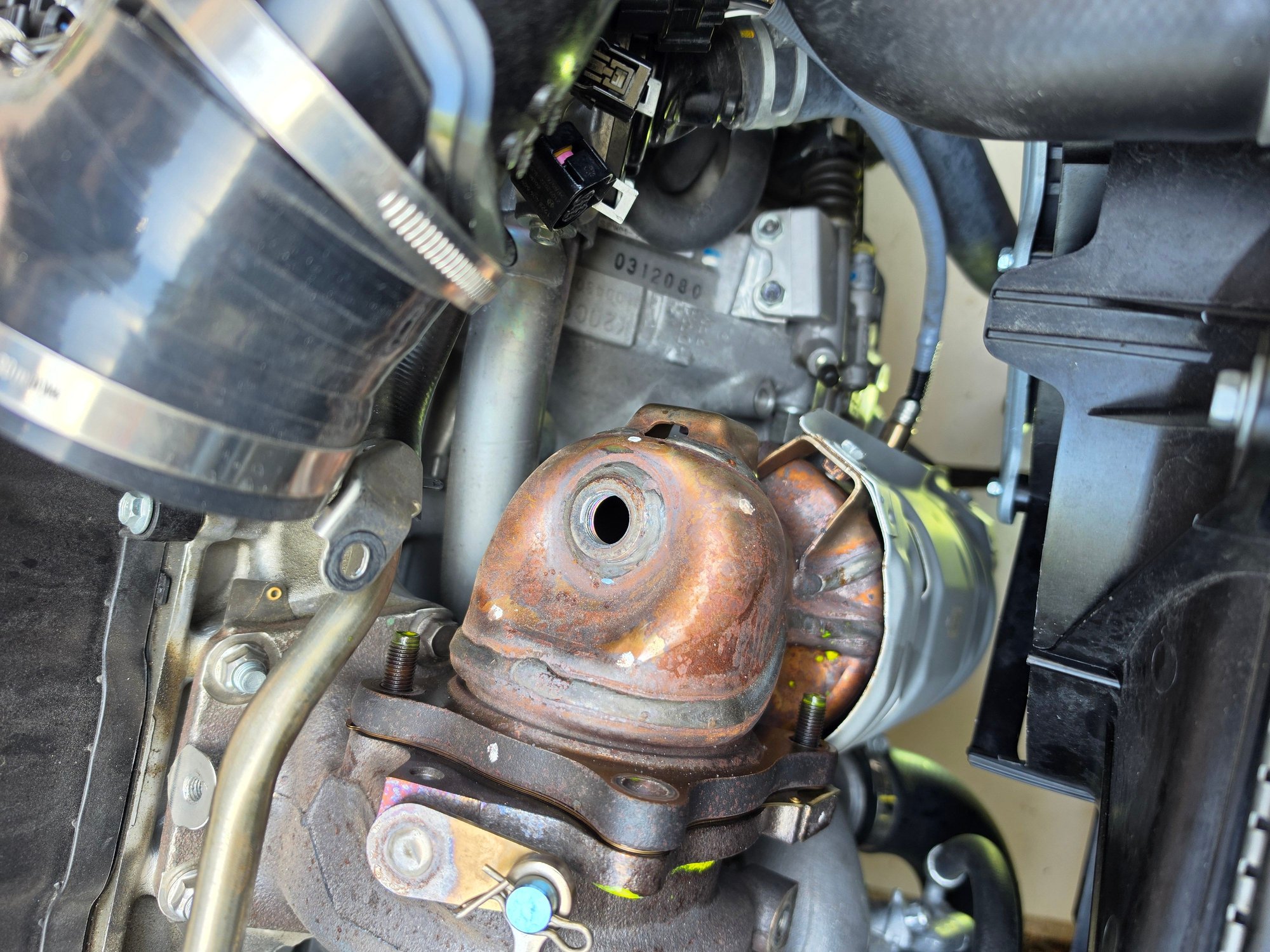

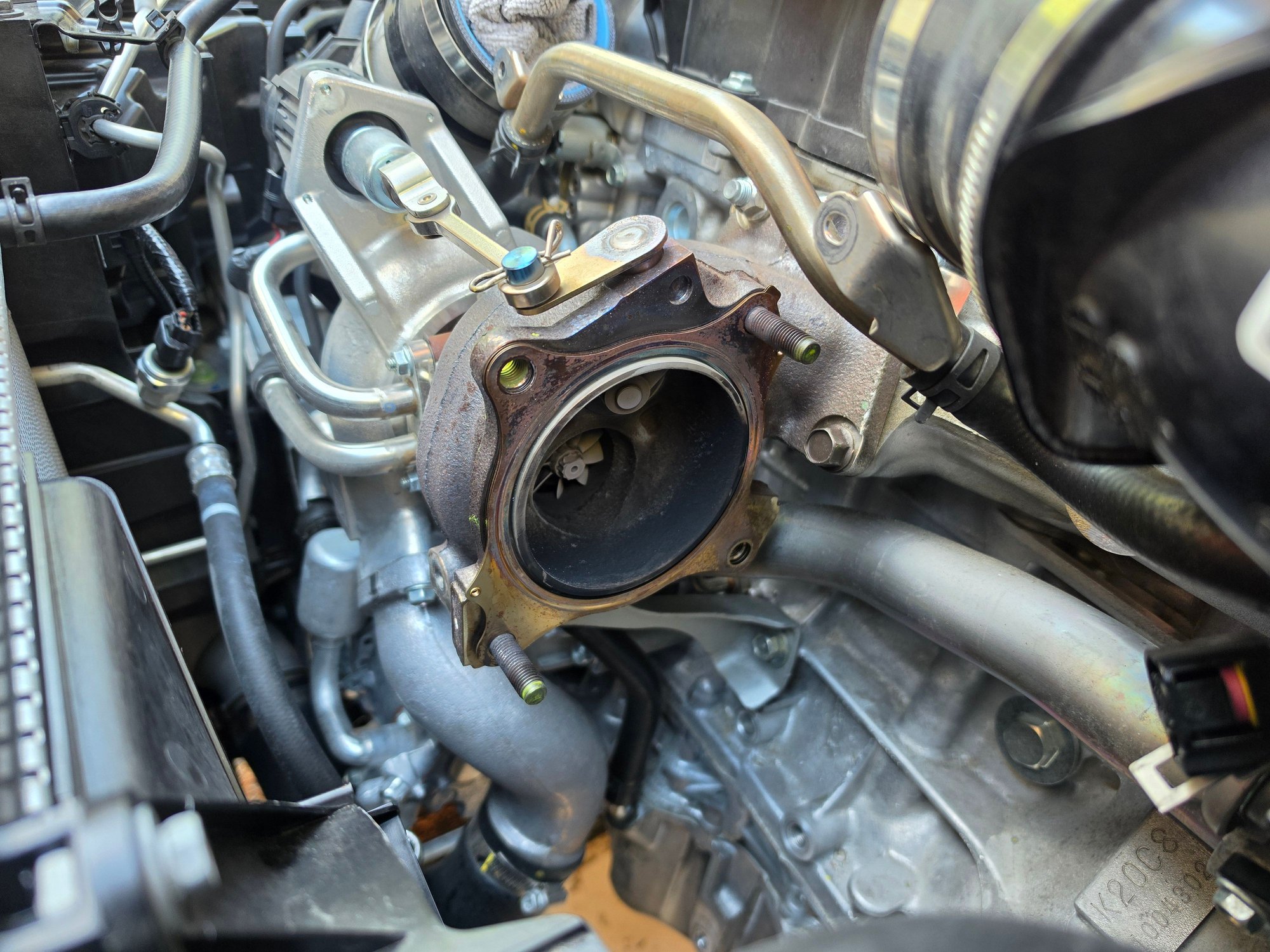

I was a bit nervous on this one as some people have reported having issues taking off the downpipe and breaking the stock bolts. My ITS has around 16,000 kms on the odometer and as you can see the stock parts look a little set in place with plenty of heat cycles and some rust.
Down pipe removed. I was fortunate enough to not have any issues removing the bolts after using lubricant and crayons on the bolt treads.... Phew!

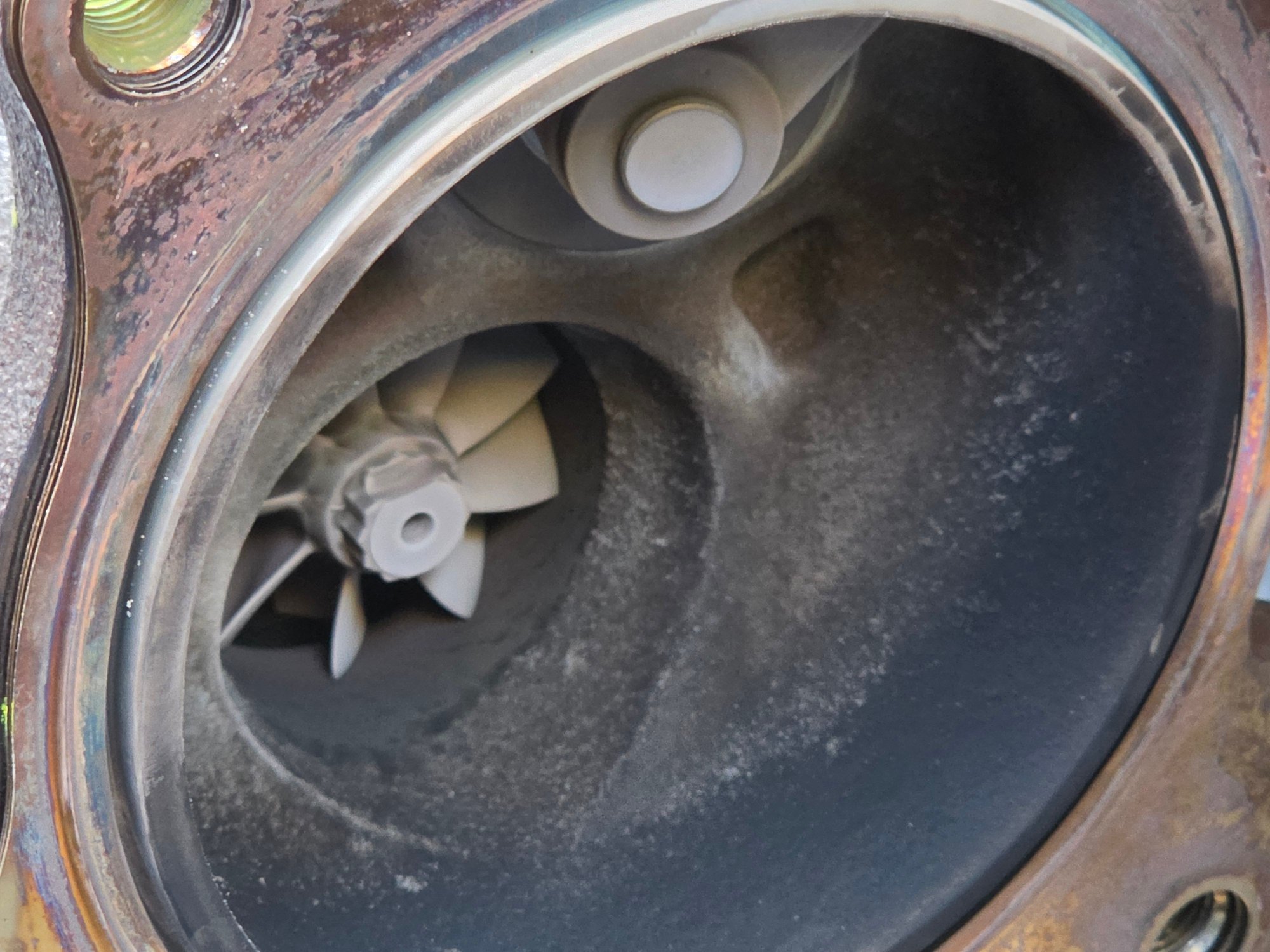

A closer look at the turbo. Interesting to see that much carbon build up for only 16,000 kms

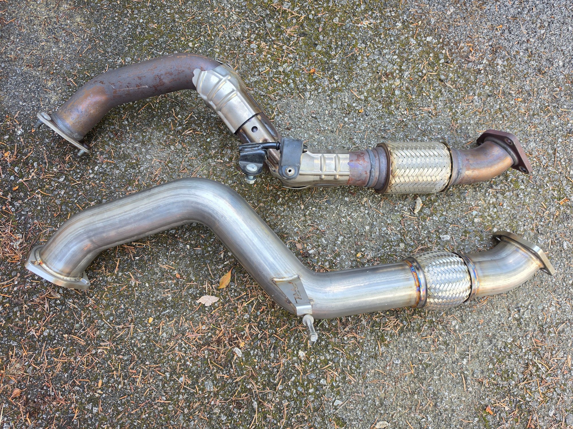

PRL - Front Pipe and stock = Side by side

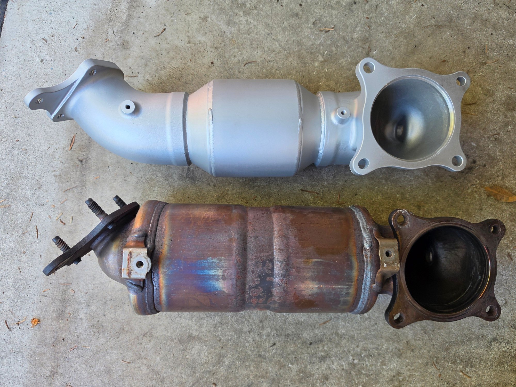

Two Step Performance DP vs Stock

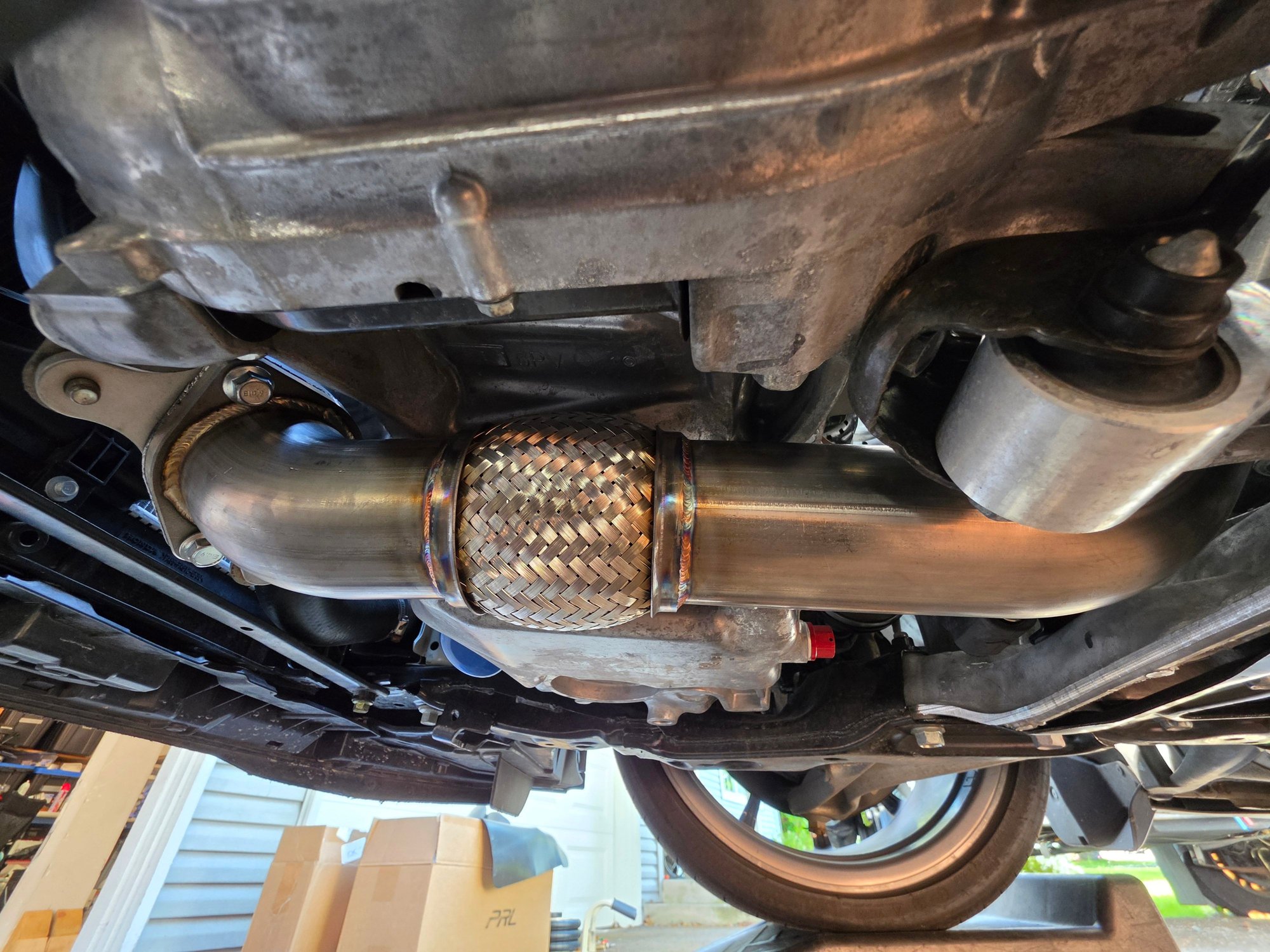

Front pipe installed. Took a bit of snaking it through, but it came out and back in ok.

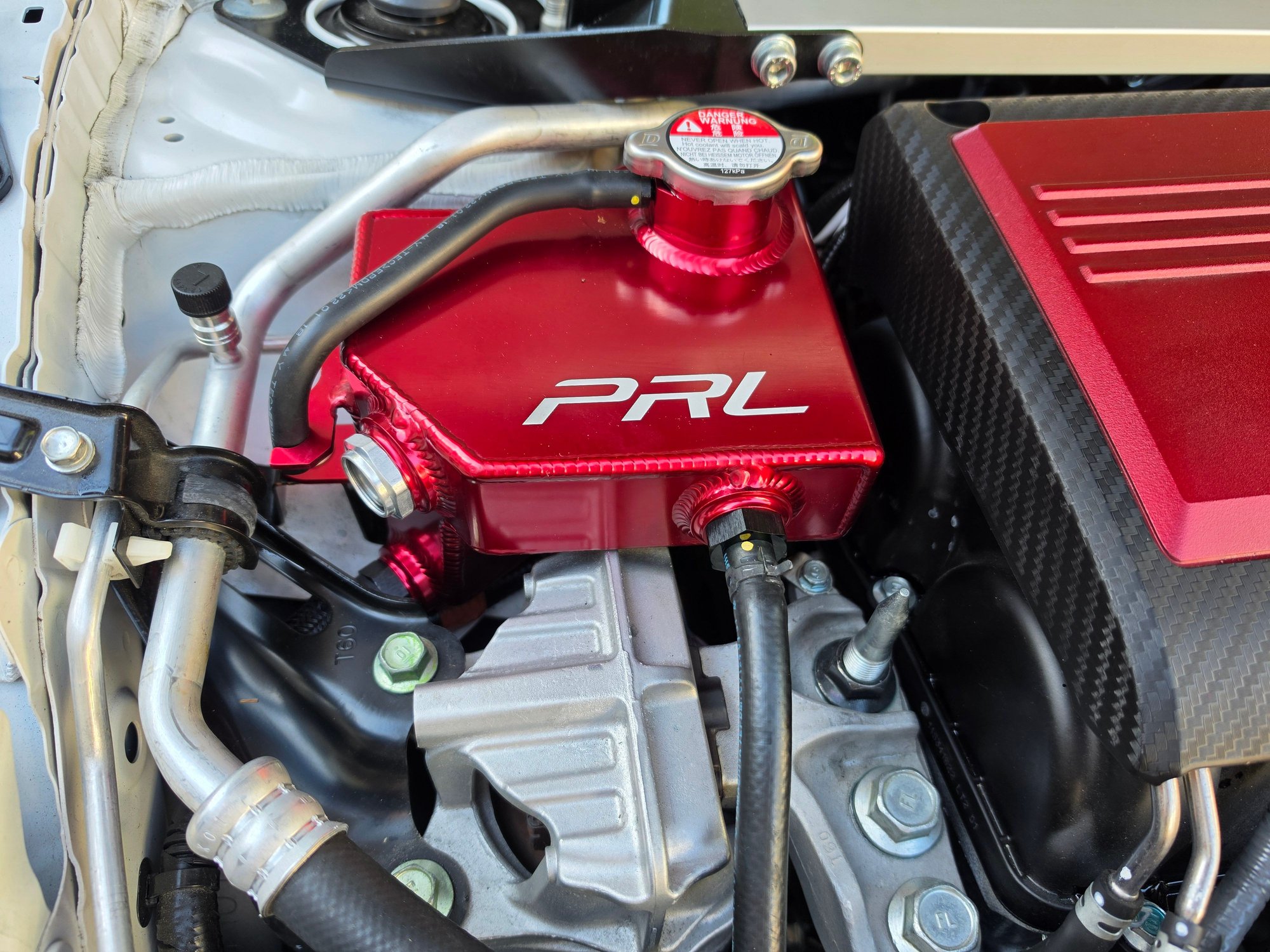

[img alt="Of course I also switched up the coolant expansion tank, of course in red as it is faster!
The stock expansion tank has been known to have issues over time and cracking causing a leak. A pretty easy install, just a little messy with some coolant spillage. "]https://cimg6.ibsrv.net/gimg/acurazine.com-vbulletin/2000x1504/coolant_tank_f6812e5b01a30d58b7b6759a5b94b473823d6 b8b.jpg[/img]
Of course I also switched up the coolant expansion tank, of course in red as it is faster! The stock expansion tank has been known to have issues over time and cracking causing a leak. A pretty easy install, just a little messy with some coolant spillage.

Here is the coolant expansion tank
