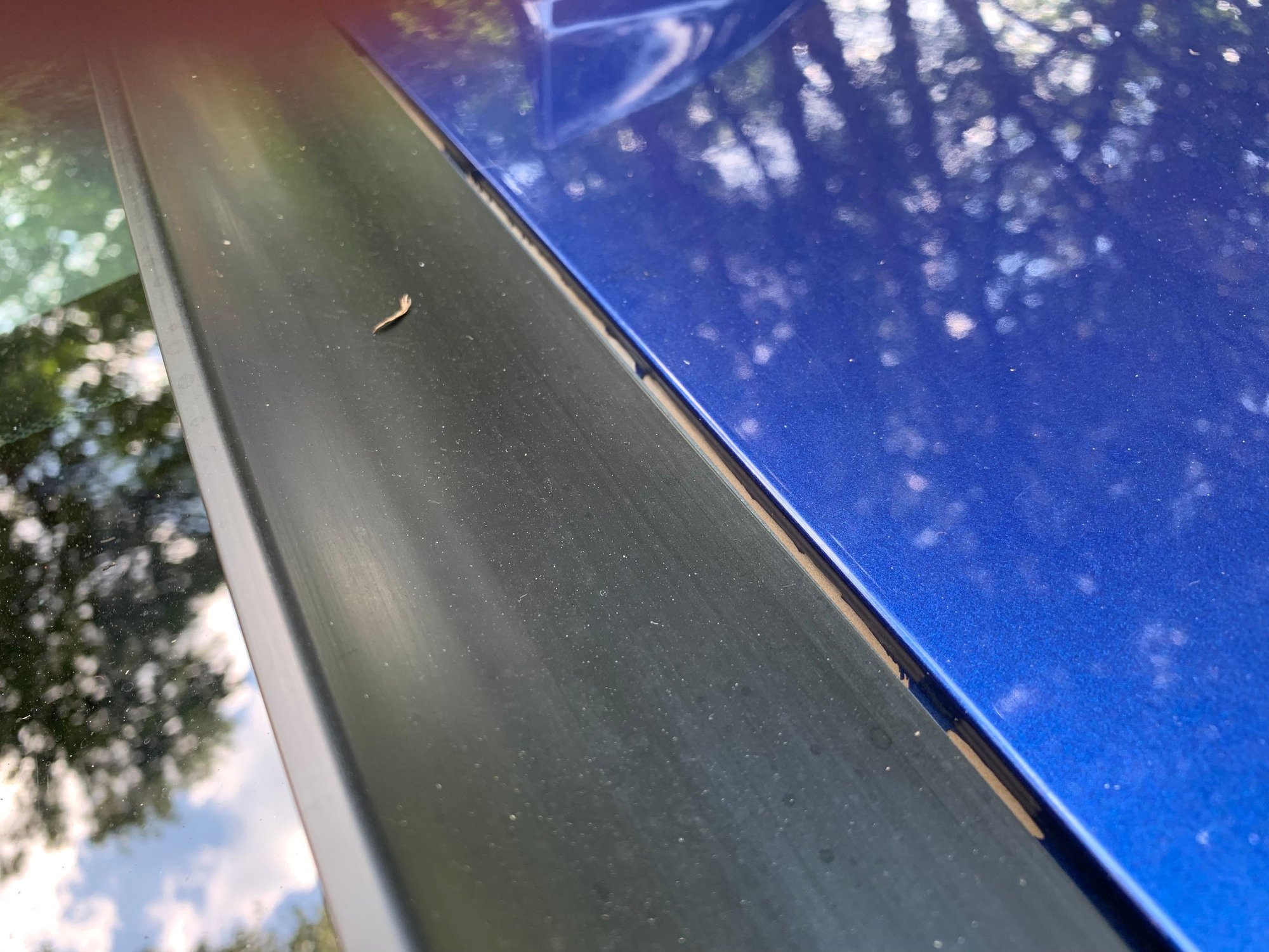

Hey all,
Just want to drop by to complain and give people head up. My 2016 ilx paint is starting peel already, I live in California and I do park it outside but just genuinely surprised to see this with an Acura. There is about 8 inch of paint that's peeling or bubble by the rear window.

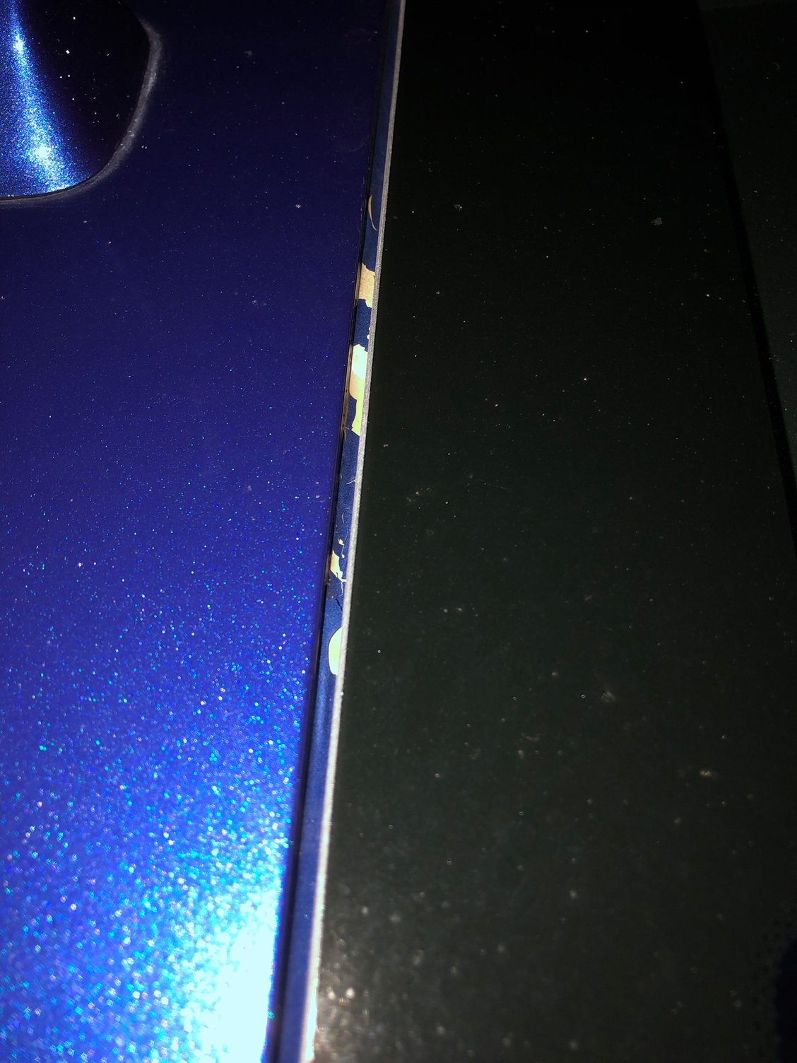

I have same paint flaking off on both a-pillars where the groove meets the windshield. Mine is a 2016 Catalina blue. Add to list of issues. Regretting not getting a civic.

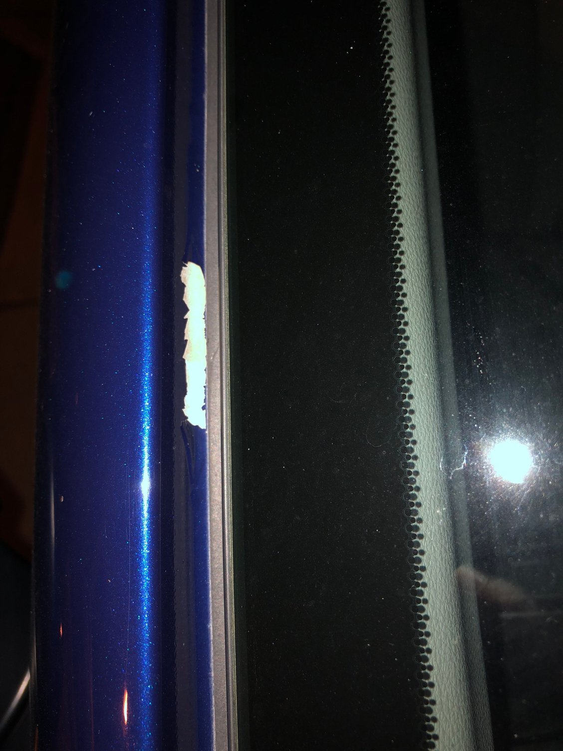

Earlier this year I had my driver side A pillar fixed for this same issue. It was covered under warranty. (We checked both front sides but I can’t remember if we checked the back or not.)
After see see this post I figured I should check again, and sure enough it’s peeling by the rear and also the passenger side A pillar now too.
2016 Catalina Blue Pearl.
Passenger side A pillar.
Top rear window.

I have the same thing happening but on the front, they didn't prep before paint properly, to fix this now is to remove the glass that could introduce more issues in the future, better to just leave it, the primer is still holding so the moisture won't get through to the metal making it rust, so don't worry about that, just looks crappy, but thats Honda QC for yeah. another big fail. Touch up paint won't last long before it just peals off the same
Also it won't peal passed the turn it will stay in the groove, it's just bad prep as it harder for them to do in the tight area, but as i have said many times QC should have seen this before paint

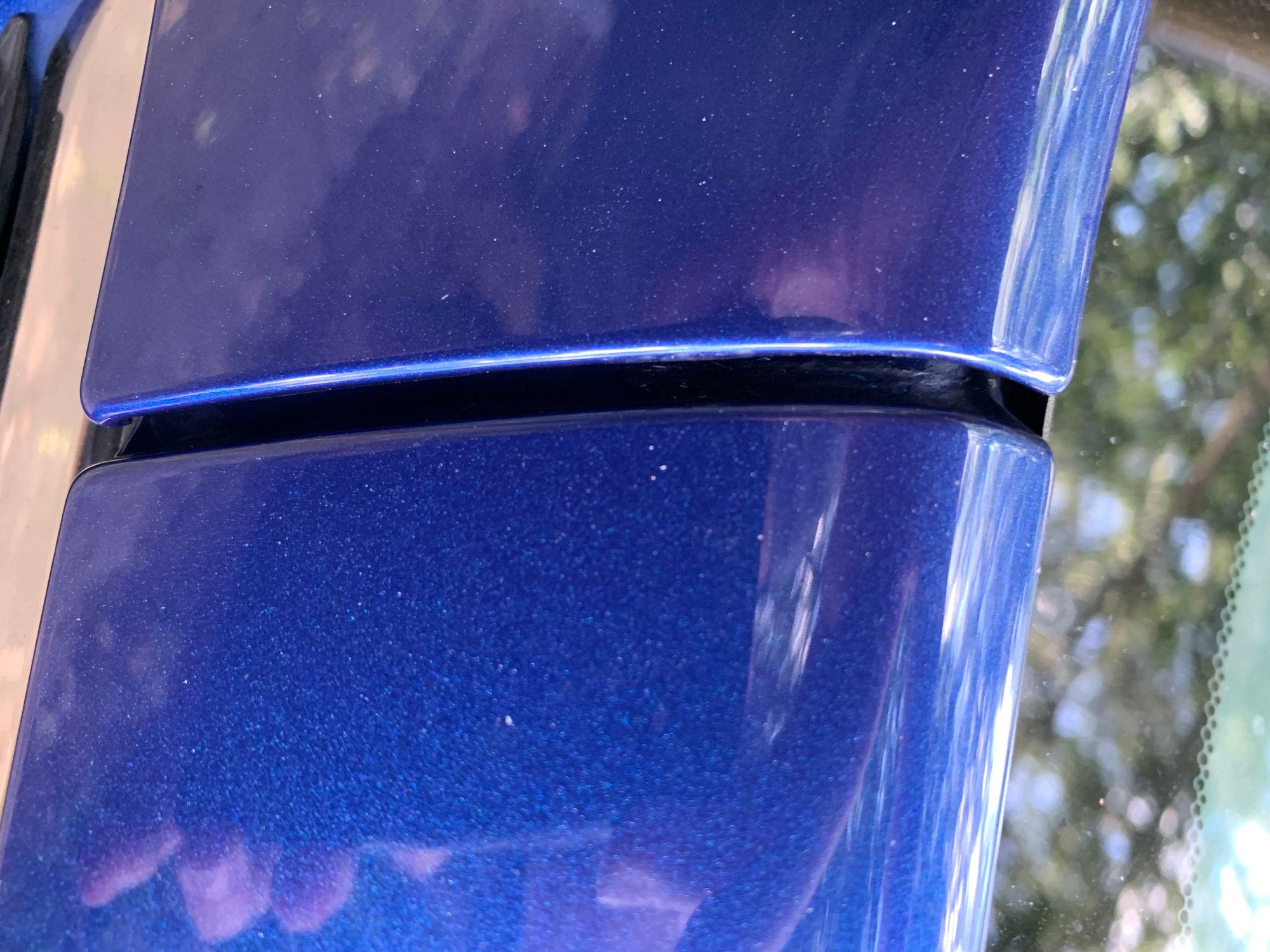

It sucks, but this seems to be very, very common. I bought one Catalina Blue Pearl 2016 ILX from that online car selling company that delivers them. After waiting almost two weeks for delivery and taking the day off to meet the delivery driver, I got a call from the driver telling me the paint is peeling all around the window and "do I still want it". I told him I couldn't make that determination of his vague, but bad sounding description over the phone, so he sent me several photos and they looked not quite as bad, but similar to your photo. I told them that unless they would repair it and give me a lifetime warranty on the repair, that I did not want that car (to which they declined and took the car back). I then bought another 2016 ILX (also blue) from another dealership and made sure there was not peeling (which there was not at the time). However, in the two years since I've owned it there have been 4 different spots that have peeled on this car (three near the front windshield and one near the rear window). Mine have thankfully been rather small and I prepped the area with alcohol and touched up using matching paint bought online. Thankfully they are not the most noticeable areas, so quality isn't highly important, and I'm pretty picky about this type of stuff. The first repairs have lasted over a year now and no signs of additional chipping. Hopefully this isn't a never ending problem with new areas chipping up from time to time, but I think I've been able to repair them myself pretty well.
Hard to see, but this was painted in this seam and has stopped the chipping for some time.
Just noticed there is more chipping than I've seen above my back window after seeing this post! Looks like I have some touch-ups to complete.
