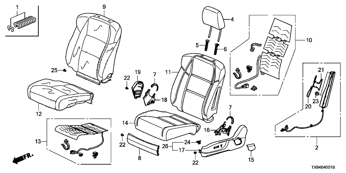

No, the lumbar is not adjustable. Looking at this diagram, it looks like the popping could be coming from the heater. I don't know what material it's made of but when I press the lumbar area in with my hand and hear the pop, the sensation is similar to deforming a thin sheet of metal, and it popping back into place when pressure is released.

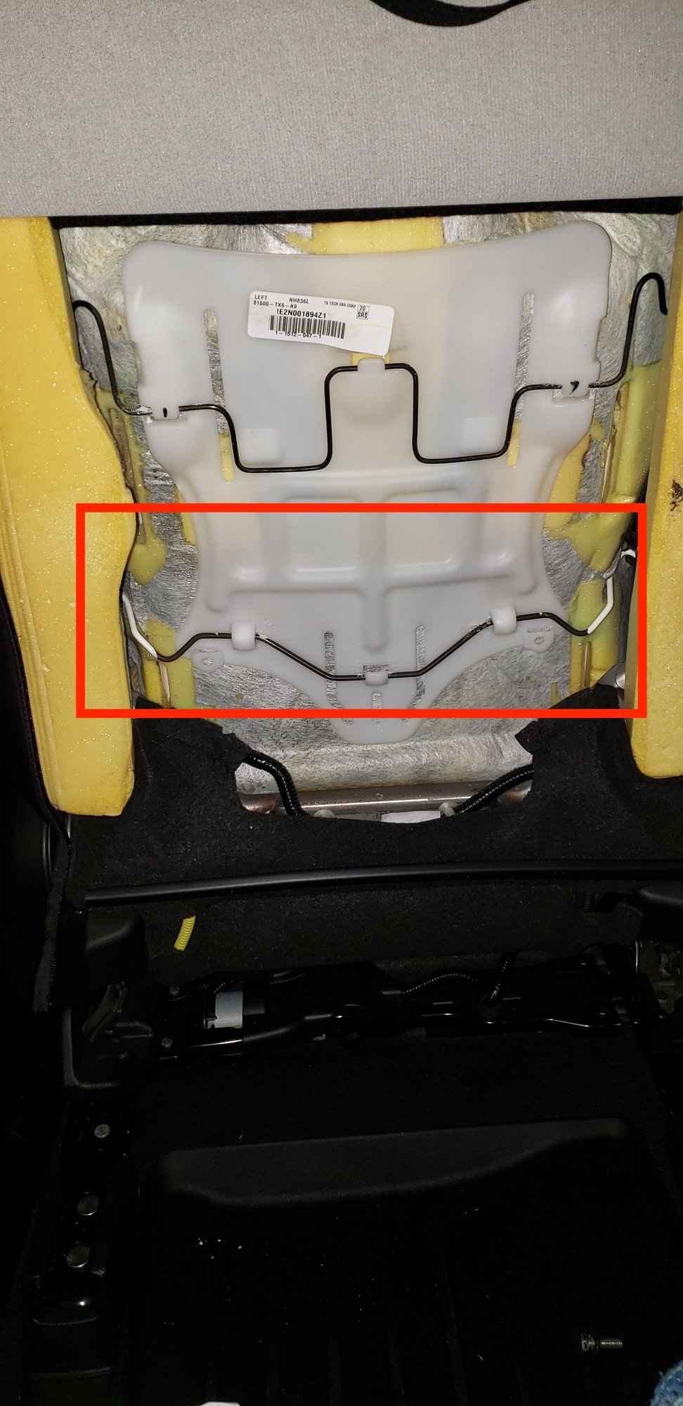

Decided to take a few minutes and investigate the seat popping / clicking issue. It is actually quite easy to pull the back cover up on the seat. Once open, I found that the lumbar support torsion bar (lower one in image) is what causes the issue. This bar loosely connects on both ends to a mount (I don't have pictures of this) and presses on a spring loaded lever that allows the lumbar area to be pressed back and keep constant pressure. Unfortunately what seems to happen (at least in my seat) is that the seat pad wears over time and the padding is no longer as thick as it once was. When this happens, it does not keep the already loosely connected bar pressed against the spring loaded levers on both sides. In my case the issue is more with the left side of the lumbar area. With the added clearance, the metal bar ends will tap against the mechanism and slide around causing it to flex and make popping / clicking sounds and vibrations when under pressure from your back. Honda definitely saved a few dollars on this design as it sure does not work well for long. Could also be part that the torsion bar gets bent out of original shape a bit and there may have been some rubber coating on the ends of the bar that have work off.
From what I can see, the fix is to either replace the seat pad with the OEM part or try to pad the area between the really thin plastic backing material and the seat pad. This puts pressure on the torsion bar and keeps the clearance nice and tight. So far, I have folded a small rag over a few times and placed it behind the plastic plate right where the lumbar support bar is. Just that alone has made a huge difference and there is no more clicking. May end up getting some nice high density foam to put back there as the OEM pad is not cheap and you have to then swap the entire seat-back cover and seat heater. Doesn't look like a complicated job but I don't like messing with upholstery. Always seems to get wrinkles in it somewhere. Another thing I have thought about trying is to replace the bar entirely or add a very thick rubber coating back to the ends where it presses on the lever.
