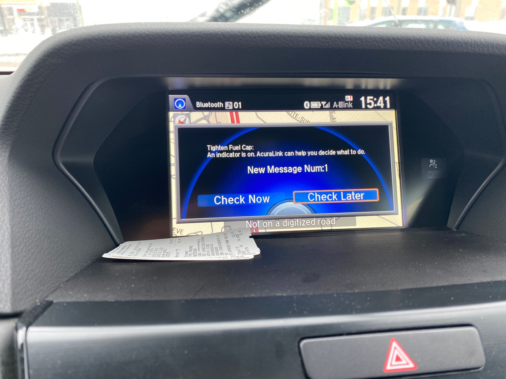

I'm facing a weird issue where my navigation system would just restart when driving.
I have a short clip showing it happening when I lock the steering wheel.
Every time it happens, the navigation would reset (both screens), I would lose memory seat settings, I would get the ''Tighten Fuel Cap ' error, and also the driver proximity sensor would not unlock, but locking works fine.
The car starts just fine every single time, so probably not a battery issue I guess. Maybe a fuse problem.

Hi Yes, I did. It was the battery back then, even though I was less than a year old at the time.
Replaced the battery and never had the issue again
