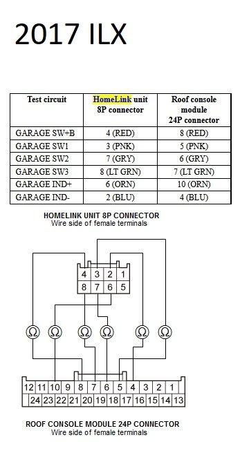

2016 ILX, base package. We just helped my SIL purchase it and I'm disappointed that it does not have a built in Homelink (and poor audio quality, but that's for another topic).
I purchased an overhead maplight unit with the built in homelink HONBBHL4 module seen here: https://fccid.io/CB2HONBBHL4/Interna...photos-1559111
I'm used to homelink modules using three wires (Power, Ground, Illumination), however this unit requires its own 8 pin connector, which does NOT come standard on the base model ILX, much to my dismay.
Where would I be able to find a pinout to power up the module? I do not understand why it needs anything more than Power/Ground to work.

I don't have enough posts to send anyone messages, but the connector for the first gen TLX homelink should be the same.

That should about cover it:
And then TLX Homelink:

Thank you sir! No wonder it didn't work.
Looks like the module doesn't even connect to the buttons directly, but has to reroute back through the roof console... I'll have to do some jumping...
