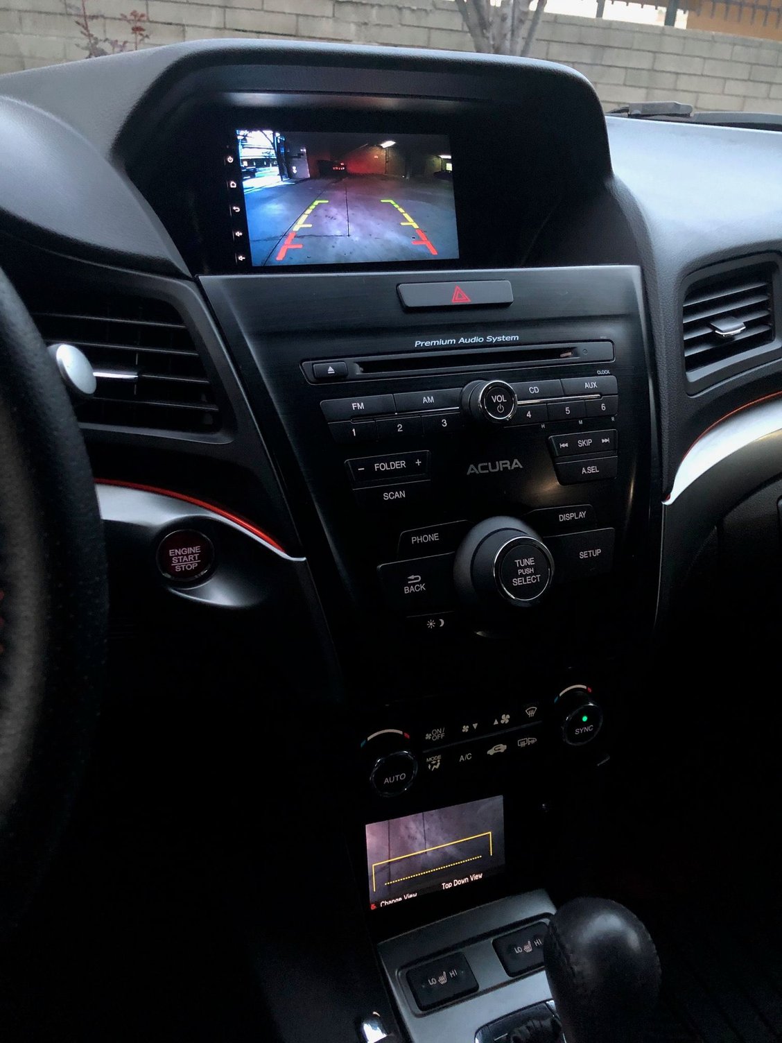

As we all know the ilx with the base screen has ZERO options to replace it! I tried many things didn't work ......until i found a idea.
Look below! Not bad for a first time huh? 7 inch Andriod head unit in the oem display housing. I plan to relocate the oem screen to where the cubby storage is below and have 2 screens 1 for apple car play and 1 for radio. both will be backup cameras too! wide and up-close veiw.
I just wish i knew how i could cut a clean circle shape where the passenger airbag light would be as i vny wrapped over it. I can still cut it out just looking for a circle punch or something super sharp. My hand ins't skilled enough to make a nice uniform shape
the total cost to make 251$ give or take could even make some to sell if anyone else is interested dm me! (any 7 inch Andriod head unit works) just lots of labor and skill.

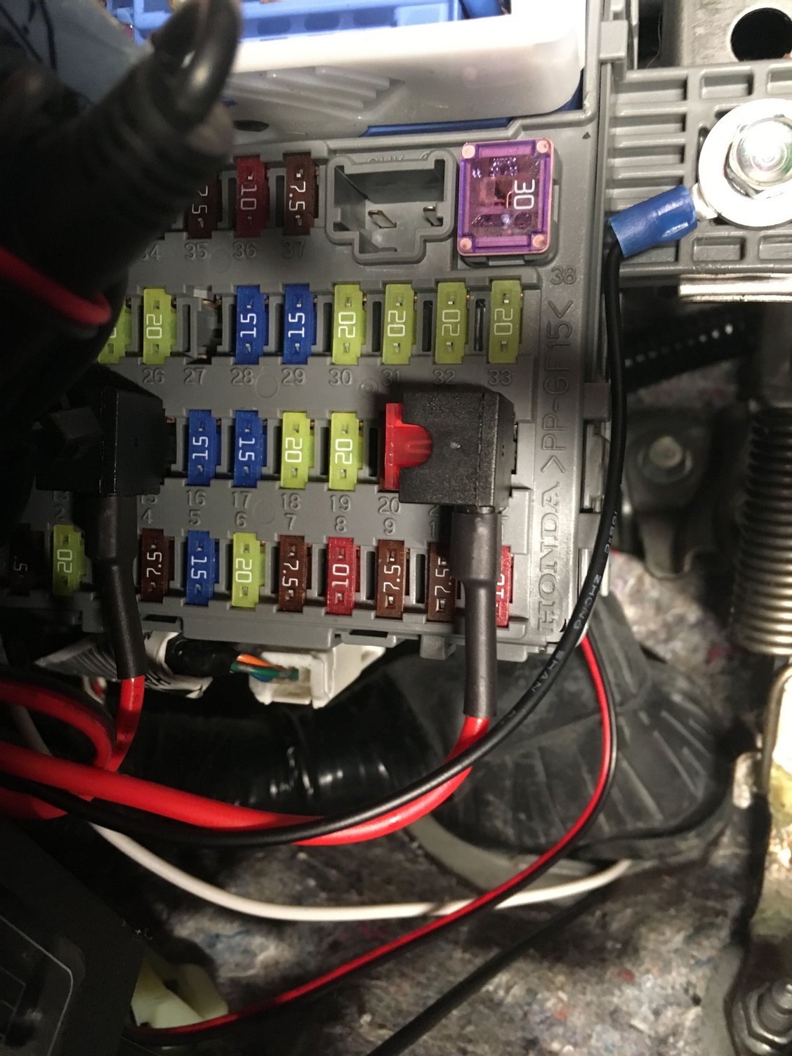

help! i cant find any acc wire that powers the android radio ... There is a thicker black and yellow cable which is + and - but they are live 24/7 i would rather connect both power and acc wire of the andriod radio together and tap into the oem acc wire i think it will be fine since its only the radio and the aux being powered and not all 4 speakers that the andriod unit can power

Check the blank(unused) fuse locations for switched power. I did this in my RDX for my exhaust cutout.

done! apply car play ! and 2 back up cameras! on a base ilx

Is it kind of difficult to reach the screen, being recessed in the binnacle?
Old Mar 13, 2021 | 12:40 AM
REEEEEEE's Avatar
Joined: Sep 2019
Posts: 115
Barely touch it maybe 2 or 3 times a drive i got apple car play so once my one is connected spoifty automatically plays i can skip with my phone or just lean over. Either way it takes a shit on the oem screen that does nothing and is so small.
