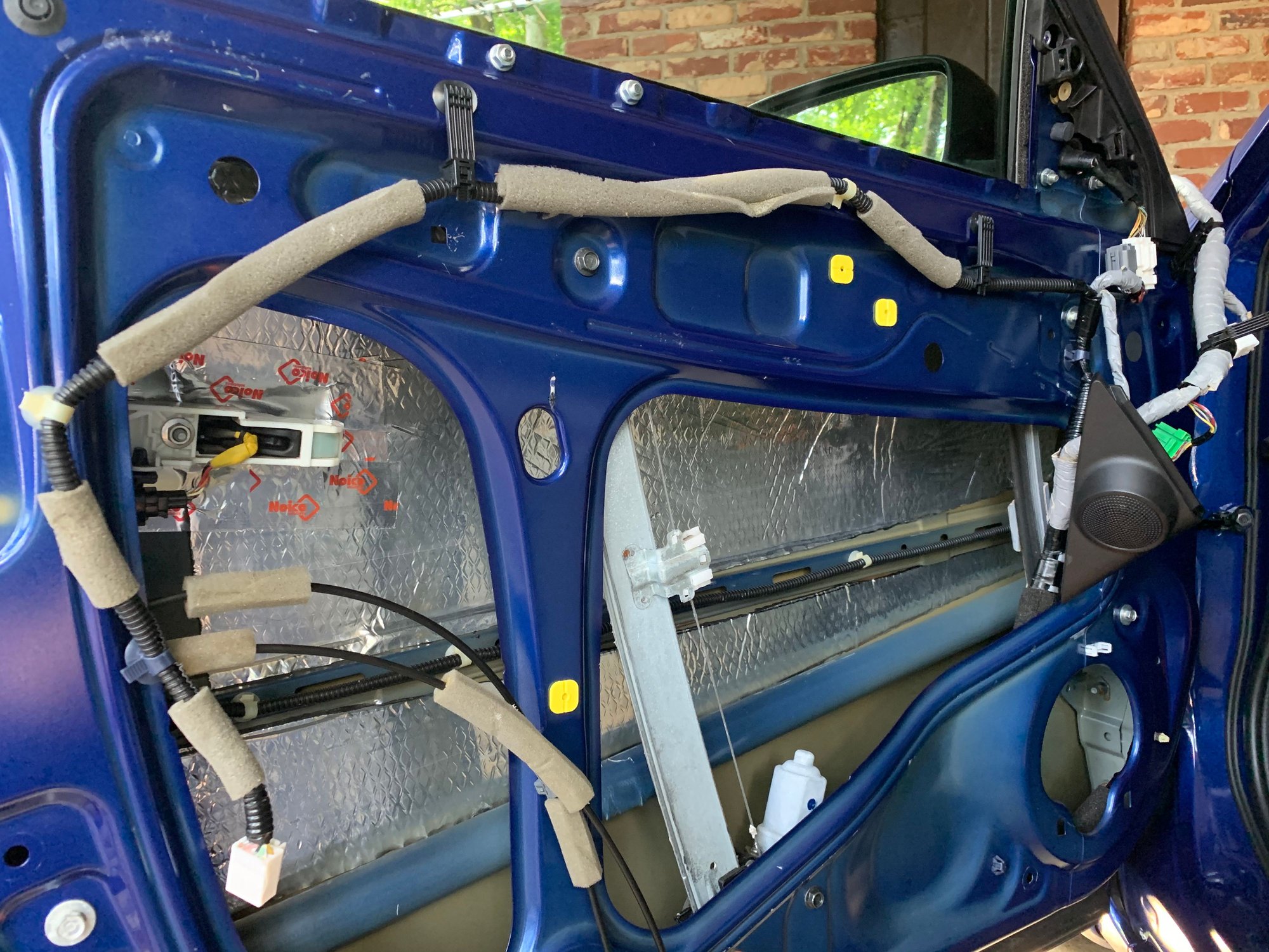

I started with the driver door, by removing the interior panel. (Note: I would recommend starting with a different door, as you are likely to get more efficient and learn as you go, so you'll do a better job on the driver side door if its the second or third door you complete. Just a tip I wish I had done). The door panel is held on by three screws and several clips that pop out. There are two screws behind the door pull latch and one screw under the rubber matting in the pull handle /grip. After removing the screws you can run a tool (I bought the listed trim removal kit that helped a lot to avoid damaging any panels, scratching the car or breaking clips) or your hand around the sides and bottom of the panel until all the clips unhook. Pull the panel up to disconnect it from the door shell and unhook the wires connected to the power windows/locks and pull latch. You can then set the interior door panel to the side (somewhere it will be safe and protected).
Interior of rear passenger door. This is the factory installed "sound proofing" consisting fo a thin piece of black foam glued to a thin piece of white plastic.
I then cut out the factor installed "sound proofing", keeping the black foam insert, but discarding the white plastic. I also pull the white caulk off of the door frame to ensure proper adhesion of the butyl. (I found that if you pull firmly, but slowly the caulk will release rather cleanly almost in one long strip). That exposed the interior of the door, where I then installed the butyl and foam to the interior of the exterior door shell.

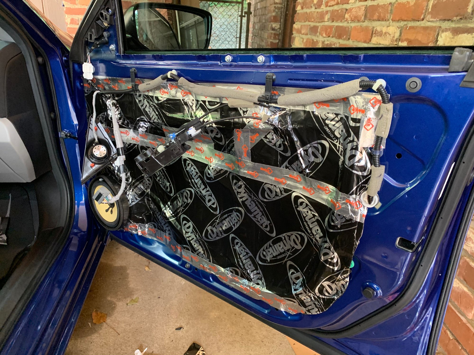

Front Driver Side Door. Installed butyl along the interior side of the exterior door shell.

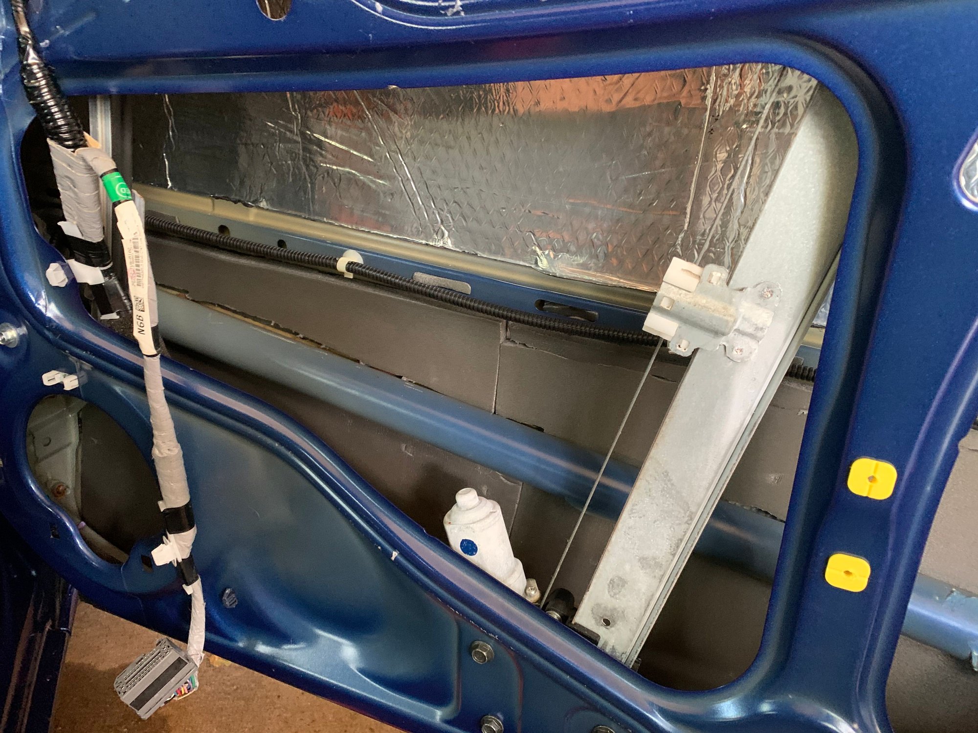

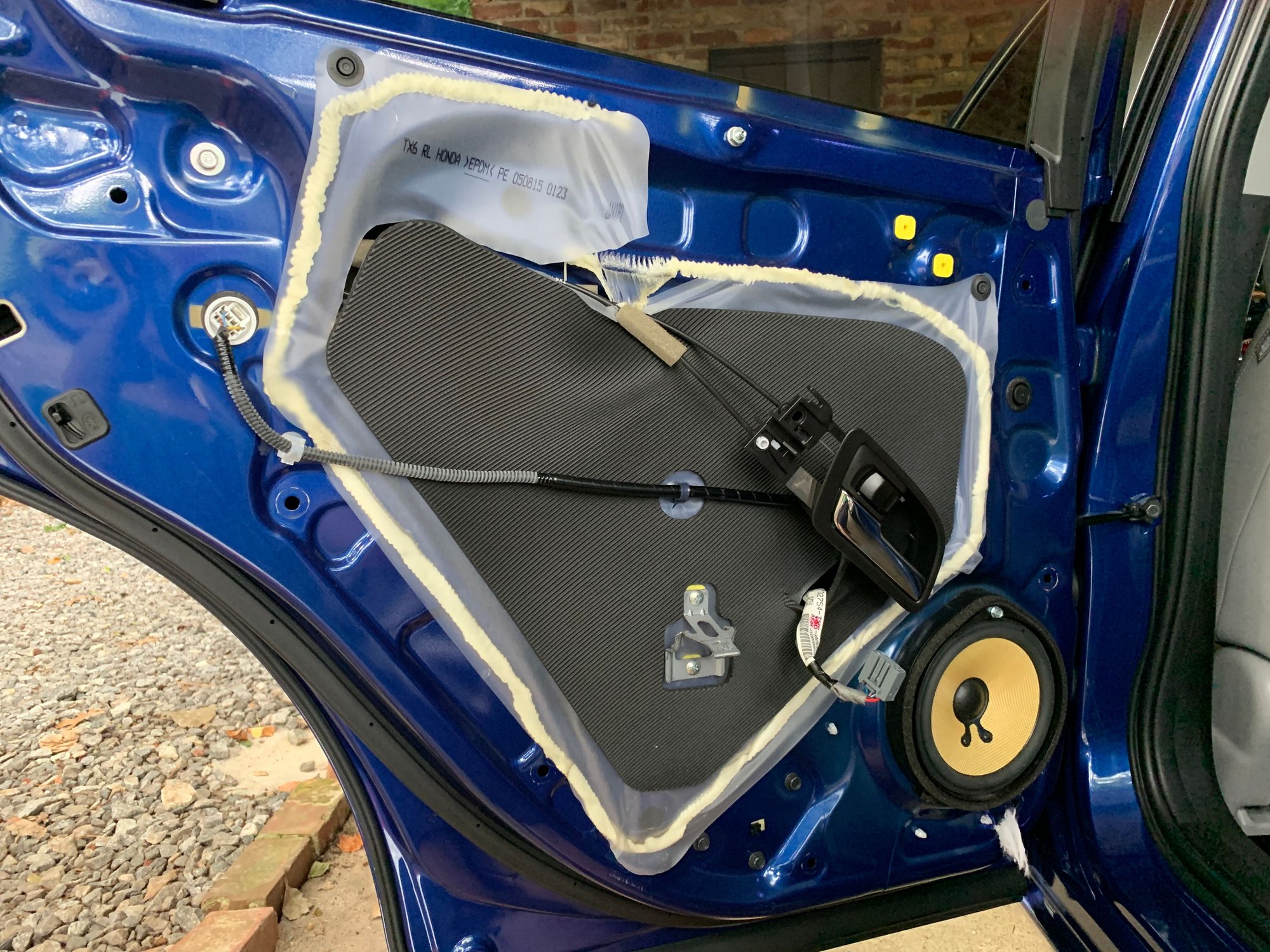

Front Passager Side Door. I started installing the foam over the butyl, including behind the speaker.
Once I covered as much of the interior as I could, I then covered the interior of the door for another layer of sound proofing. Make sure not to cover any wires or lose any of the connections!
Front Passager Side Door. Covered interior openings with Dynamat.

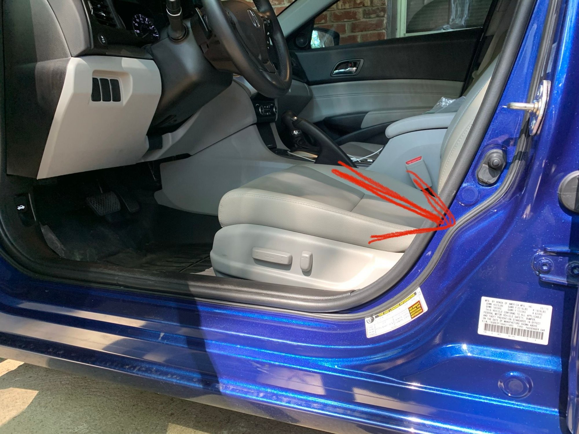

I also decided to put another layer of weatherstripping around each door, as I saw this suggested in another post online. I decided to do one continuous strip around the entire door that goes between the two existing layers.

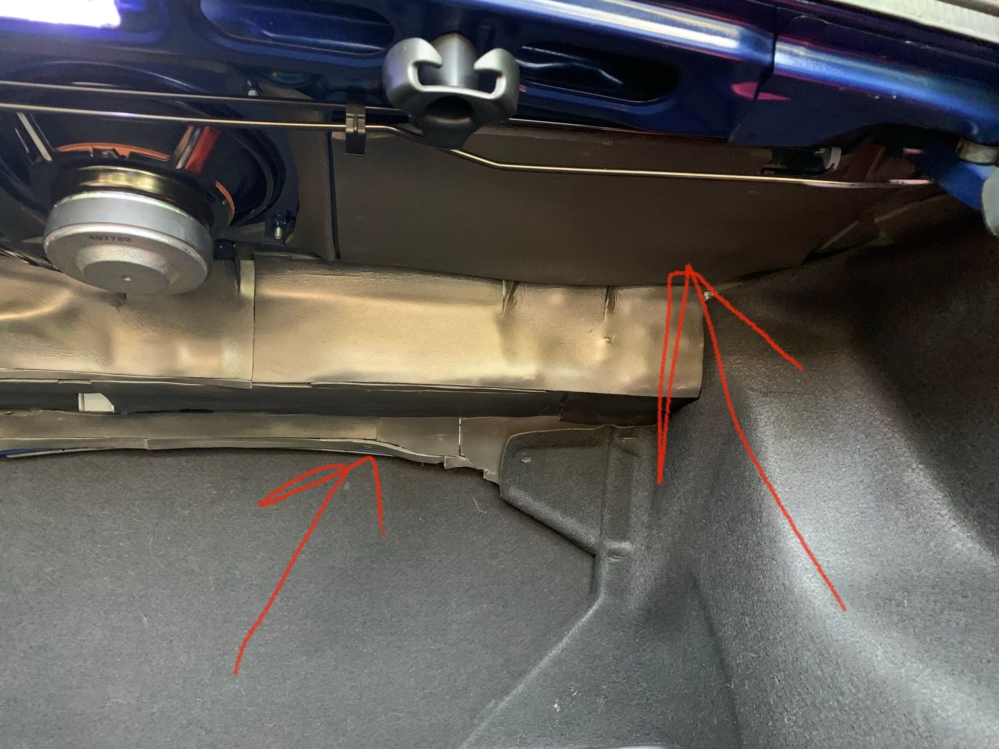

I didn't take any photos of the trunk, but it was much easier than the doors! There are three carpeted panels in the trunk that slide right out once the plastic clips are removed (they all pop right out with a flat head screw driver or similar tool). I installed the butyl matting in as many flat smooth area as I could find (mostly in smaller strips than I used in the doors). I also used the spray sound deadener listed in the spare tire well, and other tight areas within the trunk. I then let that dry, installed the foam over the butyl, focusing on covering the wheel wells, back of the rear seat and the under side of the speaker deck.
Trunk interior. Underside of rear speaker deck.
