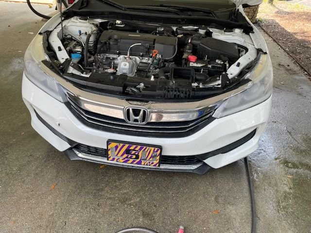

I always wet sand them with 1500 then 2000 grit sandpaper then buff them out with 3M buffing compound for 1500 grits scratches or finer. I have been doing this process on all of cars including this one currently. Accord, Fusion, Prelude, Camry, Ilx, and other peoples cars.
