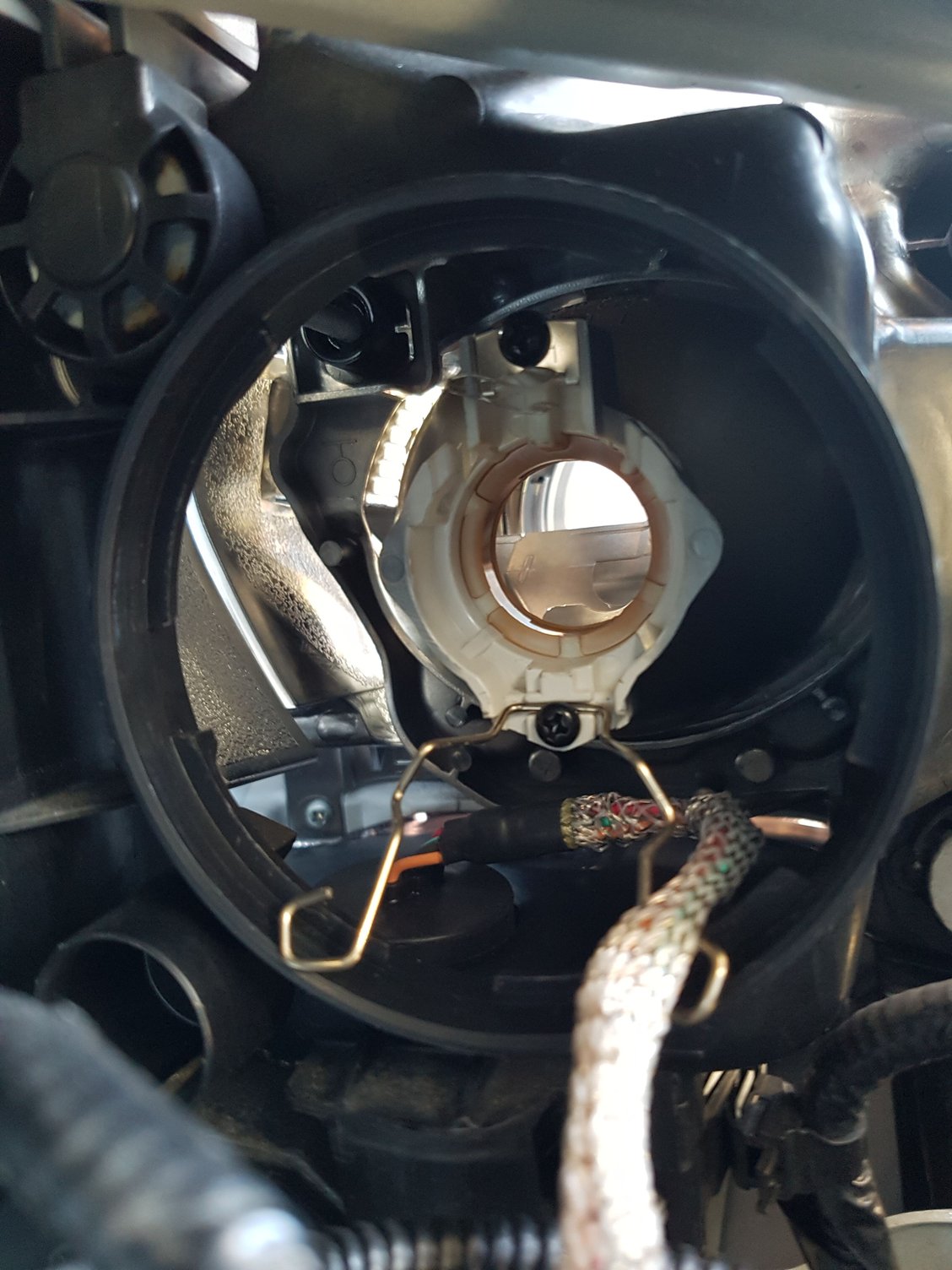

3) Push in to release the spring tension bars holding the bulb in place

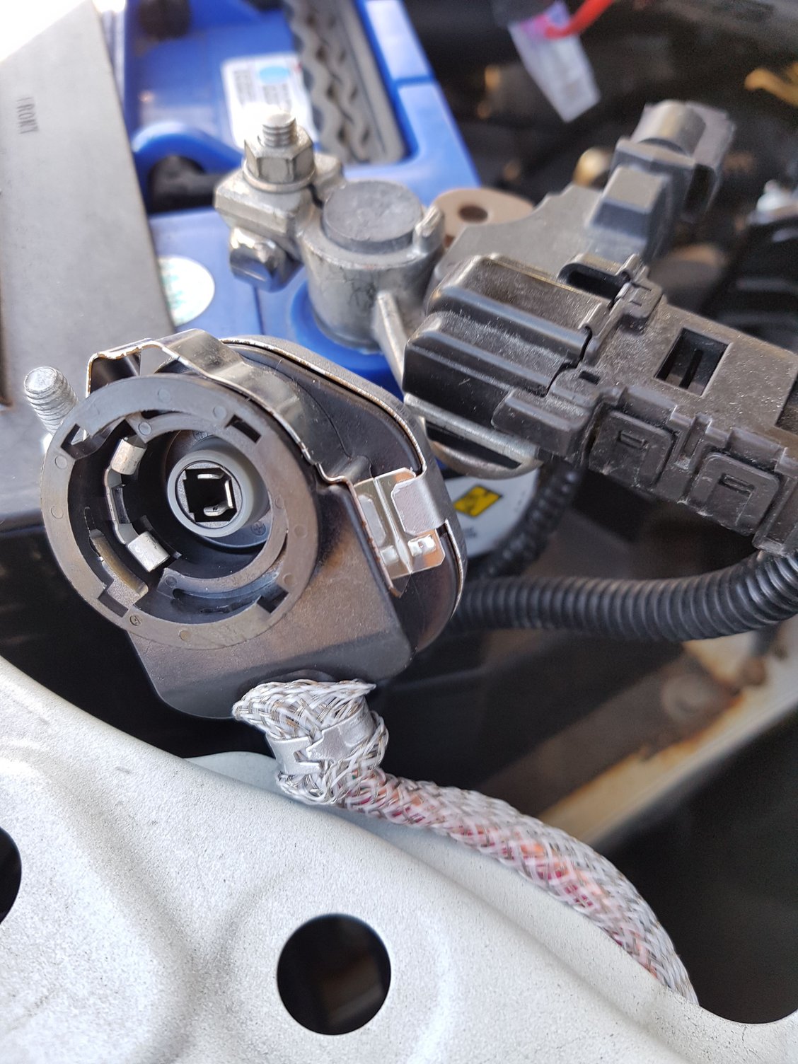

Yes I did remove the headlight assembly in the past, however not necessary to change the HID bulbs.
Ensure you connect the HID bulb correctly into the wiring harness.
Spring tension clips that hold the bulb in place.
