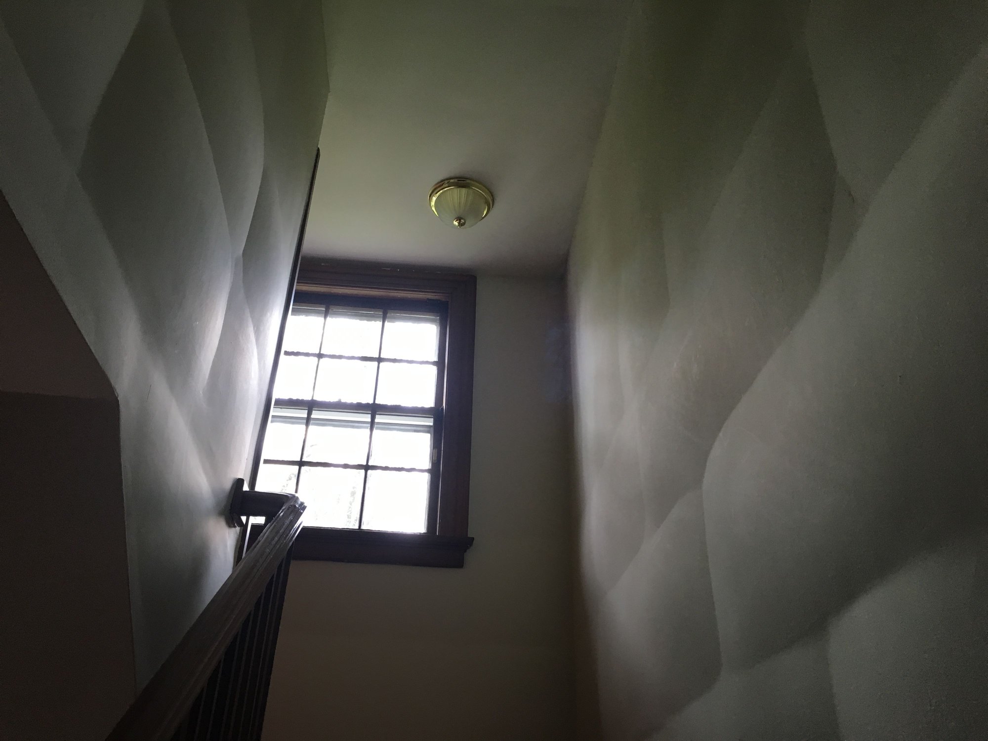

Hey guys, been house shopping like crazy, and found a GREAT house, GREAT location. One of the few ones that is in an area with conventional bidding, not this sealed bid best and final nonsense. HOWEVER...there appears to be major pillowing on the upstairs ceilings, some upstairs walls, and some areas of the downstairs. I am contemplating whether or not it is even taking a full fledged tour during the open house (requires renting a car and driving out there). The problem, so I hear, is that the original plaster board was only 0.5" thick, nailed to the frame, and then the first skim coat never fully dried prior to the second coat. Over time, i.e. 90 years, it looks like this. (The house is 3,000 SF, brick exterior Giorgian colonial with a slate roof. The attic has no water leakage, and is dry and finished).
How major is this?? My contractor said either the following (although he is unsure)
1. Skim, and cross your fingers hoping it wouldnt crack down the road
2. Add on a layer of sheetrock to the ceilings and re-mold (not sure how this would work for the walls, or the common areas by the stairs)
3. Tear down the plaster board, and add new sheetrock. May also require fixing the insulation, as it could fall out of the ceiling.
I am planning to do some renovating during the first month of ownership prior to moving in. So this COULD be okay, assuming I address the $$ work during the attorney review. The asking price may have a good $50k-$75k of wiggle room between market value and said repairs.
The house was built in 1930, like just about every other house in the area. Actually, this is on the newer side. Every house I have seen has it's issues - knob and tube electricity, in-ground tanks, no A/C, etc. This house's particular problem is pillowing plaster board. Just trying to assess whether or not this is pencils down.
Thanks guys!

To do the job right you have to tear out all the plaster and lath and re insulate and drywall everything.
If you don`t do anything it might not get worse or it might.
I have a 1918 post-colonial and also have plaster and lath.
The cheapest fix would be to put a skim coat over all the areas that look like they are sagging, repaint and hope that it doesn`t sink any further.
But, you or the contractor can make that determination.

Plaster sucks! I would either put sheetrock over the plaster or replace all the plaster to sheetrock but the nice thing you don't have to do it all at one time, do one room at a time and it won't be that bad.
Make sure the plumbing and electric has been updated because that will be the biggest pain to redo / fix.
House is gorgeous!!

You can still knock down the plaster and put a thicker coat of plaster over.
Unless you have a trusted person to do the job it`s important to get at least 5 estimates and the cheapest estimate isn`t always the best one.
Also, when buying a new older house always get as much done before you move in because once you settle in you would rather enjoy the house then work on it.

i love the sound insulation that plaster provides... my current home is all plaster and it is amazing how little sound travel between the walls... my cousin who had a brand new house build with sheetrock can literally hear a light switch downstairs flip on and off from his master bedroom upstairs... i would be hesitant to rip everything out unless you had a structural issue you had to address with the timber frame or needed to reinsulate... being that it is on the ceiling, unless you plan on opening up walls to run new lighting or in ceiling speakers, i wouldn't touch it...
if it were me, i would just lay some 3/8 or 1/2" sheet rock on top of the plaster and call it a day... you won't miss a half inch off the ceiling... and if you have to do the walls, it isn't much to pull trim either...
you could try the skim coat and pray but if it does fail after you have moved in, now you have to deal with a repair while you are living there... now that you haven't moved in yet it better to get it done and the mudding and sanding and paint can happen before you move all your crap in... (what Nicks said)

I was quoted the following for immediate work; this is VERY rough. Just basic guidance.
$10-15k – Sheetrock over 4 bedroom ceilings (no plaster demo), paint, install new picture frame molding. No walls.
$10k – Master bath – replace all floor/wall tiling and install standalone vanity, keep tub, keep toilet
$10k – Upstairs full bath - replace all floor/wall tiling and install standalone vanity, keep tub, keep toilet
$3k – Powder room – replace all floor/wall tiling and install standalone vanity
Basic interior paint here and there – I could do that, and that’s the same on any house really

Turned out to be more than just ceilings. I've never seen anything like this in my life. The whole house would need to be stripped to the frames. It also needed a new slate roof and a new roof on the detached 2 car garage. Should be pushing 200k in repairs. It's in an amazing area. Curious to know how this turns out. Either a contractor will buy it, or they demolish the house.

From what I can find on the internet, that's a result of using gypsum lath -- essentially thin drywall under the plaster. The gypsum lath seems to postdate the age of the house (everything I've seen with plaster/lath around here is wood lath), so all that pillowing could be a renovation gone wrong.
I'd walk away because if they messed up what you can see, I'd be even more concerned about what I can't see.

i think you are correct with the assumption of the postdated renovation... my house was built in the mid 50's and uses plaster board sheets (8" wide) and then plaster on top... everything before that used traditional lath & plaster (my parent's house was built in the 20's/30's)... if i had to guess, they thought that by using plaster boards, they could go thin on the plaster... when in fact this isn't like joint compound and drywall... what blows my mind and i can't even guess how it was caused is that every panel is evenly pushed from the center but no major cracks at the seams... it's almost like there was air pushing from behind the panel... that's really interesting...

i dont know WHAT happened there. You couldnt plaster over it, as the bulges in some areas must be a good 4" from the wall. The whole house needs to be taken to the frames, and 10s of thousands of pounds of plaster and wood need to be removed from the home. Remember, its the wood slats that are buckling, not the plaster. Plus, you need to determine that its not water damage or mold. What a nightmare. Not for me, no thank you.
The slate roof needs to be replaced immediately. And the slate roof on the detached garage has holes in it covered by a tarp, so that another new roof and structuring on the garage.
The house was listed in the high 8s, and needs $200k worth of work day 1, so let's not get too ahead of ourselves in this being a steal to get into a great neighborhood. Also, all three bathrooms are 50 years old, and the windows are 90 years old. I wouldnt offer a penny over 6 for that, given the risk associated with the repairs. The house will likely sit for months, and then some contractor or developer is going to take it down at that price point...maybe even lower.

The prices you got to fix the problem was really high in my opinion. To do it yourself absolutely no way to big of a job. At the end of the day I think you made a good decision.

pretty true. Sorry for misleading. My wife wants nothing to do with this project. I dont really either.
I have some experience with doing drywall (working on my house and helping friends out) and I would walk away from this house as well. If it was just the ceiling it ain't that bad, you could just do it one room at a time but this house every wall needs to be redone and your talking some serious work.
