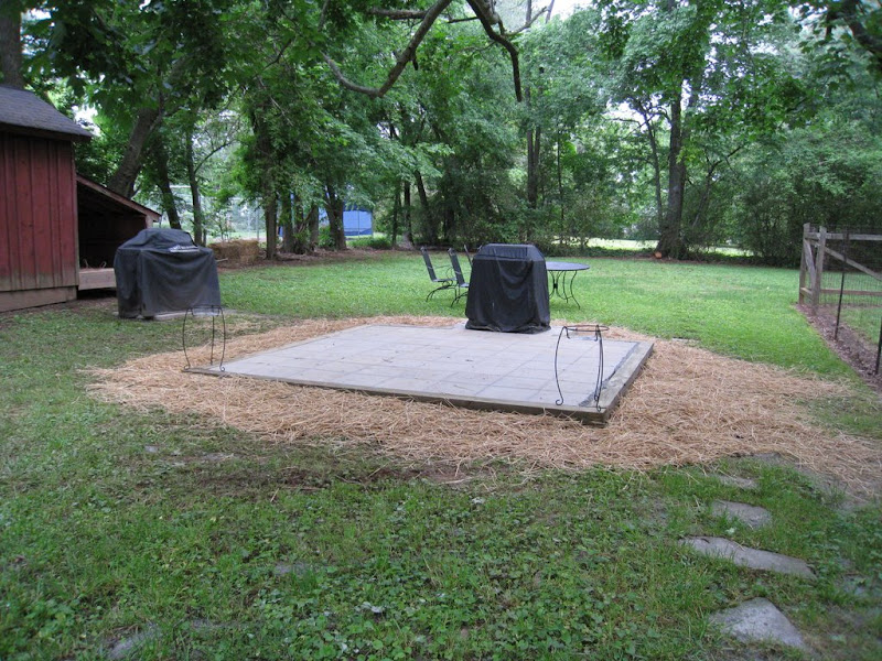

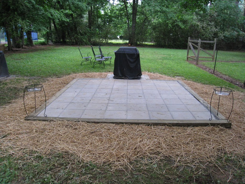

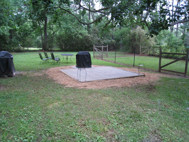

I just built this a few weeks ago using 16x16 stones you can get at Wal-mart, home depot, Lowes etc. I bought 4x6's to make the frame, all sides have two 4x6's stacked then anchored with rebar. Crush and run was used build up the base then packed down. Next laid the stones, leveled and i'm in the process now of sweeping play sand into any cracks between the stones. That thing on the back that looks like a grill is a chimnea.
