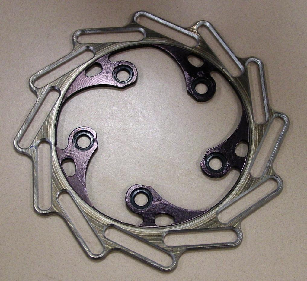

For track use that extra ventilation can be critical in helping to keep the brakes from overheating. Even if it is not a lot, it could make the difference between cooked brakes and ones that still work well. On track you want the latter. Drilling or slotting can also slightly reduce unsprung mass which helps with suspension performance. It also reduces rotating mass which can help acceleration and deceleration (think a smaller flywheel). On a street car it is likely never noticeable, on a race motorcycle or purpose built race car it could make a difference. On track, the price of brake pads is generally negligible compared to the other costs (tires, entry fees, etc.), particularly if you have a sponsor providing the pads free or discounted.
For motorcycle track use, you can get rear brake rotors cut so about 80% of the surface area is gone. The rear wheel can be in the air due to weight transfer at max braking so it is useless at that point anyway. A few of the best racers can use the rear brake to steer the motorcycle in slow corners and so run a little more. Some race orgs also don't allow these in some or all of their race classes. Here is an example of a cut rotor. I have a similar one on my SV650 track bike.

It's more for reducing mass, not overheating the brakes. After all, you're not overheating the rotor, you're boiling the fluid. Brake rotors on most competitive race cars are NOT drilled/slotted because it extends the life of the pads during the race (not for cost benefit) and doesn't provide much of a benefit anyway. The holes on the side of a rotor don't vent much heat, definitely not as much as the vanes on the inside of the rotor body. Remember air flows parallel to the surface of the rotor, not perpendicular.

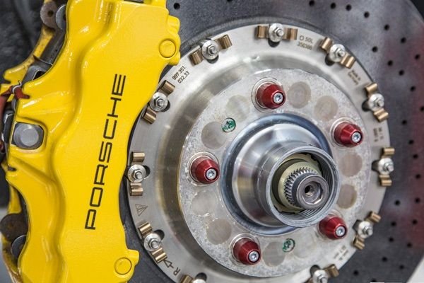

That they are and luckily I'll never have to replace them. The original owner ordered them as an option when he ordered the car. I wasn't thrilled at first, but now that I have them, no brake dust. Hey maybe its because I don't brake for the curves. LOL Also, these PCCB last, especially in my case.
Another thing is the Centerlock wheels; totally useless for 99.9% of us but standard equipment on the GTS, Turbo and GT models. On a street car; what was Porsche thinking? But they look cool but also a pain re removal & installation.

Maybe in the aftermarket world, but as a Porsche option, they were less than $10K.
This is what you get on all four corners...
BTW, this is how those brakes are made...

$10K option, but if you are adding to a car after, the OEM price from porsche is in the range I quoted.
Replacement OEM front rotors alone are $11.5K.
https://www.suncoastparts.com/produc...SABEgJqU_D_BwE
Want rotors and calipers? $29K
https://www.suncoastparts.com/produc...CABEgLoA_D_BwE
Want to buy used set of front and rear? Current ebay price is $16K
https://www.ebay.com/i/122733607918?...iABEgIbvvD_BwE

Wow! Good thing I know how to rebuild things. As for the rotors wearing out in my case; never going to happen.
Funny how many went from Centerlock to the 5-bolt pattern. I can see why for practicality, but who said a Porsche or any sports car is practical.
