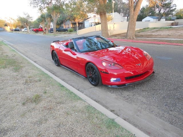

Well, this was not a full plastic reconstruction but more like a minor revision. After modding the car, it was not worth it to me to get new rear fenders, paint them, get new wheels/tires, new ZR1 skirts/CF mudlflaps, ect. So I came up with an idea just to make it look a little wider without breaking the bank completely.
I will say I read a lot of wrong information online about replacing the rear studs and this was MUCH more difficult than anticipated. Me and a buddy ended up having to pull the hubs out completely and it was a PITA!! We learned from all the mistakes of the 1st side and the second side went much quicker. ARP extended race studs, billet hub-centric 0.5” spacers, and custom Z06 splash guards in carbon fiber (were wayyyy too expensive, but worth it).
Some pics.
Before with the non-carbon fiber Z06 splash guards I ended up returning/exchanging from CF ones:
The Goods:
Before I realized that the longer studs were NOT getting in without pulling the hub completely out (drilling a hole in the backing plate to avoid pulling the hub ONLY works to get the stock size studs out, but not longer ones in!!)
Haven’t taken many good “after” shots but here are a few. I really wanted to avoid the tires sticking past the fender, and I think this is pretty much as good as I’m going to get it.
Night shots:

You need to roll your rear fenders. Those splash guards look like terrible add-ons otherwise because they don't sit flush with the body.

Pics don’t do this car justice (and it’s really hard to photograph for whatever reason). It honestly came out as good as I could have hoped for and it ties in nicely without looking like an “add-on”. The rear splash guard ties in with the front CF mud flap/skirt and wheel. Gives this affect of the wheel being flush with the fender and extensions; it just depends on the angle. This crappy pic in my phone kind of shows what I mean….
Some others showing its actually pretty well designed. It’s all about the angle of the shot once again. Think you’re over-analyzing this Rick, but what’s new….
Marble,
These CF things were more than those fenders with the shipping, but honestly, there is a lot more that goes into that project than that $900. I would have just bought the entire kit from GM Parts House (fenderwall trim/fasteners/ect) and not get suckered by non-GM flairs without the necessary other crap. I thought this was creative and something I could do on my own without having to leave my Vette with strangers. I’ve had too many bad experiences, so I try to avoid that if at all possible….
The car actually rides better too, which I did not expect. The slightly widened rear track changed the “feel” of the car. Difficult to describe. It could also be the Michelin Pilot Super Sport Tires I also put on. After all the bad things I read about spacers, I've been pleasantly surprised. Hub-Centric is the only way to go. It could also be the Michelin Pilot "Super Sport" Tires I also put on (take off's from a new Stingray). Now I know why the Stingray sticks well over 1g in the corners. I pulled over 1g on the G-meter in the HUD the other day, with the top down no less, which I’ve never done (record before was 1 g exactly). These tires are UNREAL. I also don’t lose control of the rear end anymore on a hard 1-2 shift. HIGHLY recommended.

Looks good but you need wider tires

It's very close, I'd say get another 1/2" and your good.

That add-on definitely adds to the car. Only (minuscule) criticism is you need another 1/2 inch of tire to match, or a spacer. Then it'd be perfect Just giving you more ways to spend your mod money.

You need a minimum of 1.5" to use an adapter. I originally bought a set of those, but realized that would be too much....

As far as the wheels/tires, they are 19X10 with 285 35ZR19 tires, so they're not exactly skinny. I really didn't want the wheels/tires to stick past the fenders. I may have 2 mm more at the most, but it came out as good as I could have ever hoped for without swapping the fenders. It's understated and a small touch. I like those type mods.
