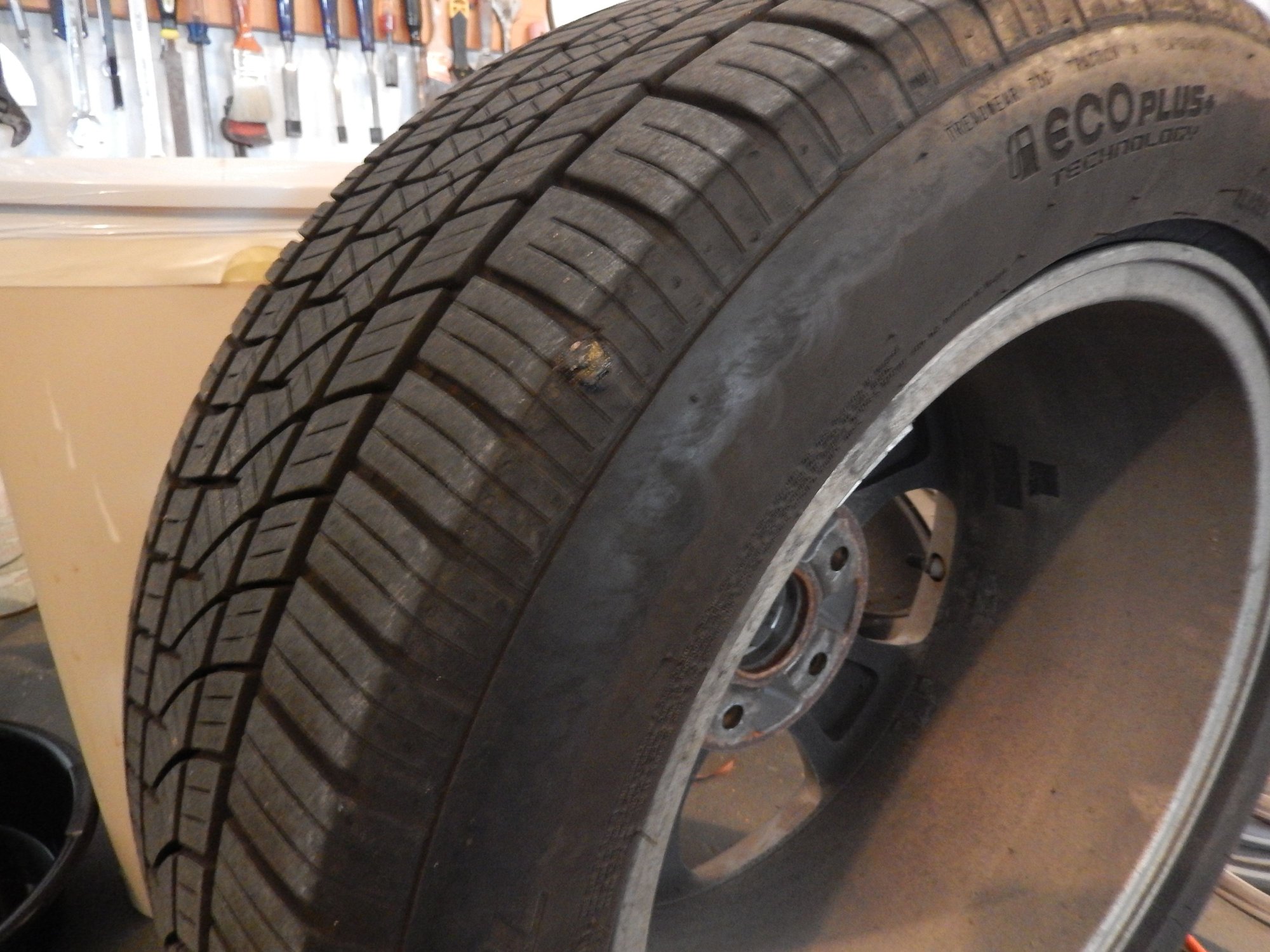

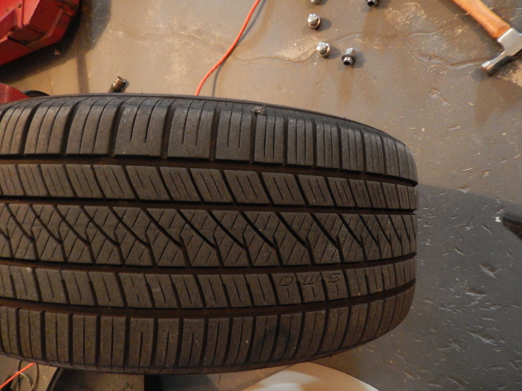

Here are some pictures. You can see it's not quite on the sidewall but more on the shoulder area of the tire. I think I will replace the tire for peace of mind but surely the plug is better to have than the screw that was in there before.

I would not drive on that tire, that is far too far over the shoulder. I have to look it up but probably anything within 1" of the tread from the shoulder is not acceptable.

It’s a shame the tire has so much tread left, but you’re doing the right thing by getting a new one.

I'd agree, after seeing the photo, too close to the shoulder for a safe plug.
Maybe low speed to get you to the tire shop, if you don't have a spare, but I wouldn't trust it long-term.

I have plugged a lot of tires and driven on them for thousands of miles after no problem. I wouldn't ever consider plugging that. That is a trash tire regardless of the tread left.

^ +1, I also have plugged many tires for our vehicles and friends/relatives/neighbors/coworkers/... (I've plugged two tires in the past two weeks) and driven on them many of thousands of miles with only one problem tire plug (my daughter's Civic had a leak that took three plugs before sealing properly).

Bright side: at least the new tire swing has a good amount of tread on it ! I too err on the side of "hell no i'm not plugging that AND driving on it"
