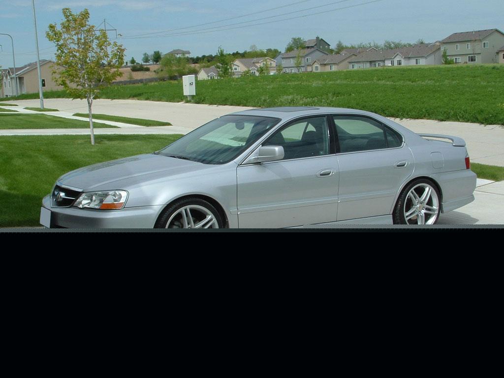

I have 19x8" with a +45 and Eibach's, and I think its the perfect combo.

It's on Eibachs (non adjustable). The drop is 2" and some change. Just enough.
