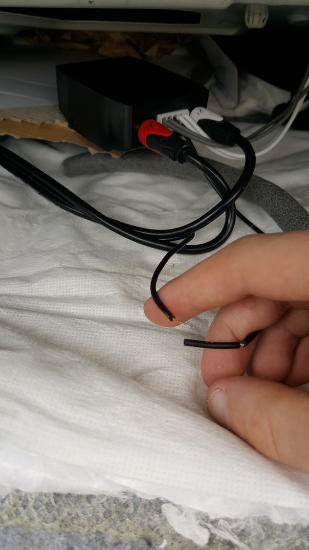

Ok, I'm going to try to move the box sometime soon. Currently, I'm at 80 DB with my HU at 1/2 volume with a 40 HZ tone. Ouch... Also, I was stuffing some stuff in my rear deck to deaden a couple weeks ago and noticed my LOC had two wires cut. Is that wrong? I taped it just in case. have a bad feeling I should've just left them be...

the one wire that runs with the rca cables is typically the remote turn on wire for the amp.
Should I keep the split wire taped or not? Also, is there anyway to tell if my sub and amp are wired for two or four ohms with out taking my sub out of the box? My amp can handle either and my sub has a switch on it for changing between the two

if the sub is set at 2ohms then the amp will automatically run at 2ohms.
i think the black wire coming off the LOC is a optional ground wire, if your getting any engine noise you can use that wire to ground the LOC to help eliminate it.

​​​​​​i just fear when the installer looked at the work the other guy did and saw the incorrect wiring job he may have flipped it over to 4 ohms thinking the guy meant to wire it at 4. This sub has a switch that changes between the two. Either that or something is wrong again. It just doesn't hit as hard as before I feel. At 4 ohms I'd be getting 350w RMS and at 2 I'd be getting 500 W RMS. I also checked out the output graphs from the sub's manual and this thing should be hitting 100 or 105 DB sealed at 2 ohms and 97-102 for 4 ohms sealed. Keep in mind my middle seat is folded down to further increase cabin gain...

you can take a multimeter and set it to ohms, then just hook it up to the leads coming out of the sub box and it should tell you what its running at.

Thanks alot! I was able to find one after digging in the tool boxes my dad has for a while lol. Actually is at 2 ohms, so I made sure to recheck all of my connections and make sure they're all tight. Even checked my AUX cord. Did another DB reading and it's back to hitting 100 DB or so in the 30-40hz range! This system never ceases to confuse me. Can't wait to deaden the trunk and increase that number a bit and remove rattles. It just isn't as tight as I'd like

Well the amp has thrown itself into protection mode again.. Since my installer has checked everything he could, I'm buying an Alpine MRV M-500. Still, I want to ask. What amp malfunction or broken component in the amp could cause it to play for a while and then just randomly throw itself into protect? Ground wire was checked a couple months ago just as my fuse holder and fuse was replaced. My wiring to the sub was also redone

honestly its hard to tell. i have a 1600w Autotek amp i just piched the other day, it acted just like yours and would kick into protection mode for no given reason. even tried it in different cars and sometimes it would work and other times it wouldnt. finally got tired of messing with it and pitched it.
that Alpine doesnt look too bad and not a bad price.

Yes, the reviews are great and it's said to be very clean. Not happy to spend the $ tho lol. Since I'm spending $ I think I'll throw in a kit of sound deadening too. Ive literally had everything checked with this amp and I'm done with fucking with it lol. Is switching out an amp pretty easy for a first timer?

Heat, bad ground, failing power supply, etc.... Alpine used to be a very reputable company in car audio but like many has fallen victim to overseas mass production. Have you considered old school (used or like new) equipment? There are many advantages that I think get overlooked that would be beneficial to most consumers.
