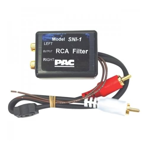

OMG I cant believe my Last Shot resourse actually worked....
PAC SNI-1 FTMFW!!! All Noises Including the Dimming Light One are now Gone!.... And it Only Cost me 10 Bucks....
I Didnt Believe that those Filters really work But Im now a Believer! Not only that, It wont Muffle any Sound at All! I Even Believe it sounds much Cleaner! a god damn 10 bucks magic wonder....
Well Thanks and L8ters!
