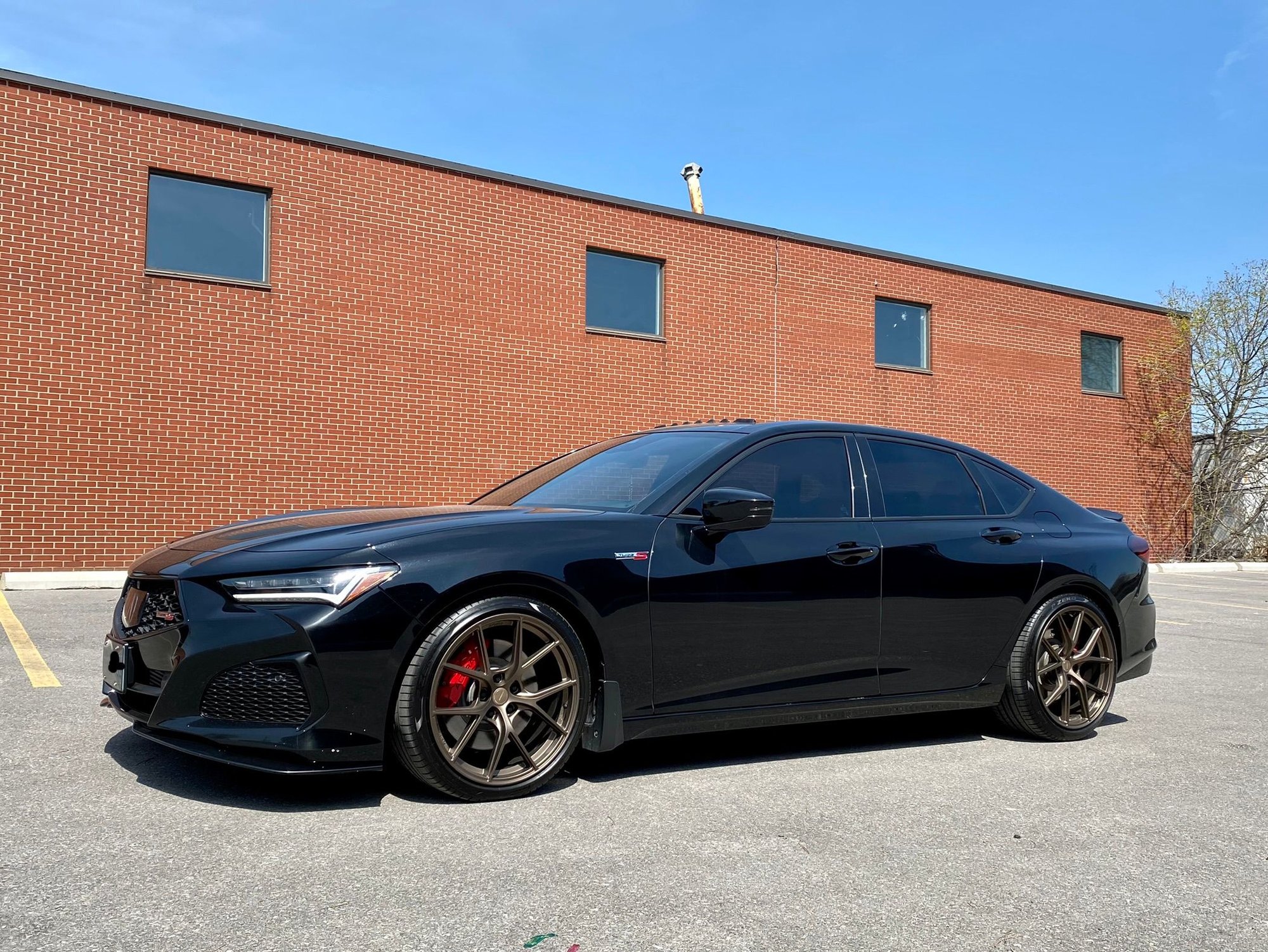

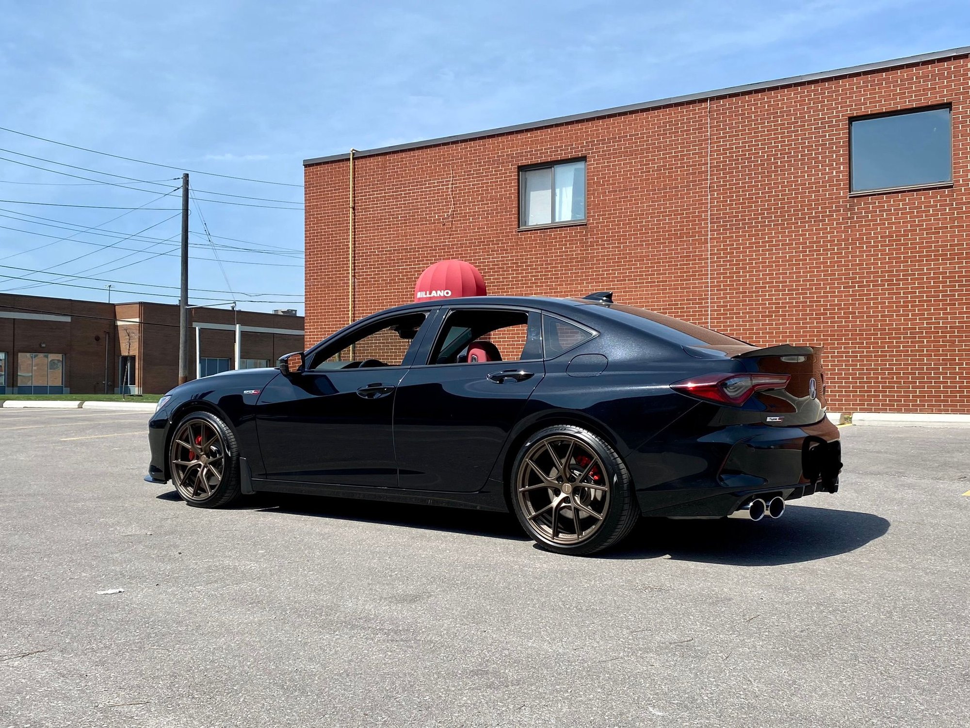

If you want the wheels to come out towards the fender, you want a lower number offset. I replaced wheels with a +35 offset 20 inch 9 inch wide x4, so close to stock. I put the same size tire on it. I saved 17 lbs per wheel/tire vs the oem multi-spokes. I added 10mm spacers to bring it out a little more, and I think it's pretty good now. I'll put a picture below
Smallest type s wheel size - 19's, I'm not sure 18s would fit
Widest wheel - in the front, 9 or 9.5. 10 starts looks pretty beefy, depending on offset. You can fit up to a 10.5 in the rear
Easy way to see the differences between different offsets and wheel sizes is, use something like tiresize.com/wheel-offset-calculator
One more thing to consider when changing from oem tire placement: the side of the car curves in. This makes the tire more exposed to the side of the car the further out it goes. You'll end up kicking up debris on your front doors a lot more. Driving through loose rocks is highly discouraged lol
my current fitment as described before, lowered one inch too:
