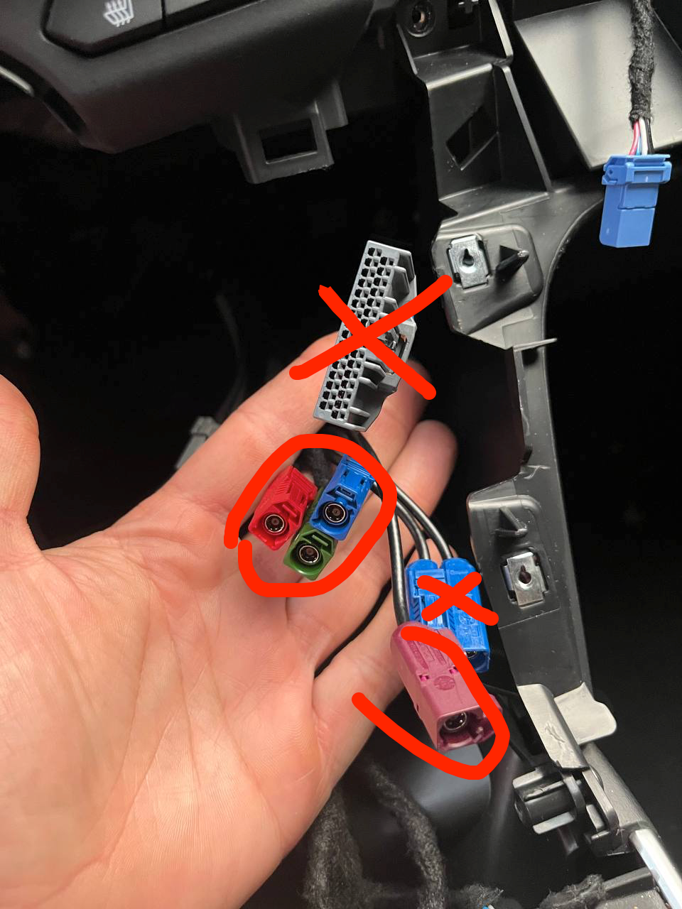

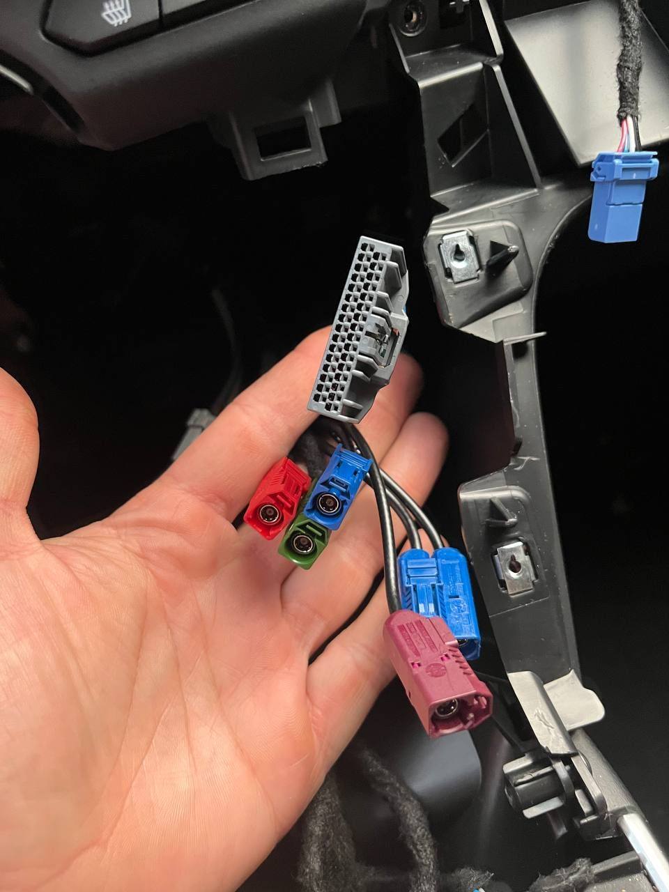

Hey guys, your advice here would save my life.
I've bought an Acura TLX Type S with a missing pannel and a missing Gear Shifter
I've bought missing details but I have a problem with installation. The part I have looks like:
After installation I still have spare wires my car does not work properly
I feel like I'm missing a part here, please advise if you know something

Not sure, though, those connectors (yellow arrows) look like they may be 'navigation' related?
Did you get up deep, under the dash in that area, to look for any 'navi' components that may need connections?
Otherwise,
Also, what is the exact 'trim' description of your TLX?
The exact trim is Acura TLX Type S 2023 10 speed automatic. I will check deeper it they can be connected somewhere else, thanks

I believe I have three more wires to allocate somewhere
