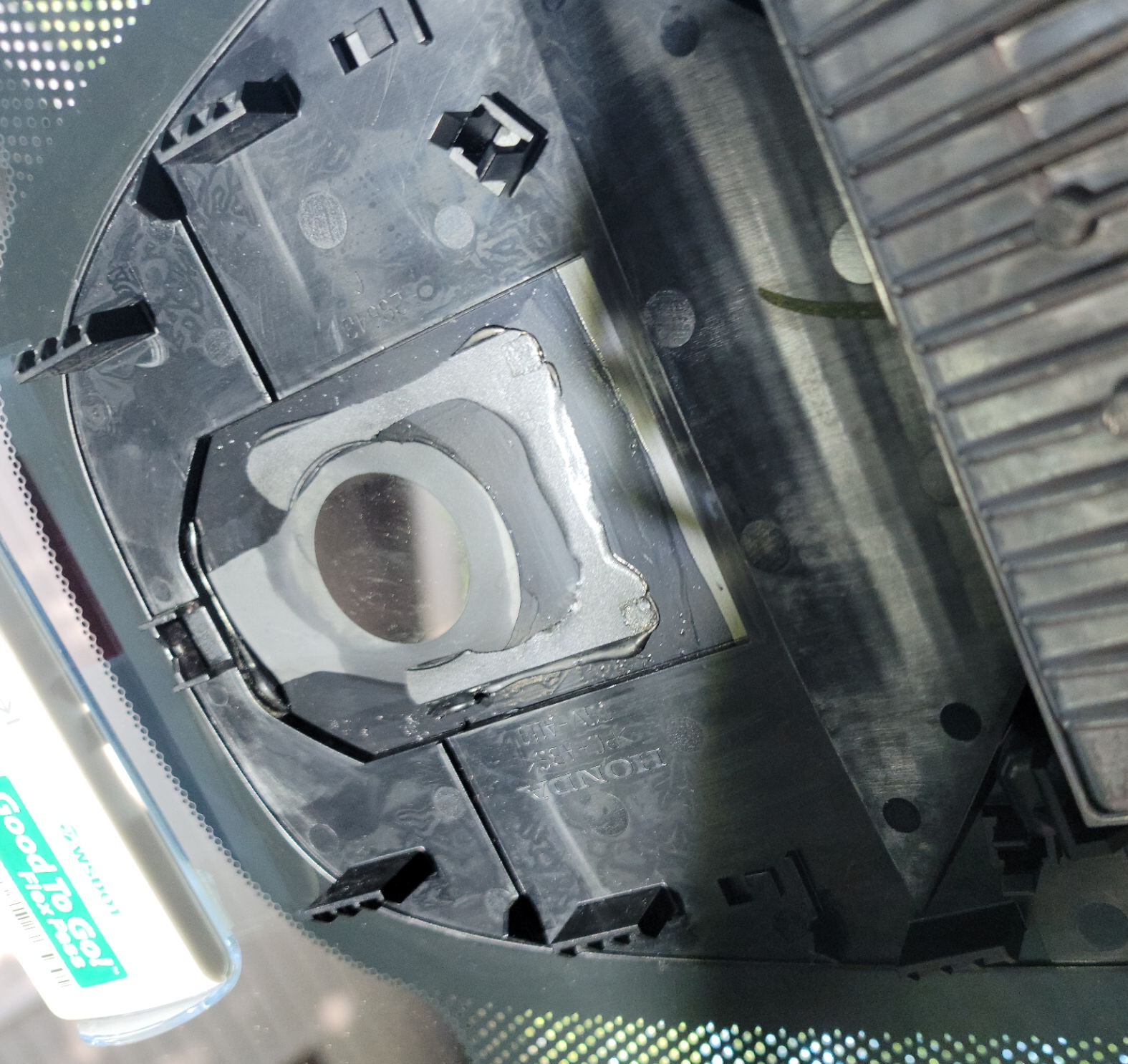

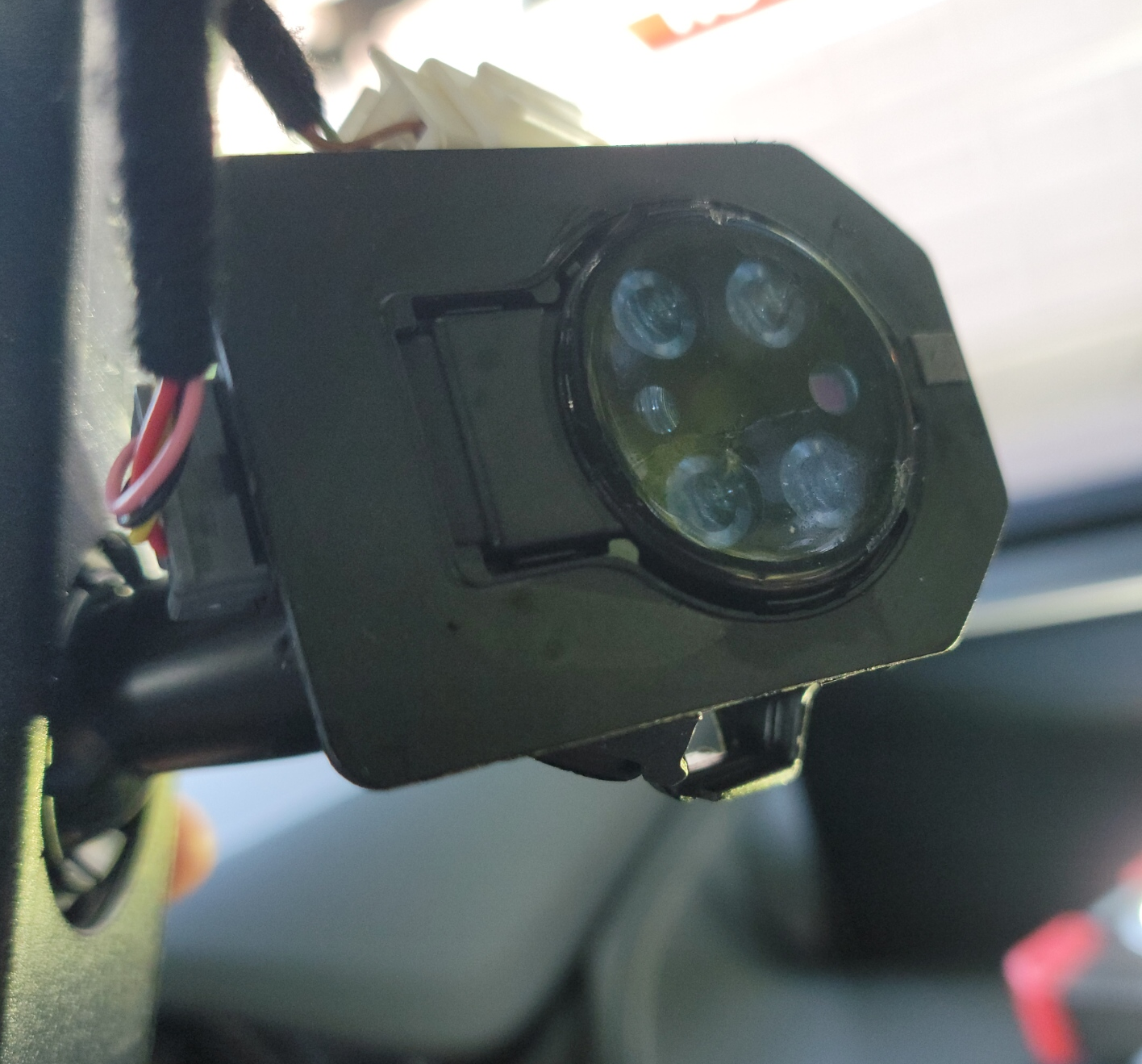

One afternoon I got in my 2025 TLX Type S (~1000 miles) and the rearview mirror was hanging down and loose. Checked to see if it was the clip, but I never rotated the mirror. Turns out the mounting bracket popped off the adhesive on the windshield. Dealer looked at and said they had tried re-gluing for others but did not last. Dealer ordered new windshield and mirror (rain sensor was damaged) under warrantee. Was told I am 15th in line on backorder list for windshields. Dealer said seems to be a common issue, possibly due to defective adhesive or its application, can be heat related (hot days).
