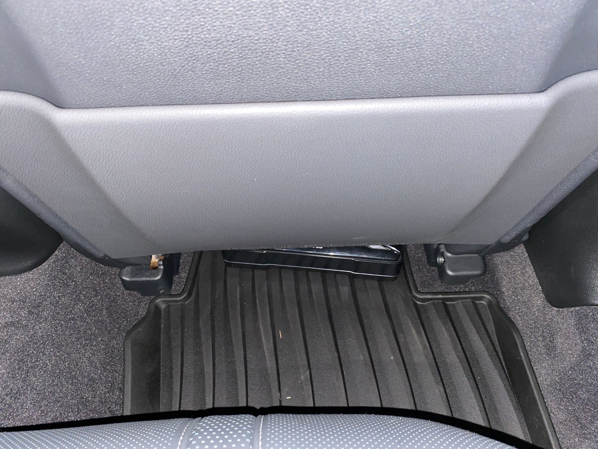

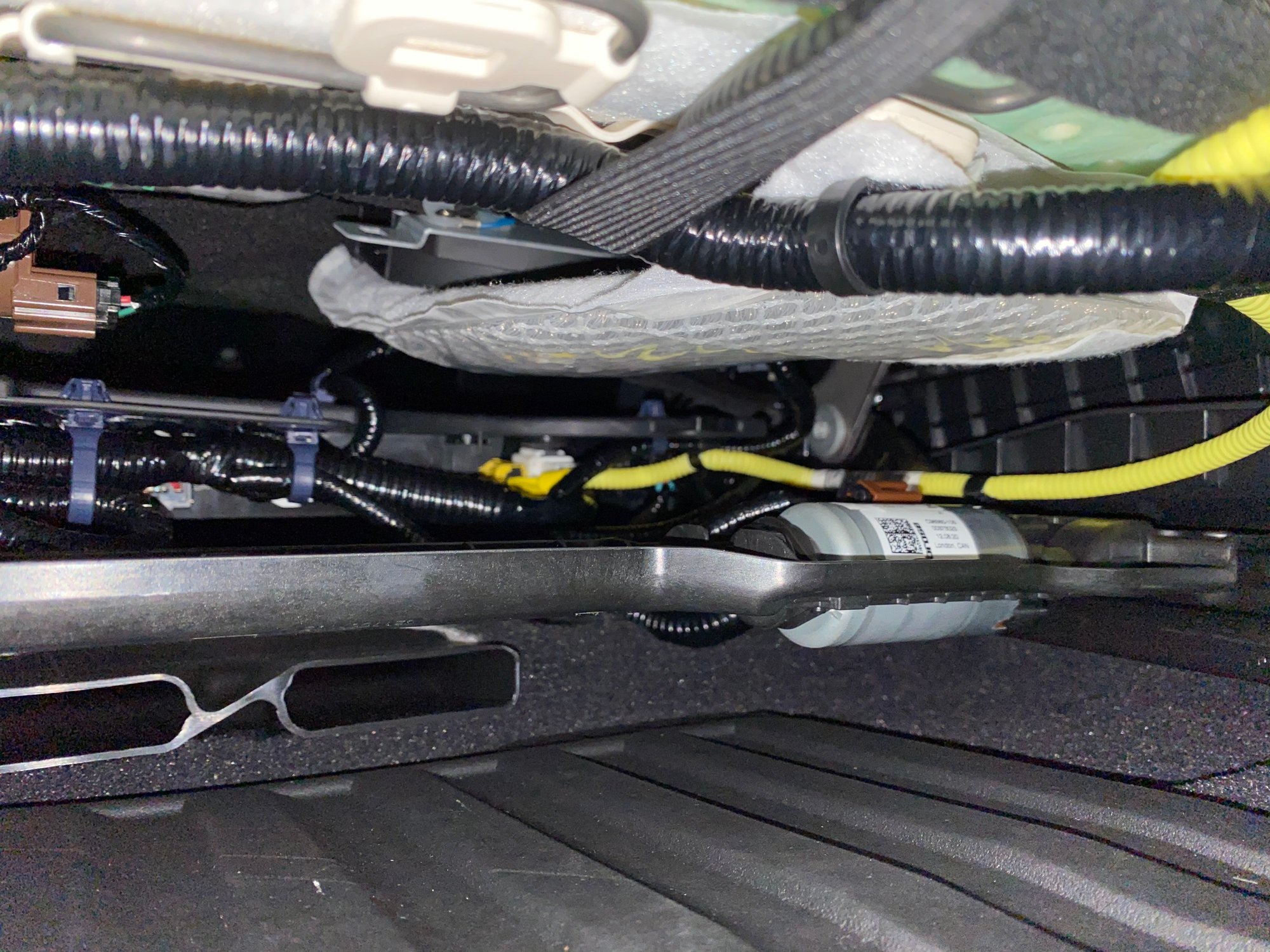

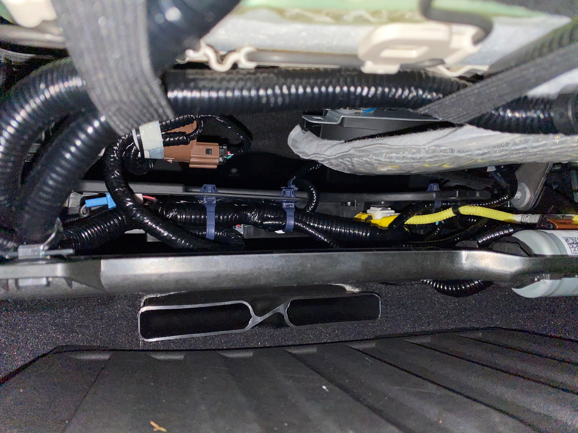

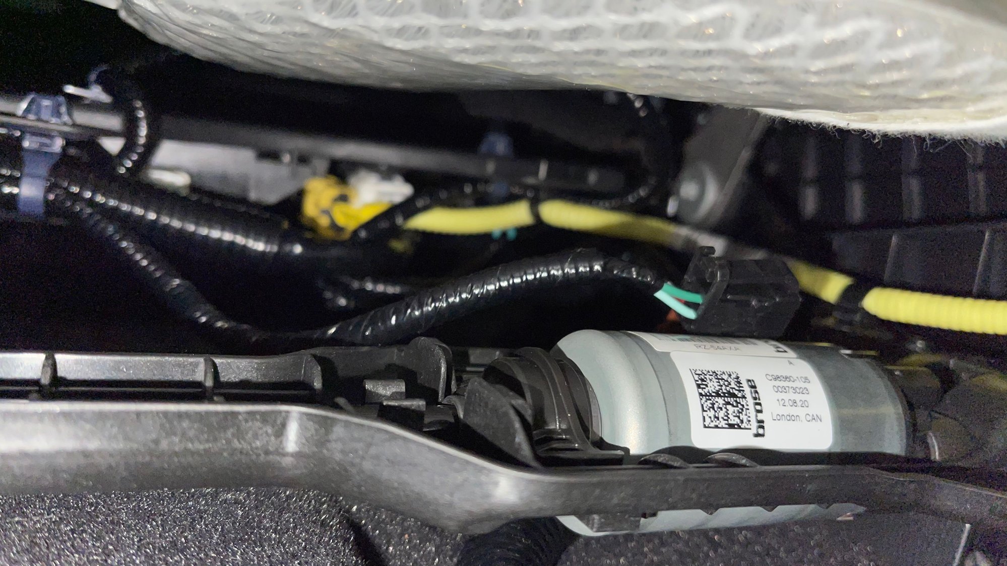

I am trying to install a sub under the passenger seat (TLX Advance pckg) and I came across this. It does have a motor in it. Because of it, the sub(Kenwood KSC-SW11)is sticking out. Do you know what this is for?

the lower motor is for the power seat. Upper one that's flat against seat bottom helps with ventilated seats. The lower 2 tubes are for heat/hot air when you turn the heat on.

Thank you for your quick reply, but I was focus on that bar with the motor. The sub that I am trying to install, goes further under the driver seat.

The passenger seat is all the way to the back and the sub is still sticking out because of that bar with the motor.

Hold the motor and push the seat buttons. When you feel the motor move, you'll know what it's for.

I tried that and it only moves forward or backward with the seat.

when I was pushing down, I did it for little bit and I didn’t feel it move.Today, I went all the way down and the bar did move forward. Now both of my subs are under the seats touching the lower vents. Thanks!

I unplugged it and bottom seat can’t go forward and backward...I won’t be able to remove it.
