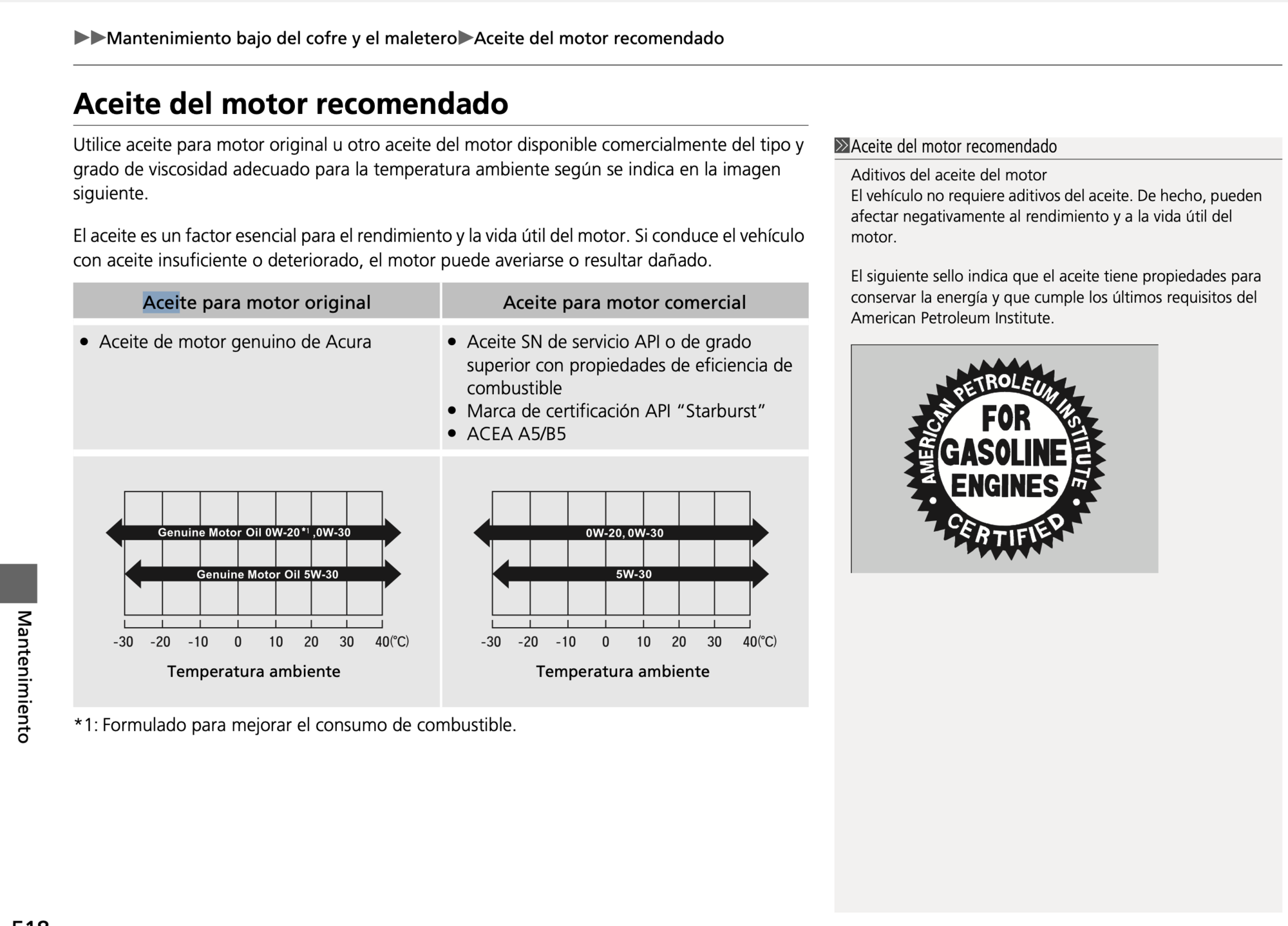

Type S turbo, I hope you change oil every 4-5k miles and bump up viscosity to xw-30, which btw is listed in Mexican owner manual for this car.
almost nothing in mexico is recommended in 0W-20 becuase it is both a less readily available oil down there, and its a hotter climate. OP is from Canada where 0w on start up in winter is an absolute benefit.
There is a lot of truth to the push for 5w-30 when the recommended oil is 0w-20 but it should be very climate sensitive. In canada and the northern states 0w-20 absolutely should be used in the winter months, and it still lubricates well enough that its not an issue year round. In a Mexican market where no where in the entire country will ever reach freezing temps, they can move to 5w-30 no problem and the lower States should likely feel free as well, but if the manufacturers need to select a single oil for the entire country (which they do to limit confusion) you can see why they would select 0w-20 when its never going to be an “issue” for any of the climates in the country.
if anything OP could use 0w-20 in winters and 5w-30 in summers, but realistically in the Canadian climate, probably not going to have any issues just sticking to 0w-20 year round and your doing what the manufacturer recommends so they cant give you any warranty hassels.

Canada maybe, but are you making a claim that places like south Florida or Arizona/Texas are experiencing temperatures that are much colder than mexico? 5w-30 is also allowed in Europe for the same exact engines (maybe not type S because its unique to north america). The only reason they “recommend” thiner oil is because of CAFE.
they do not require, only recommend. Its not the same thing like ATF fluid.
if you are living in cold climate, and worried about cold start, you can use 0w-30 which will have same cold viscosity as 0w-20.

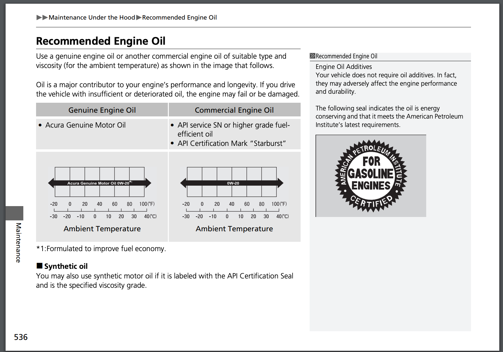

This is right out of the 2023 TLX-S manual. SN Oil or Higher grade fuel efficient oil. Acura does not have a spec like BMW LL-04 or VW 508. Use a good quality 0W-20 and you won't have to worry one bit. If you want to do DIY oil changes, Mobil 1 0W-20 ESP (Green cap) seems to be good. It meets VW 508 specs for their 2.0L turbo engine.

For 2024 Acura TLX Type S owner manual https://www.honda.mx/acura/mantenimiento#manuales
