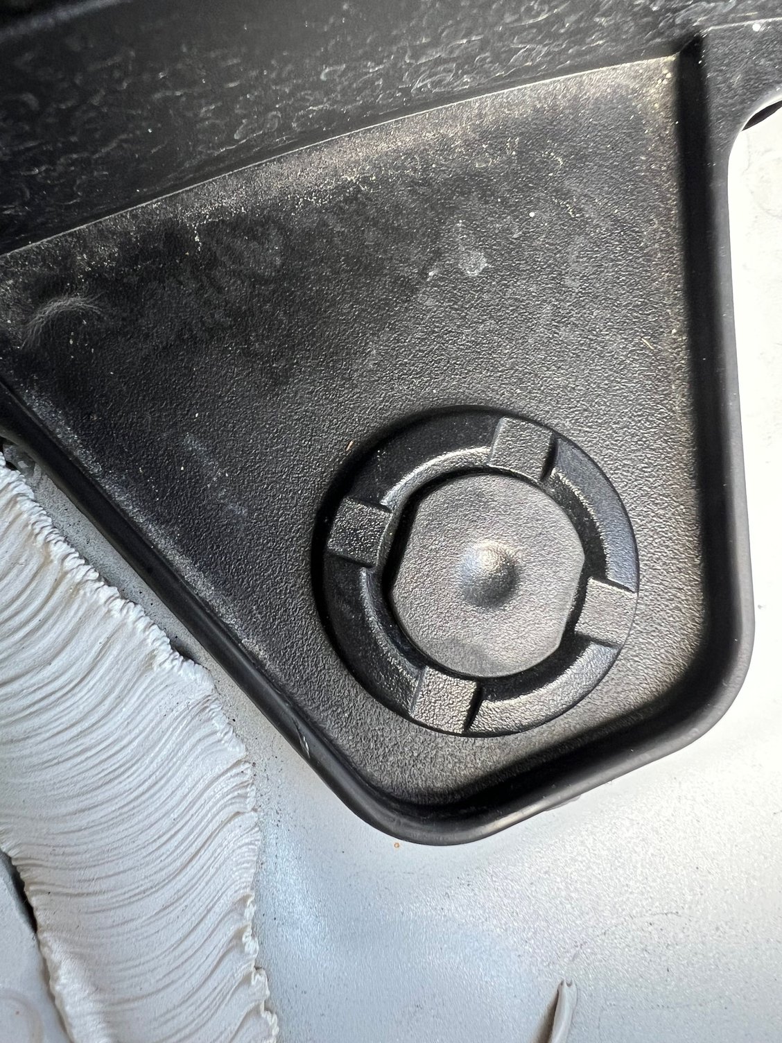

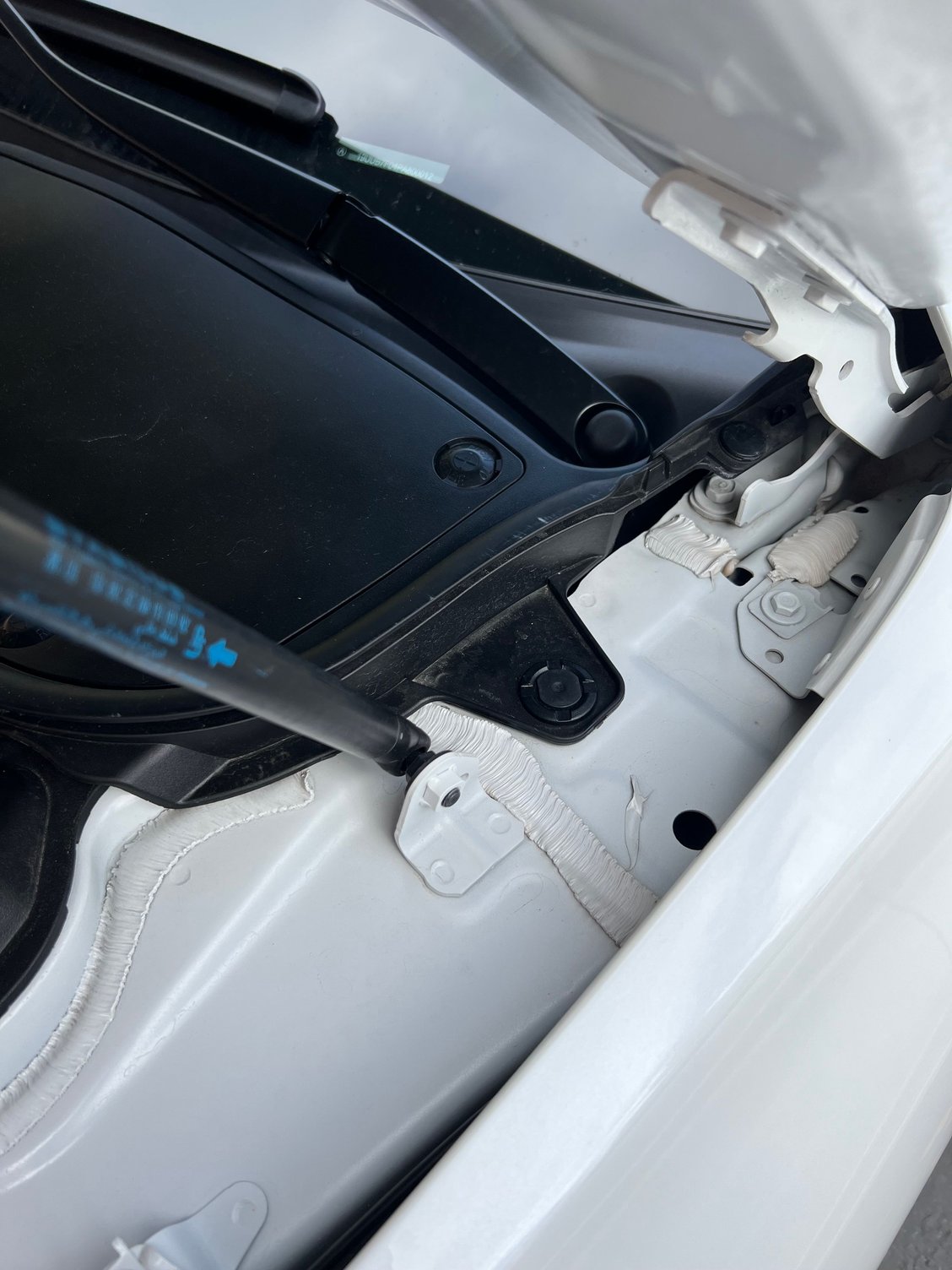

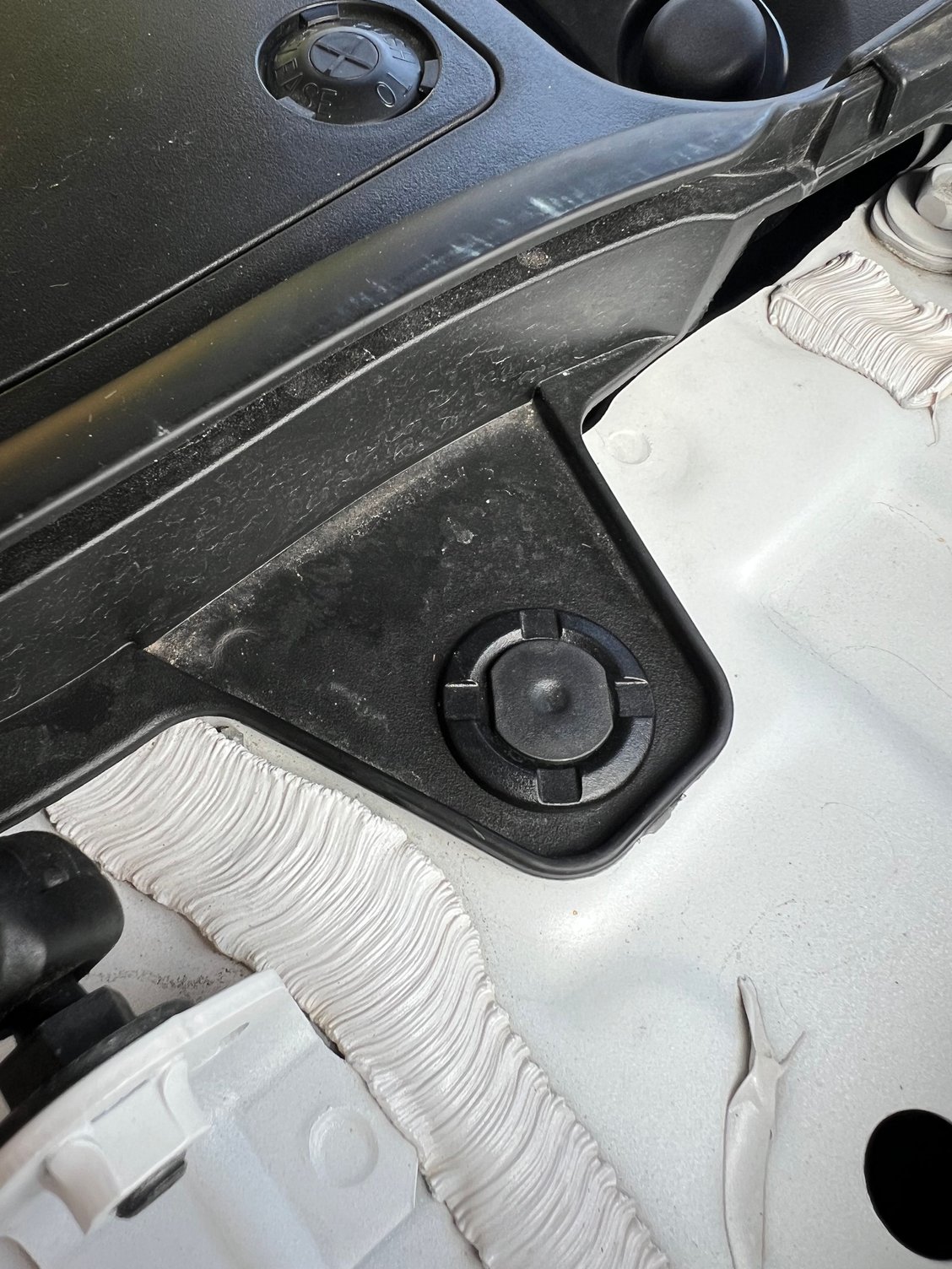

Does anyone know where to find the part number for this clip, 23 Type S.
I could not find it and my dealer couldn't either…

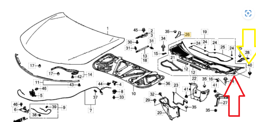

https://acura.oempartsonline.com/v-2...gas/body--cowl
#2?

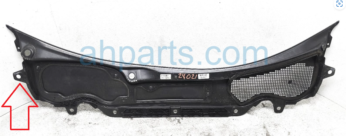

Likes: 2,211
The 'wing' (red arrow), for the lack of a better descriptor, appears to be on the left side of the #19 front cowl top assembly 74200-TGV-A01.
Therefore, the 'clip' that fastens that left front cowl top assembly to its attachment point appears to be #40
Clip, Cover (Lower) ; Under Cover Fastener 91505-TY2-003.
Engine Hood - 2021 Acura TLX 4 Door ADV KA XAT

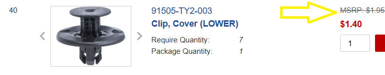

It looks like the indicated below example would work perfect.
Or just do a quick pit-stop into your local Acura / Honda dealer parts counter, with the correct part number, and pick them up for retail $1.95.
