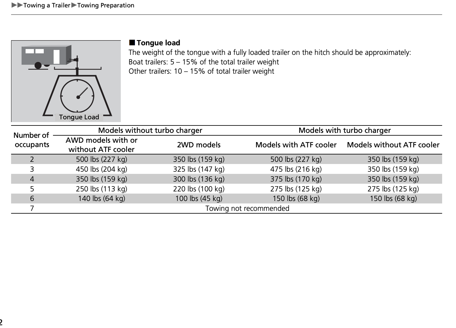

Why is the towing capacity for the Type S the same at 5 and 6 passengers, whether or not it has an oil cooler? How does that make any sense????
