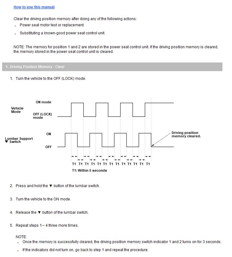

You could also try clearing the memory settings and trying again:
Thank you for your response, not the mirror actuators but the mirror flood lights aren't working, so that might be it...if it is, that would be a bummer as I don't know why it would be related to the seats. lol. i'll give the reset suggestion a try this evening as well!

update: I performed the clearing method above and everything works as it should now! Thank you so much @NTP66 for your suggestion. I didn't even know It could be 'cleared'. You saved me a trip to the dealership. 👍🏽
