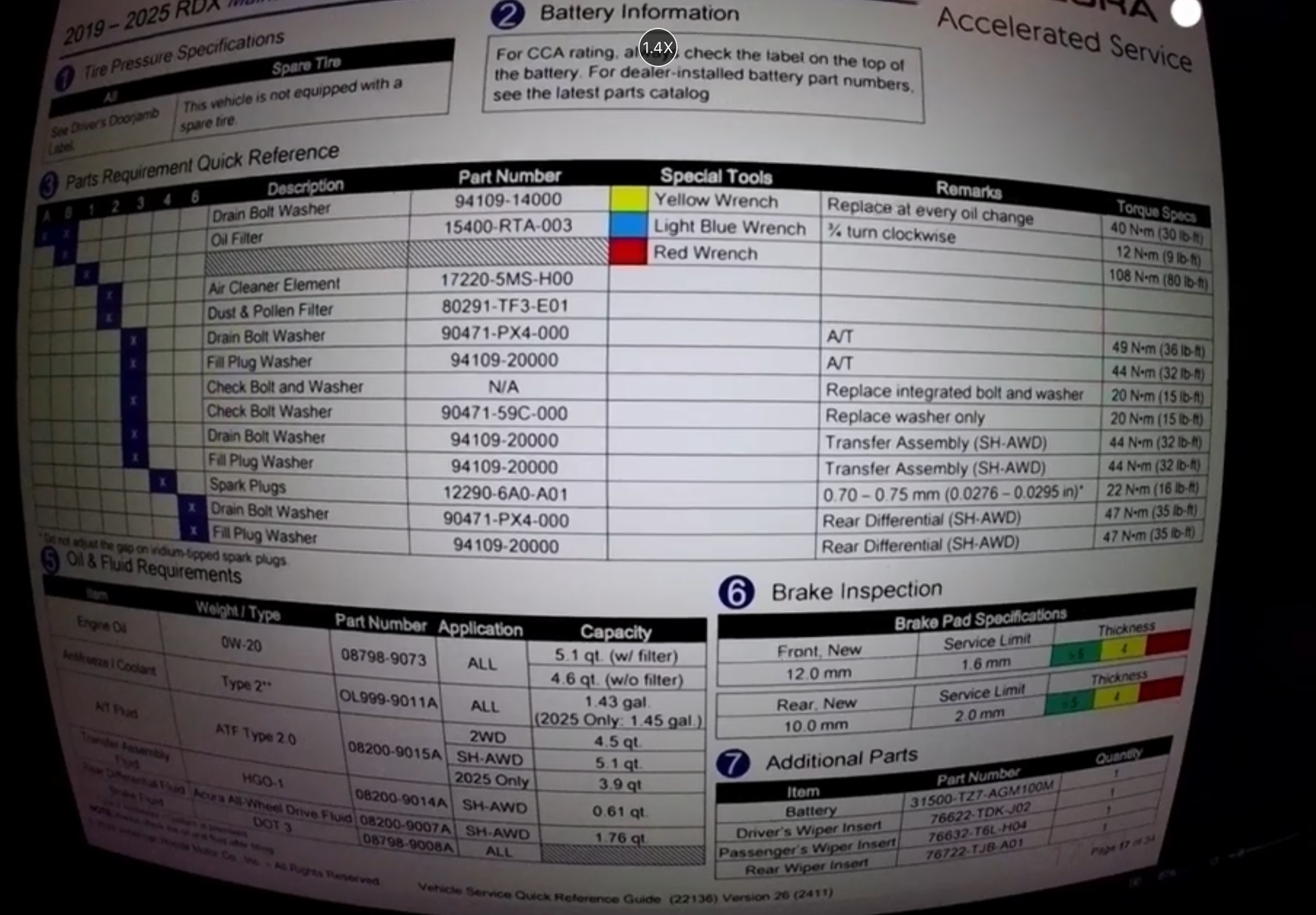

Old Aug 18, 2025 | 05:55 PM

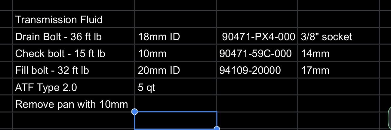

Great procedure! I need to do mine and was wondering - what crush washers to use, please? Thanks.

Posts: 4
Oh, and torque specs for the bolts?

Old Aug 18, 2025 | 07:50 PM
mariog7's Avatar
4th Gear
Joined: Aug 2025
Posts: 4
Good idea, thanks
Old Aug 18, 2025 | 08:27 PM
mariog7's Avatar
4th Gear
Joined: Aug 2025
Posts: 4
Torque specs and crush washer info
This sheet is MONEY! Where did you get this? Everything you need on one page!

Old Aug 21, 2025 | 04:39 PM
Posts: 6,852
Likes: 2,196
Here's an open source website to get similar 'Vehicle Service Quick Reference Guides' for Honda's; however, no joy found for Acura vehicles.
