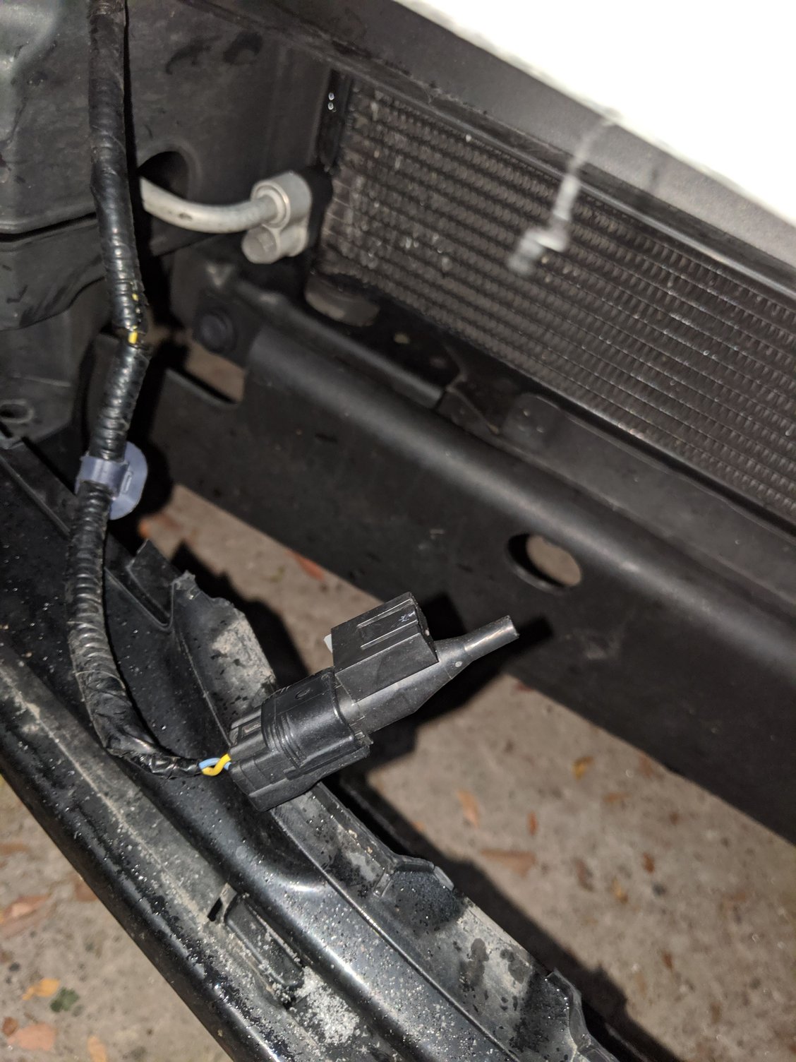

Slid on snow and smooshed the bumper what is this sensor looking thing? Need to know before I replace bumper myself or if I should just go to body shop. Thanks in advance

Is it attached to the bumper? Most likely the parking sensor relay? Could be that or it could be the harness for the fog lights or headlight washer if you have them.

Middle of the front bumper I don't think I have either of those features and both fog lights are working. Forgot to add some info it's 2015 tlx 2.4L tech package. I'm at a loss for what this sensor does

Looks like an air temp sensor to me. I think it's supposed to tuck somewhere up behind the beak.

Spot on found it online after you said that thank you so much!
