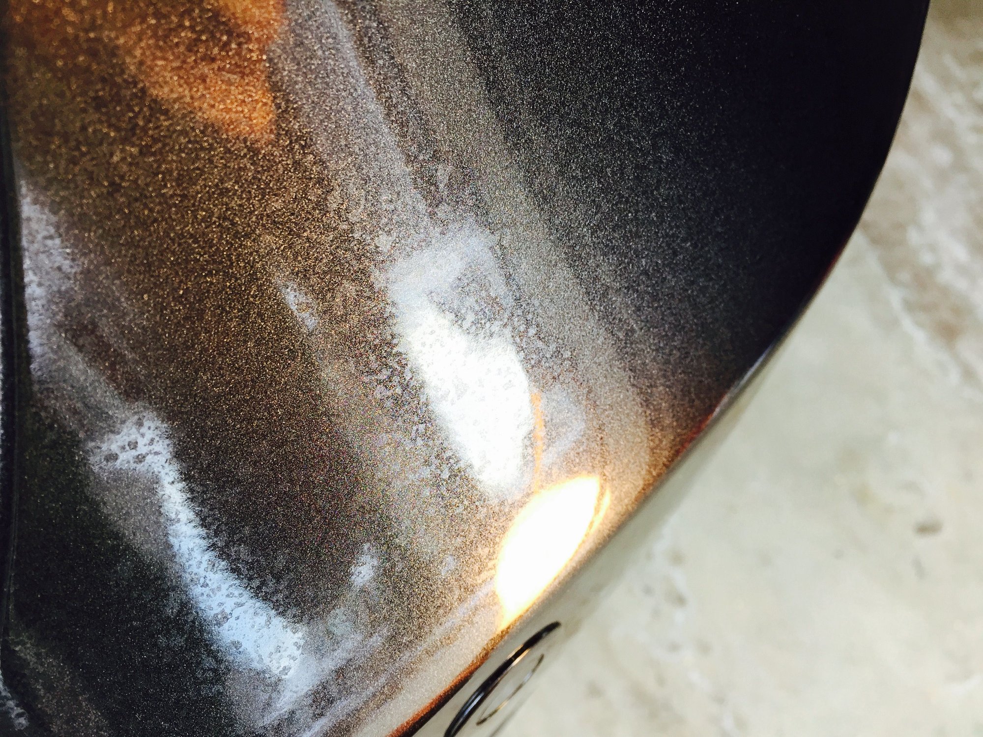

I've had my AWD-Advance TLX for less than a week and yesterday I noticed that the factory paint below the right rear door handle looks like the paint wasn't mixed thoroughly before it was painted at the factory. Hopefully you can see it in the picture below, look very closely just below the rear door handle.
I showed this to the Dealer's General Manager shortly after I discovered it (I happened to be going there for another issue) yesterday and he thought (as expected) I'm better off leaving it as it is because repainting it would leave me with a non-factory finish on that door. The more time went by, the more I didn't like either leaving it as it was or repainting it. With the accessories I purchased, I paid over $50,000 for this car and it's already defective and it's likely going to negatively impact the resale price (if the buyer notices it) when I sell the car.
What I'd like everyone's opinion on is are there any other options that I have available to me? There are about 158 miles on the car at this time. Exchanging the car for another one would be costly for me because I've already had the Paint Protection Film and tinting installed, plus, I'm not even sure that's an option. So please provide me with your thoughts on what options I do have with Acura. Thanks in advance for your assistance.

Unfortunately it's not the door handle that's the issue, it's an area about 1 foot directly below the handle. If you look at the picture closely, you can see what looks like smugs, it's not smugs, it's really the paint that wasn't mixed thoroughly before they painted it. The GM agreed that that's what happened. I don't know if I have any options, I really don't want the door repainted because the repainted area is never as good as the factory finish.
I'm going to talk to the Service Manager and see what options I have when I take the car in Thursday for an unrelated issue.

A proper repair will be nearly invisible - but - there are two things to be concerned about.
1 The picture makes the whole door look a slightly different shade. Are you sure it wasn't already re-painted - in-transit perhaps?
2. If you decide on a respray, then keep documentation of what was painted and why. A respray only affects resale if there was an underlying accident that was repaired. Resprays for door dings, parking lot bumper dings and so forth will not affect resale but you'll need paperwork to prove it. While the respray may be invisible to the eye, many dealers use a paintmeter to check for resprays.
When I last traded my car, the dealer checked for curbed wheels and paintmetered (I just made that word up) each panel. Never popped the hood or anything. BMW had resprayed a panel because of lot damage. The dealer asked me about it and I showed him the work order. He offered far more than other dealers so it clearly had no negative impact on price.

it could be holograms/paint damage that occured during the new car prep. Some dealers like to wax/seal the cars before delivery and an incompetent person with a rotary polisher could have left defects that make the appear seem flawed.
I'd have the area polished out first and see it. If it doesn't help the issue, the best thing is to have the whole door repainted. Spot repairs won't stand the test of time. Don't go to a dealership bodyshop, rush in, rush out.

From that angle, all I see are dealer installed swirls.
Are you sure a detailer, or polishing wouldn't take it out, and it is in fact a paint defect?

No, this is definitely not something the dealer did. It really doesn't show well in the pictures, I've tried to take other pictures and it just isn't as visible through the lens as it is in person. Don't get me wrong, this isn't something that everyone who walks by notices it, you have to be looking for it or catch it in just the right light to see it.
Actually the detailer that tinted the windows and applied the Paint Protection Film is the one that pointed it out to me. It looks like the paint wasn't mixed thoroughly in an area slightly larger than one square foot. Even the GM of the dealership agreed that it looks like the paint wasn't mixed thoroughly in the one area.

I agree, from that angle all I can see is the swirls or what might be a buffer trail ..
And the suns reflection hitting the rear quarter in the general area of the defect (note the suns reflection the rear quarter window) is also not helping, it makes the whole area look much lighter. Not saying there's no defect, just saying I can't see it in that pic.

Thank you everyone for your input and suggestions, I really appreciate it. After living with it and thinking about it for a couple of weeks I've decided to live with it as it is. It's very difficult to see unless you are really looking for it, in normal every-day driving you don't even notice it. I've weighed the risk vs. reward and to me it just isn't worth the potential risk I run of repainting the door panel. The dealer agreed to do whatever was necessary to satisfy me, but I just think I'd rather have the factory finish on it vs. a repainted door panel. I understand that not everyone would go this route, but I've decided to just enjoy to sit back and enjoy the ride.

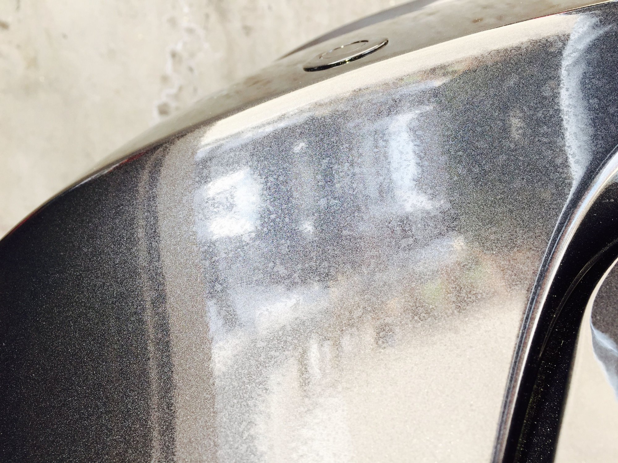

Looks like it is already repainted, that's not really a factory issue. The car is sprayed all at once in even strokes so its not like the factory just decided to paint that little area at one given time.

I had previously reported a couple of paint defects and have been following this thread closely. One thing I just realized is everyone on this thread with a problem seems to have a Graphite Luster Metallic. I have that same color as well and have issues with paint that looks like it may not have been mixed right, a drip in this same area, and recently noticed some areas on the rear plastic bumper, generally above each exhaust pipe, that have what looks somewhat like water spots. I have tried to use various cleaning agents and a clay bar to remove, but nothing is effective. I'd note this last issue is only present on the plastic. The metal areas above and to either side do not show these same contaminants or defects.
Wonder if there's any issue related to early builds of Graphite Luster Metallic? Mine is a 39XX build.
