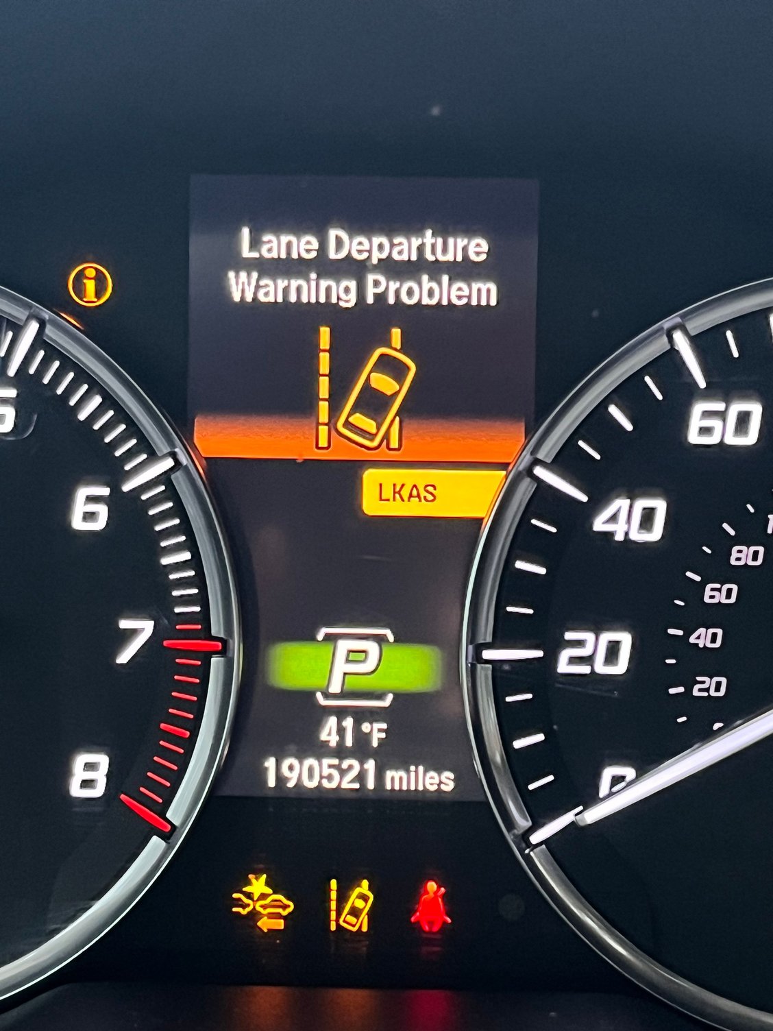

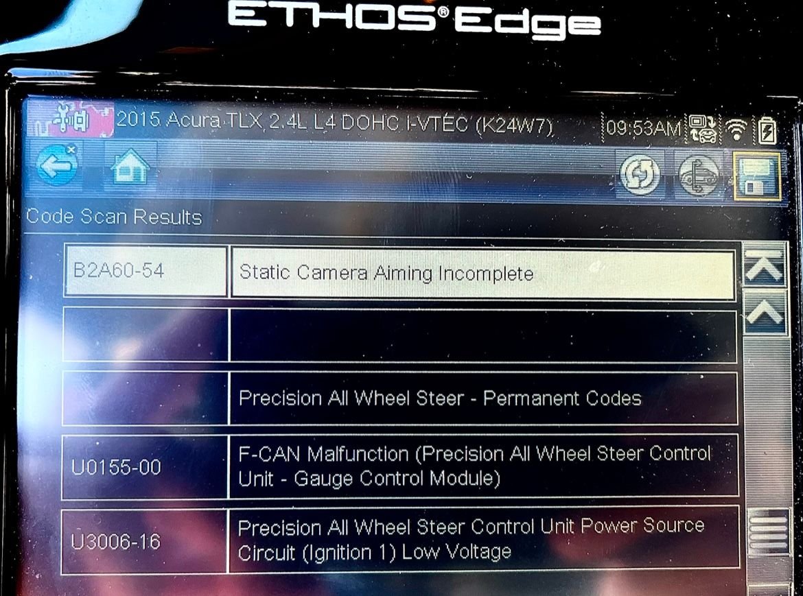

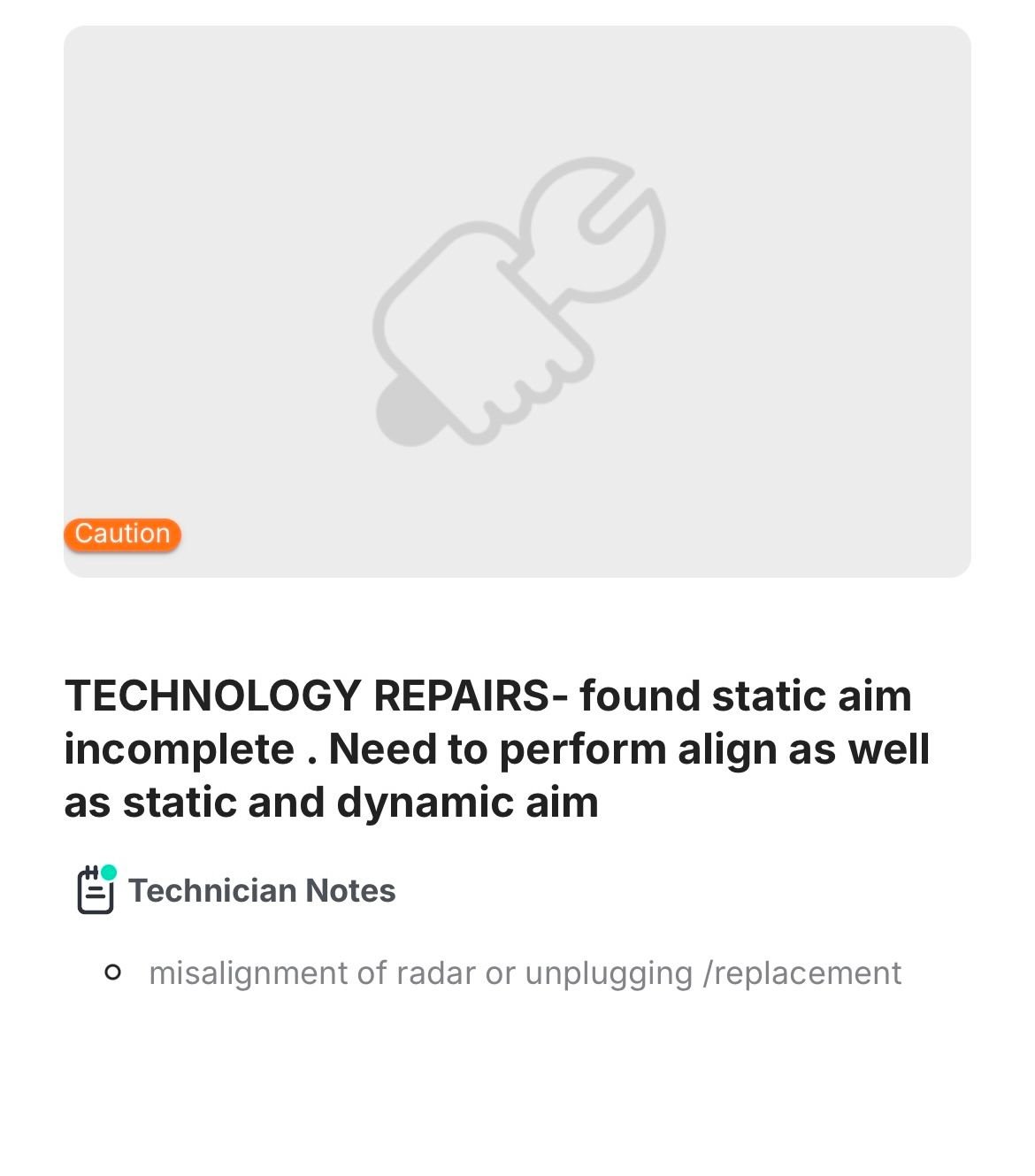

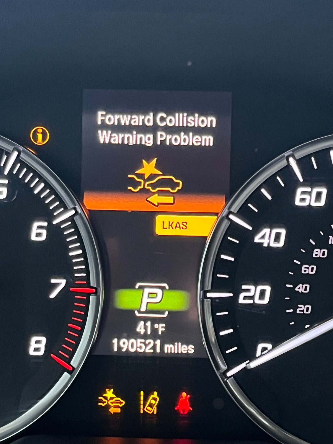

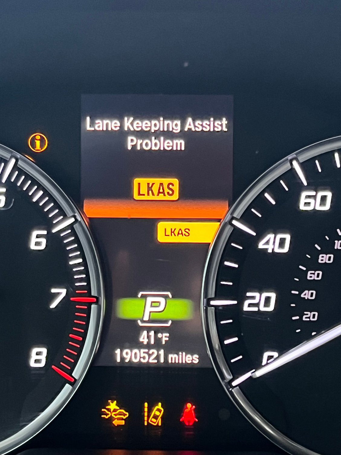

I had an oil pump and timing chain job done 4 months ago on my 2015 TLX and ever since then my LKAS, Crash sensor, and Lane departure lights are on the dash. Everytime I try to activate lane departure its says incomplete. The notable shop that did the job spent weeks trying to figure it out but couldn’t (they refunded me for the timing) I took it to the dealer several times and they can’t resolve it neither. I tried many things like buying new battery, changing fuses, unplugging the windshield camera and cleaning it. Everything worked fine up until the oil pump and timing chain job I just bought the car 6 months ago. Dealer said the windshield camera needed to be recalibrated they tried several times but some reason that didn’t work. The car drives fine but having 3 bright yellow lights on my dash is annoying af. These are the 3 codes they gave me B2A60-54, U0155-00, U3006-16

I’ve read every thread possible and still not resolved. I recently bought my first Acura 2015 TLX it was in good condition just needed an oil pump replacement . I had the oil pump and timing chain job done 4 months ago on my and ever since then my LKAS, Crash sensor, and Lane departure lights are on the dash. It had no codes prior. Everytime I try to activate lane departure its says incomplete. The notable shop that did the job spent weeks trying to figure it out but couldn’t (they refunded me for the timing) I took it to the dealer several times and they can’t resolve it neither. I tried many things like buying new battery, changing fuses, unplugging the windshield camera and cleaning it. Everything worked fine up until the oil pump and timing chain job I just bought the car 6 months ago. Dealer said the windshield camera needed to be recalibrated they tried several times but some reason that didn’t work. The car drives fine but having 3 bright yellow lights on my dash is annoying af. These are the 3 codes they gave me B2A60-54, U0155-00, U3006-16
