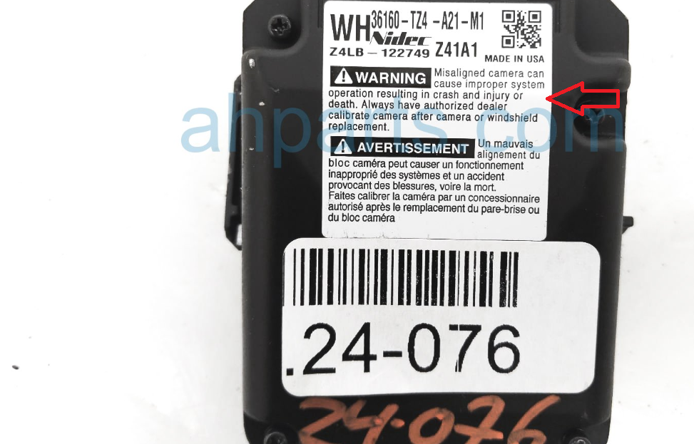

Not sure what your TLX's trim level is; however, is the #1 camera (2020 TLX Base) below the one you referred to in post #7?
As thoiboi mentioned, perhaps a re-calibration is needed?
